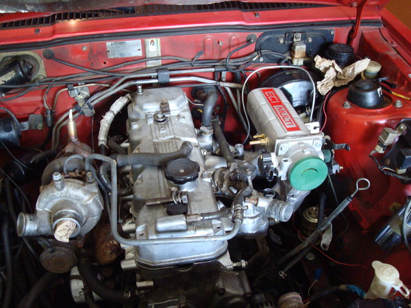

So, here it goes, I will start with pictures I took when I first got back from China this summer, and I am still working on it, but now I am beginning to wire it up so it should run sometime soon.

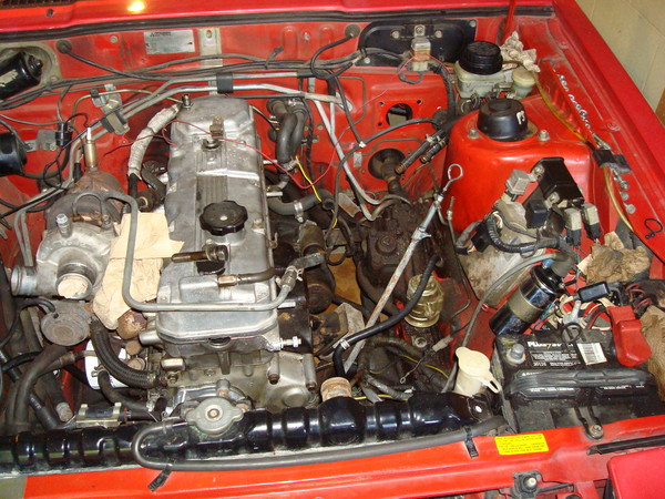

Here after almost 2 months of sitting (hood wasn't open).
Here's how it looked when I left for China:

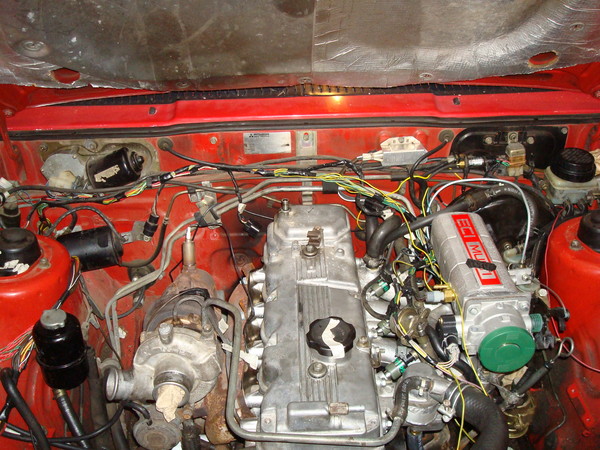

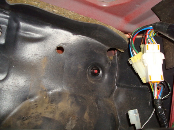

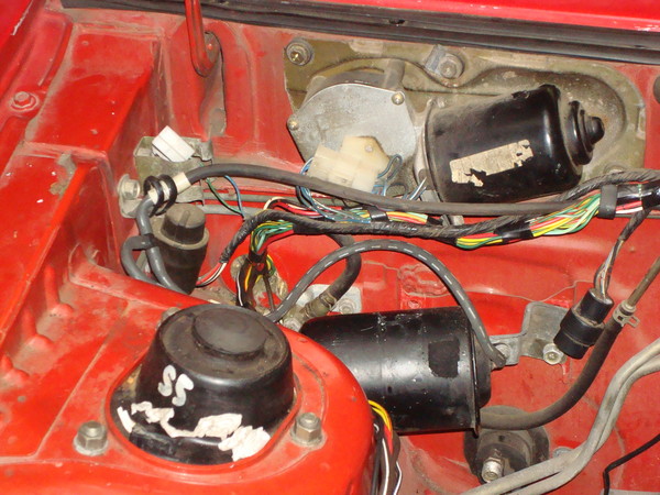

Here is where the stock engine harness came through from inside:

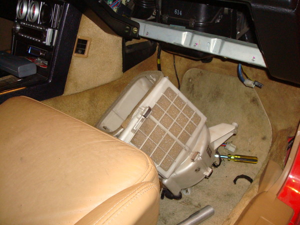

I had to remove the blower motor to get the harness out. That was annoying.
Just to the left of the white plugs is where it came into the cabin.

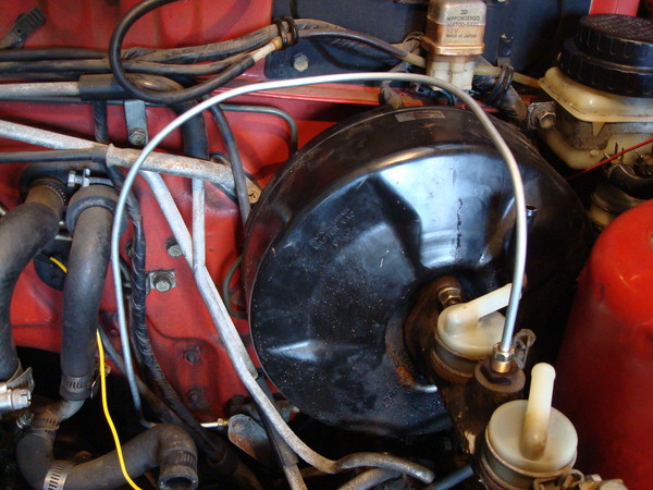

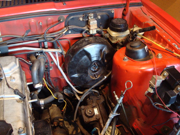

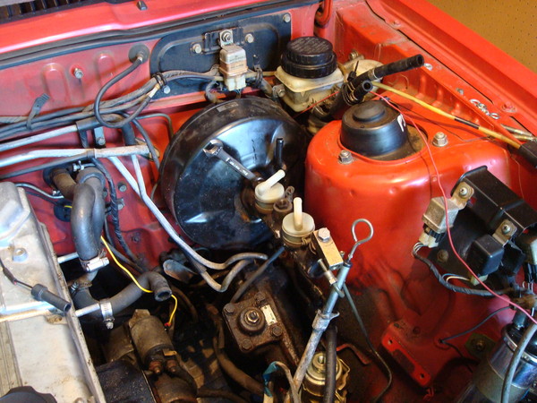

Getting things back together, starting with the brake booster. I had taken it off because the brake fluid was dissapearing, and I thought it might be flowing into the booster and filling it. I was wrong.
Here's the master cylinder attatched and you can see every mitsu owner's favorite wrench - the 12mm open end/box end.
Here is my new ABS elimination line. I bought it and it does screw in, but I need to get new metric threaded ends and get a flaring tool and do it the right way because the joints leak a bit. Oh, and the soft lines from the reservoir leaked also and that's where it was leaking before, I am pretty sure.

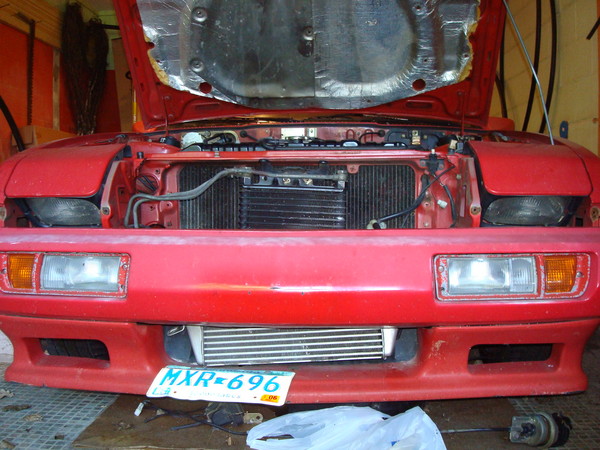

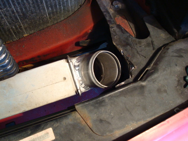

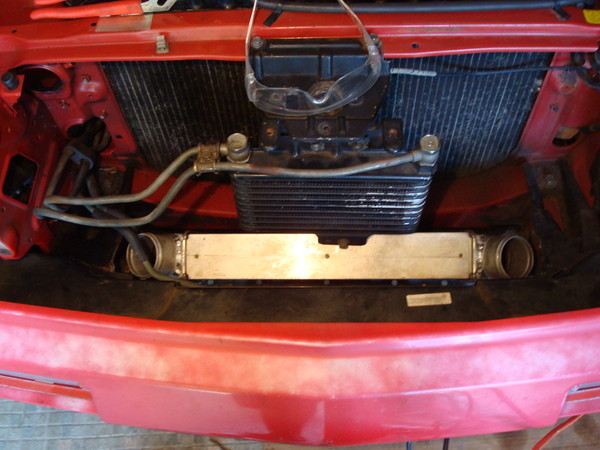

Got my endtanks modified to have 2.5" stubby ends instead of the 1.9" long tubes that were stock. But I didn't think enough to tell him to make them go straight up and down, his welding is top notch, but I had to cut the bumper support to be able to attatch tubes:
There it is. Remember, safety first - see the goggles?

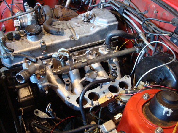

Here's a test fit of the new manifold:

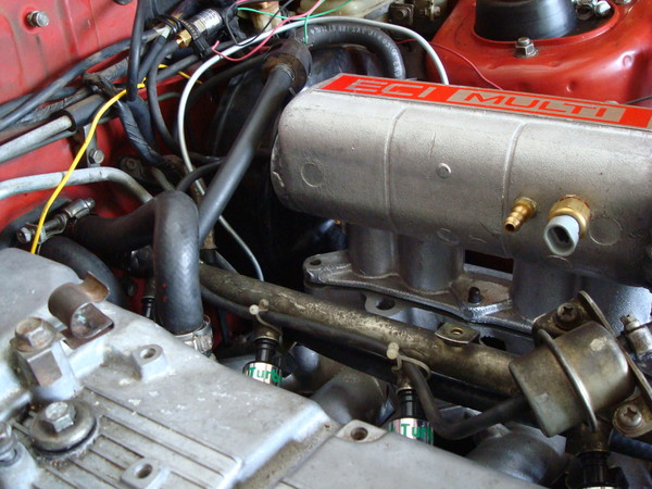

The fuel rail is made for FWD cars, not RWD, and there are little clearance issues, but with some ingenuity and a little money, I was able to avoid any major problems:

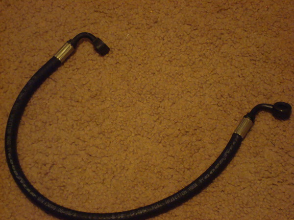

Remember that ingenuity and money thing? Here's my new fuel line. one part USDM, one part AUDM and one part nice dude at a custom hose shop =

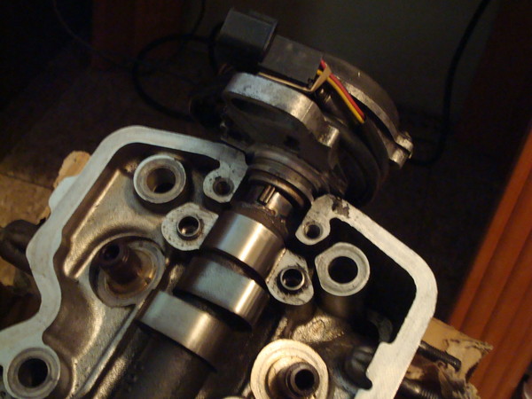

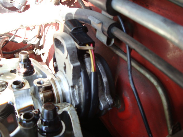

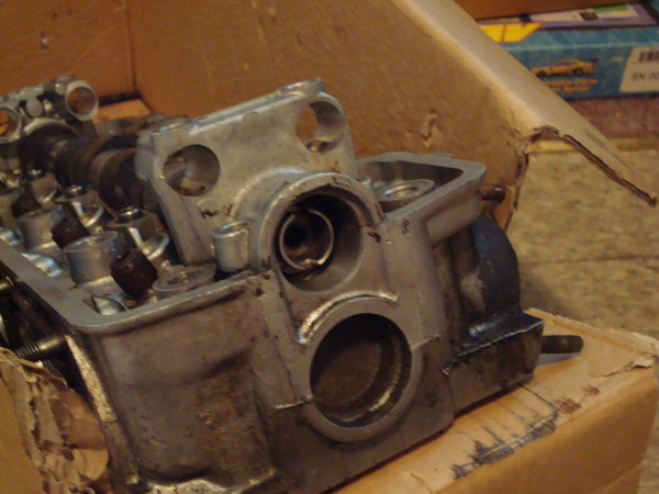

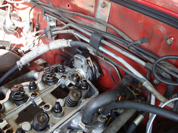

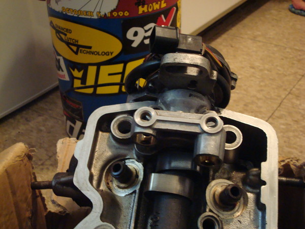

You guys might recognize this quickly, it's a '90 CAS I got machined to fit in my head by a gunsmith who used to race boats and he does testing for big gun companies. 5 bucks. Nice guy.

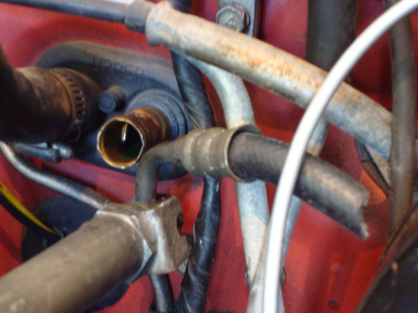

Water neck installed, and fuel lines figured out.

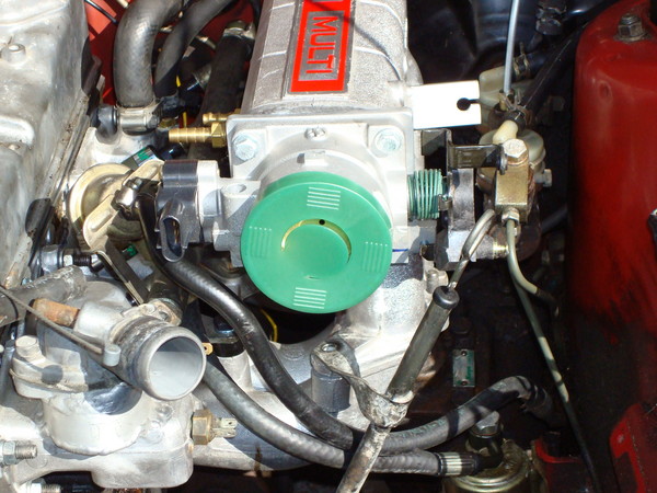

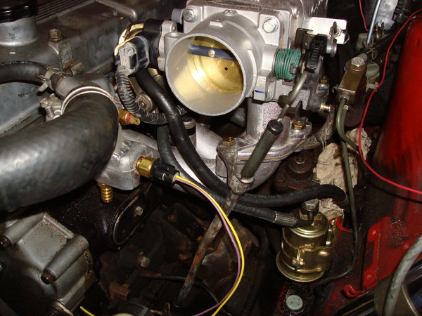

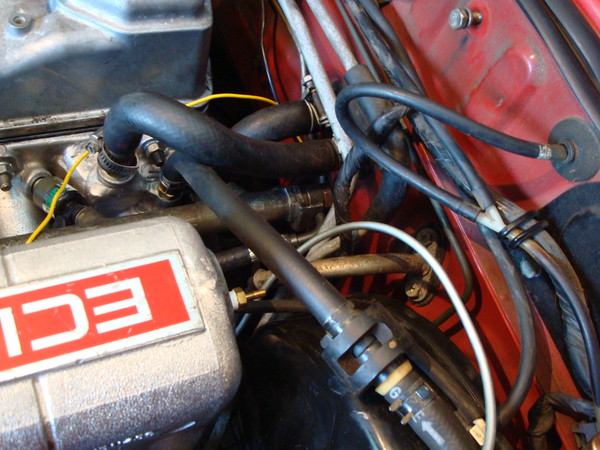

Throttle cable figured out. It's held in place by a ziptie, I know this.
It's tight in there, hard to get that last injector plug on. Questers will notice that I rotated the throttle cable bend downward so the cable would be going in the right direction for the new TB location. I also switched the heater core hoses, people on SQC told me it might mess up the heater or how it works. But I won't be driving it when it's to cold, and when it's warm, I'll have the windows open. It always blew a little hot air at my feet anyway.

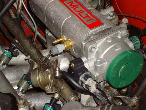

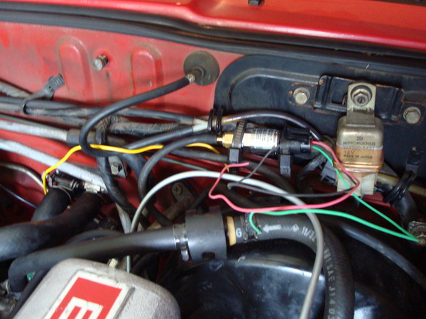

Little AEM 5 bar map sensor action. Thanks DB performance!
Got the fuel rail and vacuum lines setup. That's right my injectors say turbo on them.

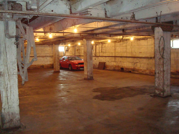

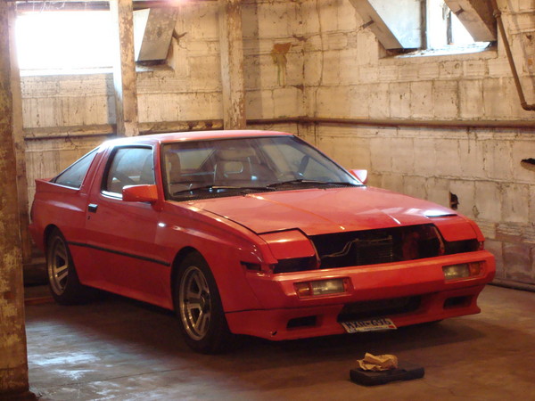

The morning after delivery to the warehouse that it now lives in (the basement). My grandparents didn't like it sitting in their valuable empty garage space, so it had to move. Can't blame them I suppose, I'm just flesh and blood.
It's so lonely down here.

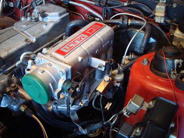

I got the upper intake stuck on there with some RTV now, I figure it doesn't really need bolts. I got the pigtails for those two sensors in the picture at a junkyard. 5 bucks each. Kindof a ripoff, but it was worth it, if not for just the sensors, the fun of tromping through a junkyard looking for parts. I also found out that later model lincoln mark 8's are fwd. Silly ford.

Little blurry here, but the welding is excellent. Shane Laske in Moorhead if anyone is ever in the arear and needs some great welding. He did my intercooler above too.
Here is what the cam angle sensor sees before the lights go out. What with it's one eye and all.

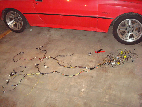

Well, I got some more done in the last couple days, this is the clean stuff, just wiring, soldering, heat shrinking, electrical taping and fitting. Kinda fun, and once you know where everything goes on the harness, wiring becomes much less scary!

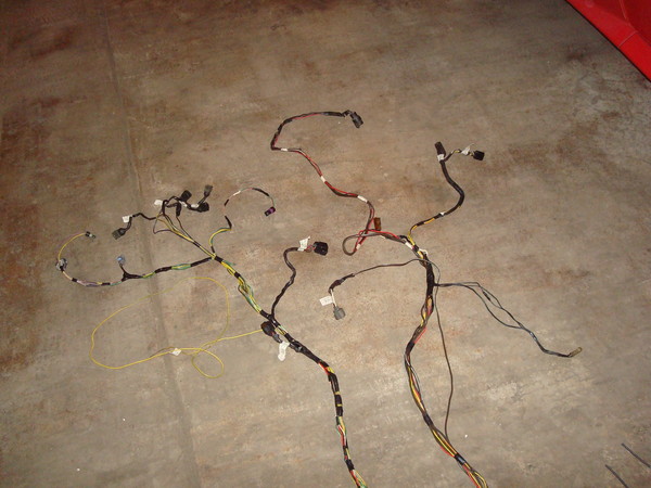

Here's what's left of a '90 harness for the engine bay side.
Not much here either, except the other end looks like a rats nest still. Mitsu couldn't put the wires in some kind of order, could they? Noooo.. but it's ok.

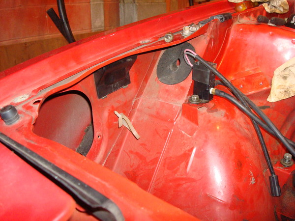

Yarr! Thar she blows! Well, that's it with the wires through the firewall. Amazing that it had the length.
passenger and exhaust side: coil pack, transistor and noise filter, o2 sensor, knock sensor, and that's about it.
Good thing my harness only has long length, and not girth, otherwise it wouldn't have fit through that hole.

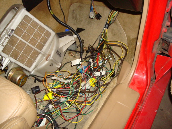

Passenger footwell. Enough length to put the new ecu where the stock one was and try to hid all the naughty bits (as my former boss used to say).
Next I'll be working on splicing wires for fuel pump, tach, power, switched power, etc. there's probably a good 10 wires to finish up then I can plug'n'play just like if I had an eclipse or something not as cool as a conquest.
