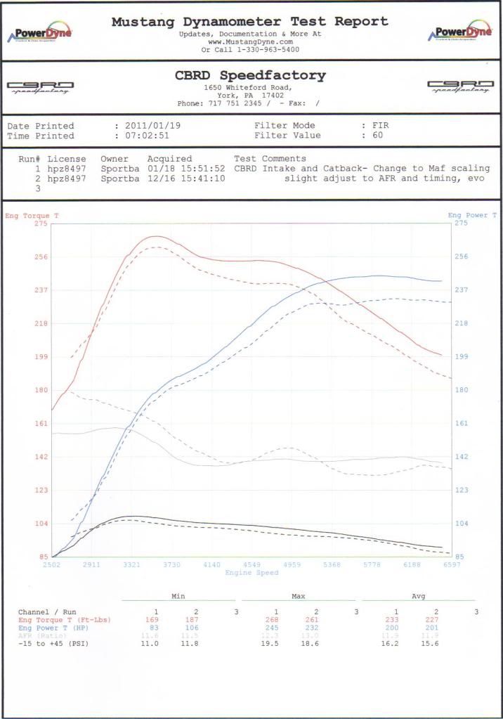

First off, maxing out the stock turbo. Chad has shown 249whp/279wtq with their parts on pump gas, which is pretty respectable and testement to some of the parts he's chosen. They're making a ralliart-specific FMIC because apparently the bumper cover is a tish smaller than the standard evoX. Sounds like they're using the garret 3.8" core that I've grown to love from the evo8/9.
Stock turbo stuff:
http://forums.evolutionm.net/9001430-post51.html
Originally Posted by CBRD
CBRD EVO X Fmic
CBRD RA specific 3" Short ram Bell mouth intake
CBRD Custom Catback exhaust with 3" piping, Vband, and Quad Tips, resonator and muffler
CBRD Resonated Test pipe
Razorlab basemap, retuned by CBRD, with SST tweaks by Razorlab and Jon Drenas,.
STOCK IC pipes, Stock Inlet tube, Stock boost solenoid and pill, Stock manifold, turbo, downpipe, etc...
The highest uncorrected (non smoothed) numbers were 249whp/279 wtq at 19.5 psi...
