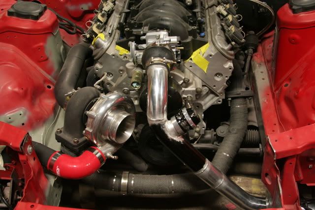

Looks like fun! How exactly does the exhaust go? Looks like it goes to the back then links up and comes back up front to the turbo?

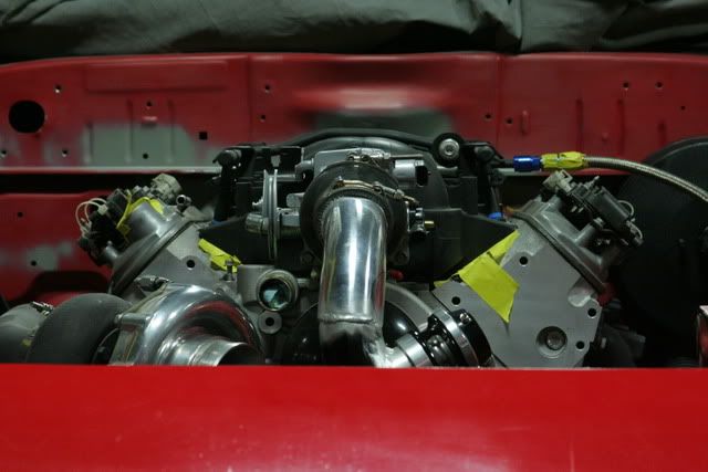

Which LS motor is that?
Cubes?
Cam specs?
Iron or Aluminum block?
Turbo specs?
MOAR details!
Don't find many single turbo LS setups, hope it doesn't sound like a Subaru with the unequal length exhaust lol.

Open downpipe

5.3L L33 (all aluminum), 9.9:1 CR, LS6 cam (204/218), Turbonetics TC76 (.96A/R, journal bearing, 65mm turbine wheel).
It's a completely stock, untouched 50k mile bottom end with ARP head bolts, LS9 head gaskets, Patriot Gold dual valve springs and an LS6 intake.
And thanks... I'm not sure what it's going to sound like but even with the open downpipe it's probably still going to be pretty quiet.
