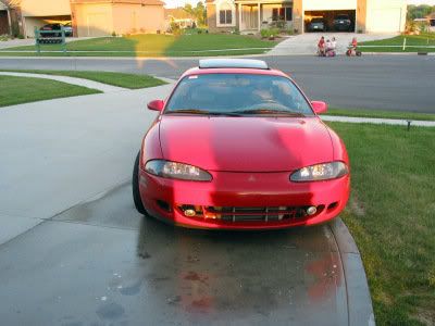

This is my on going project of a GSX that got in the hands of a rich kid ricer that didn't know how to take care of a car to save his life.
Before I picked it up.

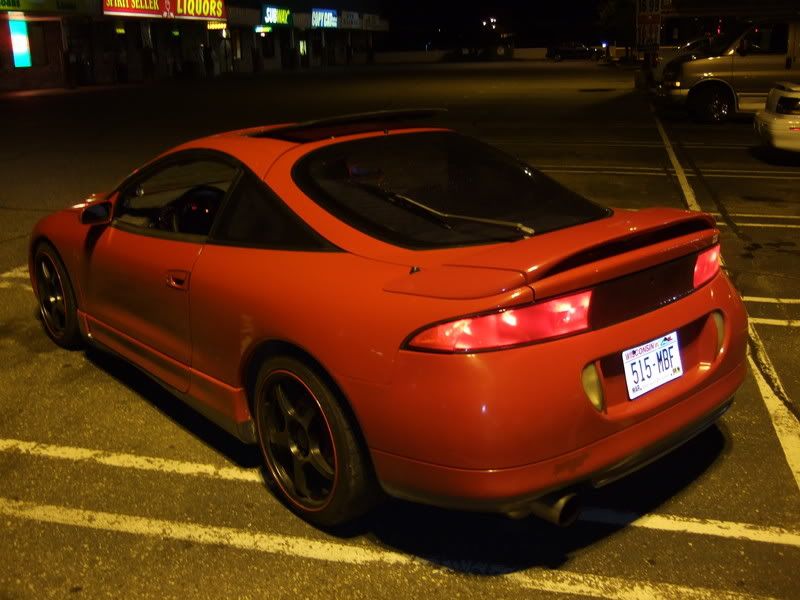

After new wheels and tires and dericering the exterior.

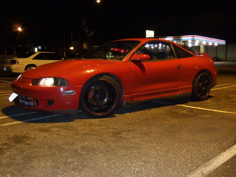

And some semi-recent night shots...Not the best, but it looks alright.
Alright that pretty much shows where it is at this point.
Winter has a lot in store for this car. Carbon hood and maybe hatch are soon to be ordered, debating the hatch still. After that, it goes in for paint. Won't be red anymore. Still going back and forth on a couple of colors. Got it home and the old t25 that was on it was about dead so I put on a small 16g for now. It has a 6 bolt out of a Japanese Galant VR4 RS so that is all taken care of until I build an engine for it. The kid I bought it from was running around with the SSQV vented to the atmosphere so that is fixed. And also was running a walbro 255 with no FPR so I get to do that this weekend. The old tint needs to come off and get retinted. After that comes a 2.3L from FFWD and a head to match. Still debating what turbo. I have some time to think that one over though. Anyway, enjoy. I'll update pics as I can.
