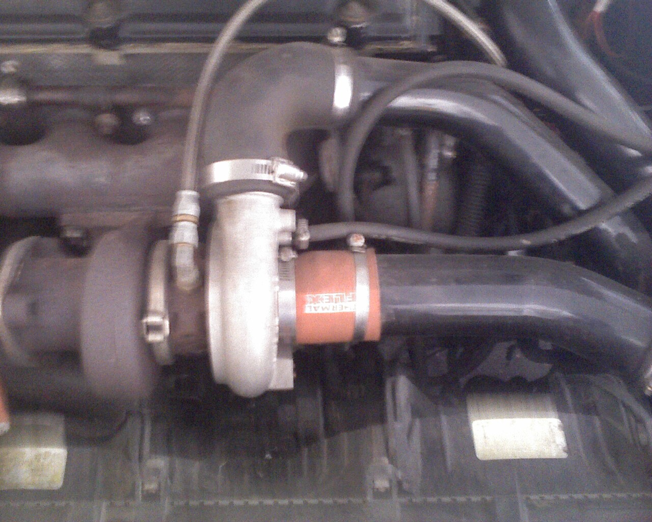

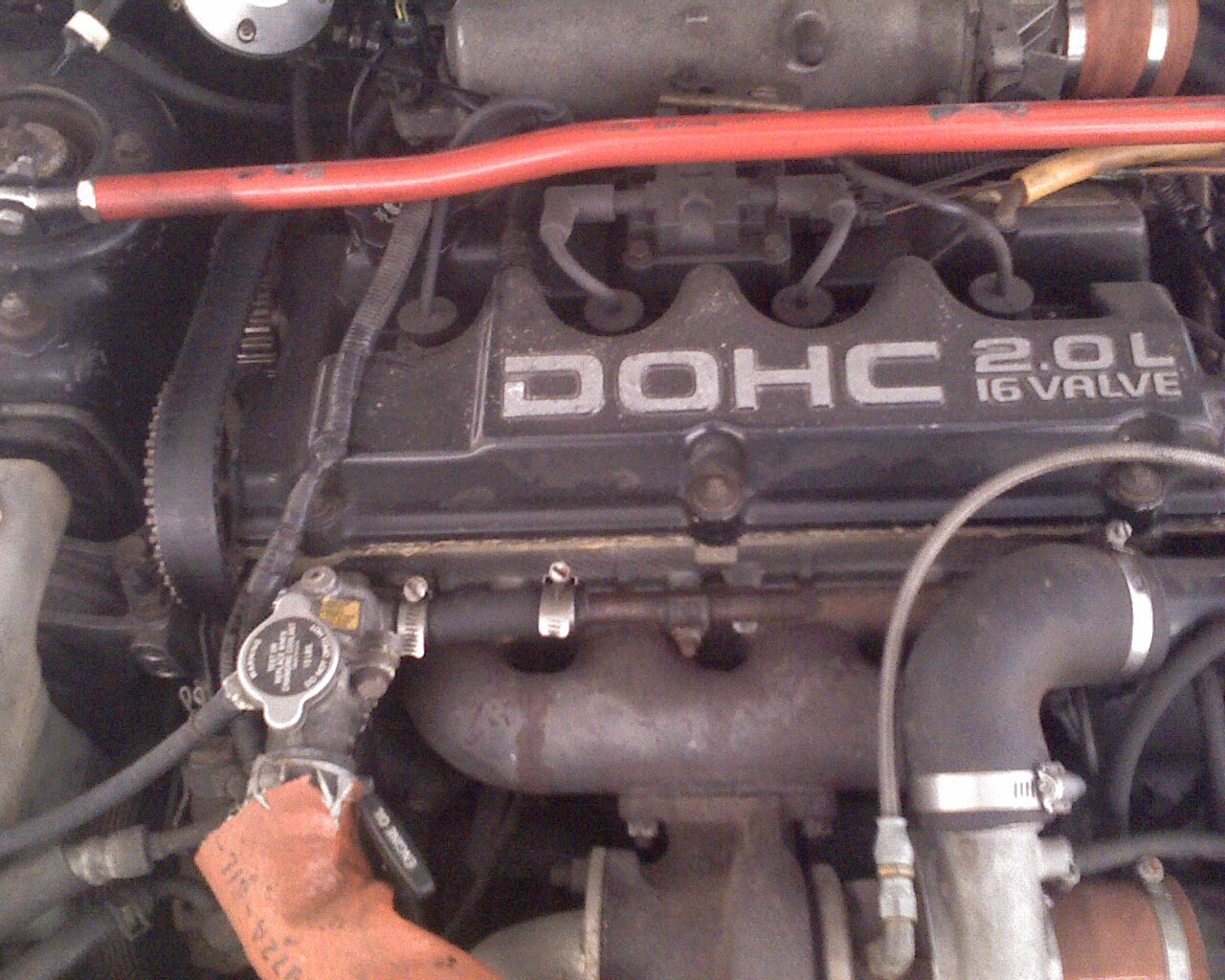

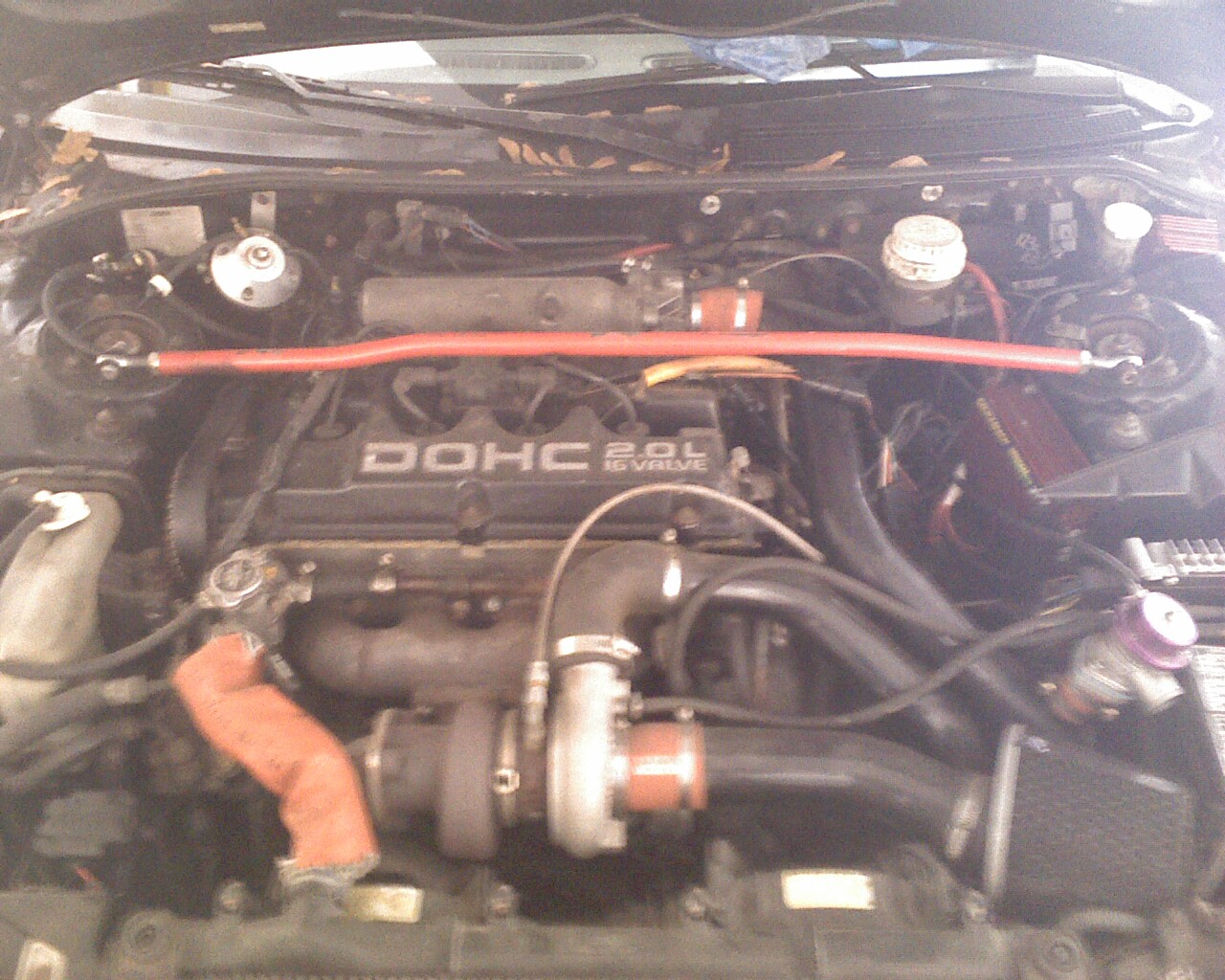

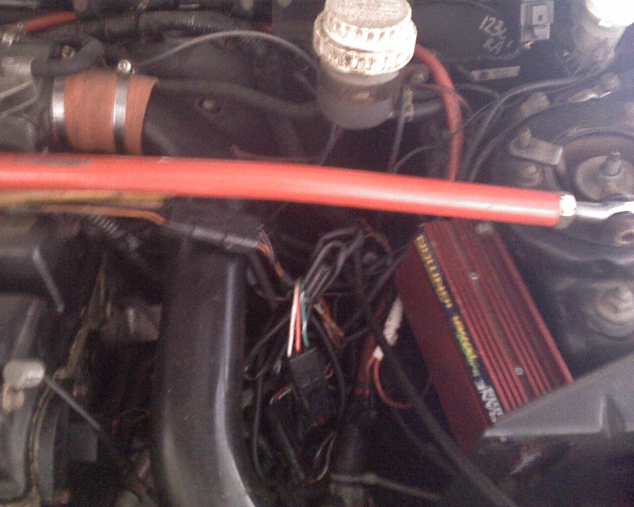

ID:	9554   Click image for larger version
ID:	9555   Click image for larger version
Twenty8 is offline   Reply With Quote

If your Eclipse is a GS, then that isn't a swap, that's the engine it came with. It has (what looks to be) a Hahn turbo kit on it. Other than the wiring being a complete fucking mess, that car shouldn't need any kind of engine swap at all, not sure what the mechanic was thinking...
Also, clarify a bit more what the mechanic was talking about when he said the "turbo wasn't housed right"
I would STRONGLY reccomend bringing this car to one of the site vendor shops (DB, MAP) and have a mechanic that knows what they are doing take a look at it.

looks to me like a turbo'd 420a engine typically found in the 2nd gen dsm's.
i believe the same motor from a neon is actually sohc, and mounted backwards. as well as a few other differences.
the 420a out of an avenger or sebring would be the same from my understanding.
im guessing that the car is did not have an engine "swap", but had the engine replaced. and a turbo kit added

Damn you guys are good. This is exactly what im looking for. So what your saying is the engine shouldnt be a problem just from first glance? and i want to do work myself but i dont wanna screw anything permanently. I can do the basics i.e. change oil, and tires. If i just get the coilovers replaced i should be good? I understand you need to look at it but i just kind of want just a little something. Also the wires i want to get cleaned up and shit and maybe someone could help me with that. They are attached to 2 cams which i have no clue what they are for.
