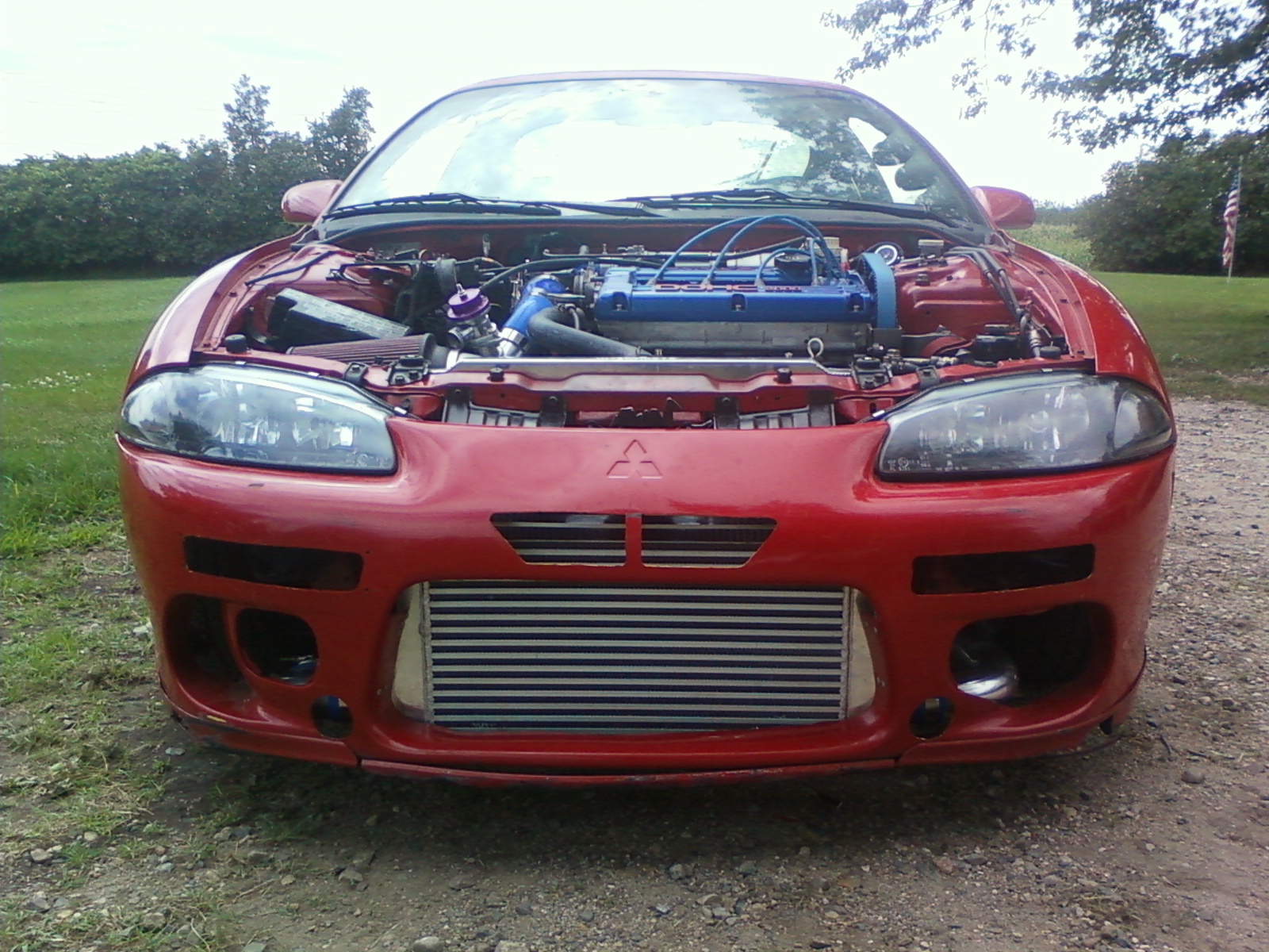

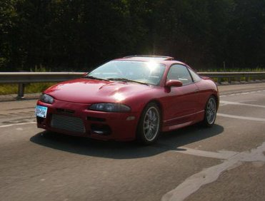

Wussup guys,
I picked up my eclipse a year ago from a guy in Monticello that couldn't figure out the oil leak. I traded my 99 Durango for it and just recently finished my build!!! It consisted of:
SBR G50*Compact Aeromotive FPR w/ marshall gauge*CX Racing FMIC kit*91-94 N/T TB*Megan racing downpipe w/ cat delete*megan racing catback exhaust*SBR SS Cast Blem Manifold*Mishimoto Dual core Radiator*2 12" Electric fans*FP intake pipe w/ 9" K&N filter
Engine Management:
DSMLink V3*AEM UEGO wideband*Greddy Profec B-spec 2 boost controller*Autometer Pro-comp Ultra Light vacuum/boost gauge* Pro-comp Ultra Light Water Temp. gauge*Pro-comp Ultra Light Oil Pressure gauge
Engine Internals:
6 Bolt block*bored .20 over*Cometic HG*1G rods w/ EVO 9 pistons*Gates Racing Timing Belt*BSE kit*ARP rod bolts*ARP head studs*ARP main bolts*1G head*Port and Polished*BC springs and retainers*Supertech SS 1mm oversize nitrate covered valves*274 Delta regrind cams*Fidanza Adj. cam gears*3g lifters
Drivetrain Modifications:
Fidanza Aluminum Flywheel*South Bend Clutch kit
Suspension Modifications:
Tokico Blue Shocks*Lowering Springs*18" American Racing Rims
But I recently sold my G50 and bought a Borg s259 ETT w/ and .84AR housing. I am going to buy a tubular manifold and WG for it this winter, along with A TRE stage 3 transmission. Im pretty pumped about it and I'm hoping to hit the low 11's next year!!!
