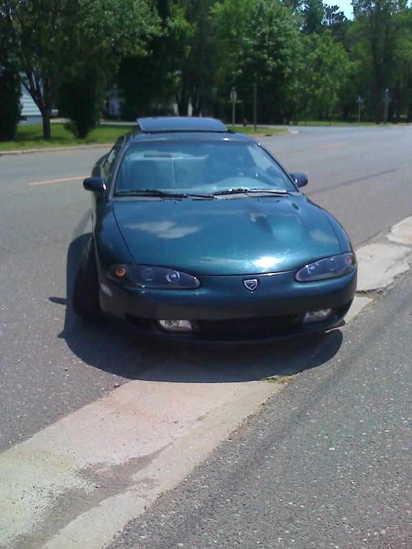

Can anyone guess what happened here?..
If you guessed right it's lower ball joint FAILURE!!! Yeah that's what just happened to me about 2 hours ago! Broken axle and ball joint!
400 Dollars gone!
DAMMIT!

Shouldn't that be covered under the ball-joint recall?

Not sure... How long that recall last for? Ever?

Safety recalls last forever and must be performed as often as necessary. Verify the recall was for the failed part and tow it to the dealership (the tow charged should be covered by the recall too).

Yep I got $500 from Chrysler by writing them a letter and sending a copy of the bill for the exact same problem.
Then I took it to the dealership and had them replace the other one.

They won't cover your tow. At least, not Roseville Chrysler. Not even if they tell you they will cover it. They are asshats.

So what if it's already been performed once? Should it be done again?

How do you find out if the recall has already been done?
Also if you have a modified car is it still able to get the recall?
Old 06-26-2008   #15
Re: What's wrong here?
You give the dealership your VIN# and they can tell you if its already been done or not. Safety recalls will be covered on all street cars even if they are modded.
