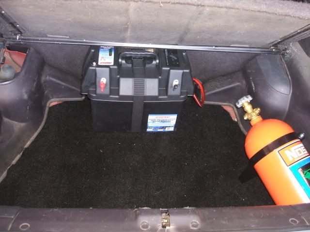

New black carpet (part1)
Carpeted trunk with batt box (part1)

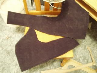

New kick panels (easy to make for those with a bare center console and lost theirs)

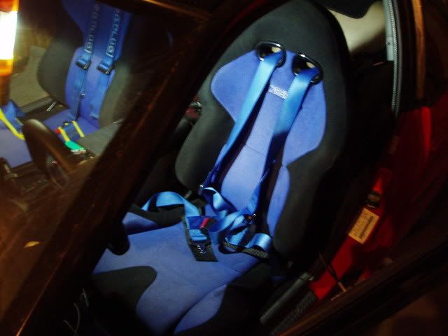

New racing seats and 4 point harness' (auto seatbelts ruined in flood)

Nice. I hope you have a harnes bar to mount those shoulder straps to.

Nice. I hope you have a harness bar to mount those shoulder straps to.
Not yet im working on some ideas right now, trying to keep the back seat as much as possible but well see. Its better then having seatbelts that dont work at all and stuck in the down position
Old 03-23-2008   #6
Re: Interior restoration part 2
Couldn't u have a bar fabbed that goes across the car behind the seats, i know that is what a harness bar basically is, but you could have one in a position that allows people to get in the back but its a bigger pain in the ass to get back there.
Old 03-23-2008   #7
Where did you mount the shoulder straps? Please don't say on the floor behind the seats. If you get in a front end collision, as your body moves forward they'll pull your shoulders down and compress your spine.
Old 03-23-2008   #8
do a bar from seat belt to seat belt on the pillar.
Old 03-23-2008   #9
twack
It was a auto get over it
twack's Avatar
Location: rochester mn
Posts: 1,987
Right now their just mounted to the stock seatbelt location i havnt even driven the car yet. Ill probably end up with a bar like aaron said.
