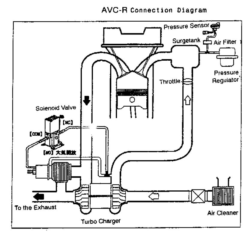

You are running both lines on the w/g right? 1 coming from the intake manifold going to the w/g and the boost solenoid, the other just coming from the boost solenoid.

This is how you should have the solenoid hooked up with your w/g.
If its not like that, you could also be having issues.

Yes i have it hooked up like the diagram. Ill try the higher settings.
