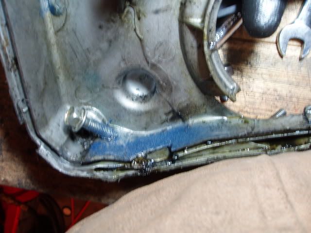

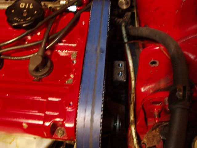

Well my timing belt recently developed some heavy wear down the middle, so I decided it was time to get to the bottom of things.
I just got the timing cover off and look what i found
Pretty amazed, not sure what it came from yet, but man am i happy i got to this in time. Solution: thanks to jake a quick greddy belt

Damn! Good thing you did catch that right away. I don't recognize that bolt either. I did my cam's a month ago and still haven't put my cover on yet just cause I want to watch and make sure nothing fishy is going on with my belt. But of course once I actually start driving it, I will put it back on. Did everything go back together good?

Timing belt cover bolt, valve cover/upper timing cover bolt that fell, etc. Looks small! Good find though!!

Nope... Bolt from the oil pump/case cover.
At least the belt didnt snap! Now get it back together and get the shift box put in!

Ya during the flood i didnt have my garage so i had to bring my car to a shop. The one damn time i dont do my own work they cant get the job right. Like jake said the bolt was an oil pump bolt that backed out, which never should have happened. I am forever done taking my car to anyone else
