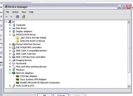

I tried uninstalling & reinstalling the driver as the troubleshooting said to do, but it still shows up like this:

And also, I just checked in BIOS and it is reading my drives... and they are both "on"... so I have no clue at this point.
Would it really make a difference to unplug & replug the connections inside the case?
