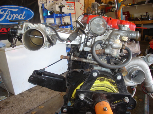

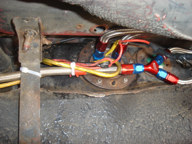

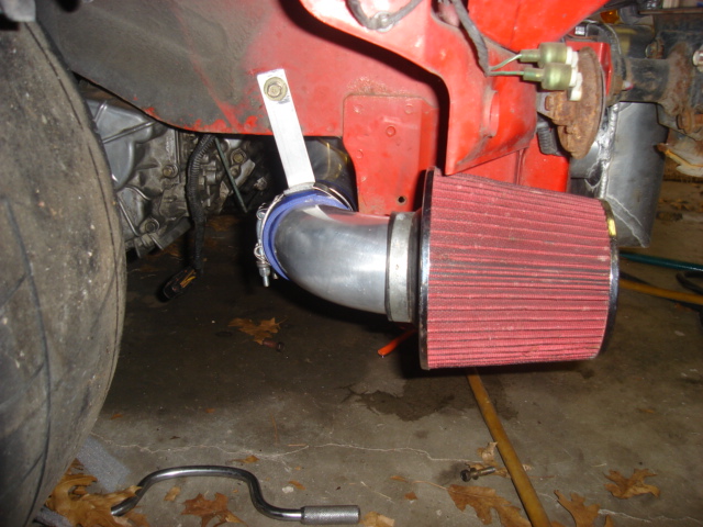

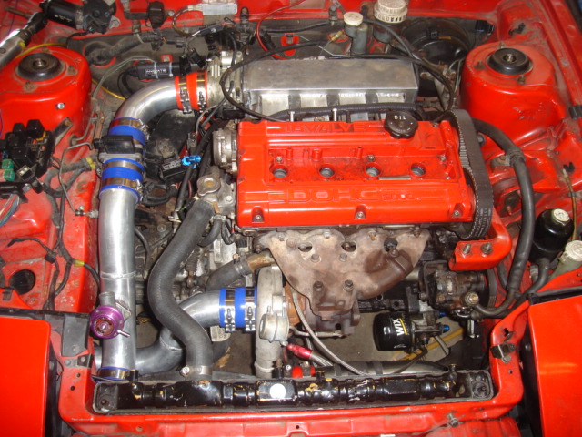

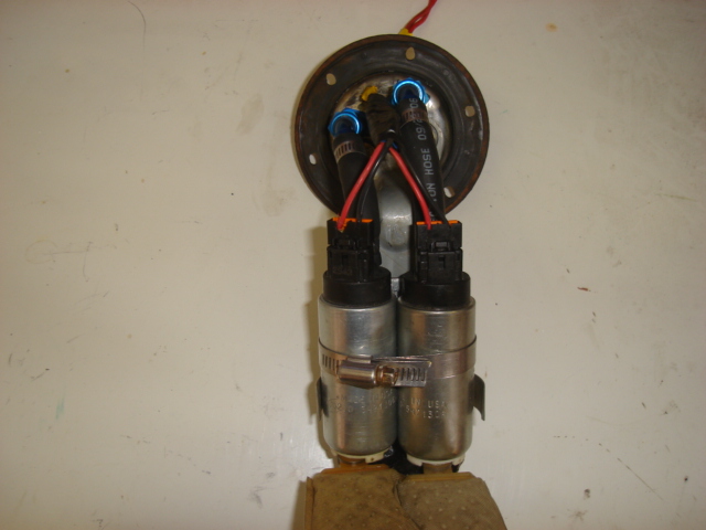

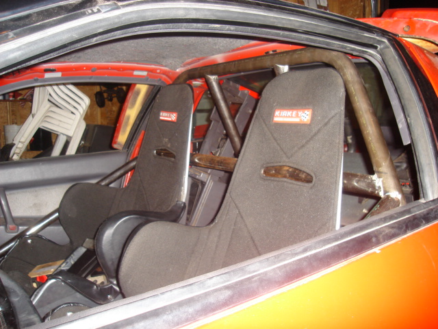

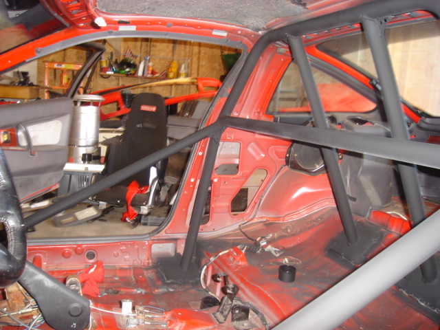

since everyone else is doing it, I figured I'd post up what Ive been doing on my car the last few months.
-6pt roll bar (prebent hoop and straight bars purchaced from LSE)
-Infinity Q45 90mm throttlebody
-3" intercooler pipeing from the intercooler to throttlebody
-3" cold air intake
-dual in tank walbro 255's (E85 takes 33% more fuel you know)
-Innovative LC1 wideband
I have it all pretty much back together. Im just waiting for some injector O-rings and a serial cable for the wideband. I think it will be running This weekend and be ready for some E-85 tuning. Only one weekend to late LOL.
More pics can be found here http://www.cardomain.com/ride/2396643/3

still running the scm-61. the q45 and the 3"ic pipeing make it look tiny though
Here' s a pic with the q45 and the 61

Man, your pumps went together nicely. I had to monkey around getting the socks to align just right putting the pumps together that close. Nice work, see ya at the track again.

Looks good, but WTF is that Intake mani?!?!?!

I got the intake from John at LSE. (but I dont think he made it) Its a little boxie but it does the trick. It has a large plenum and tapered runners.
The fuel pumps were a little tricky since I havent seen any other twins on a 1g fwd. they barly fit in the tank
