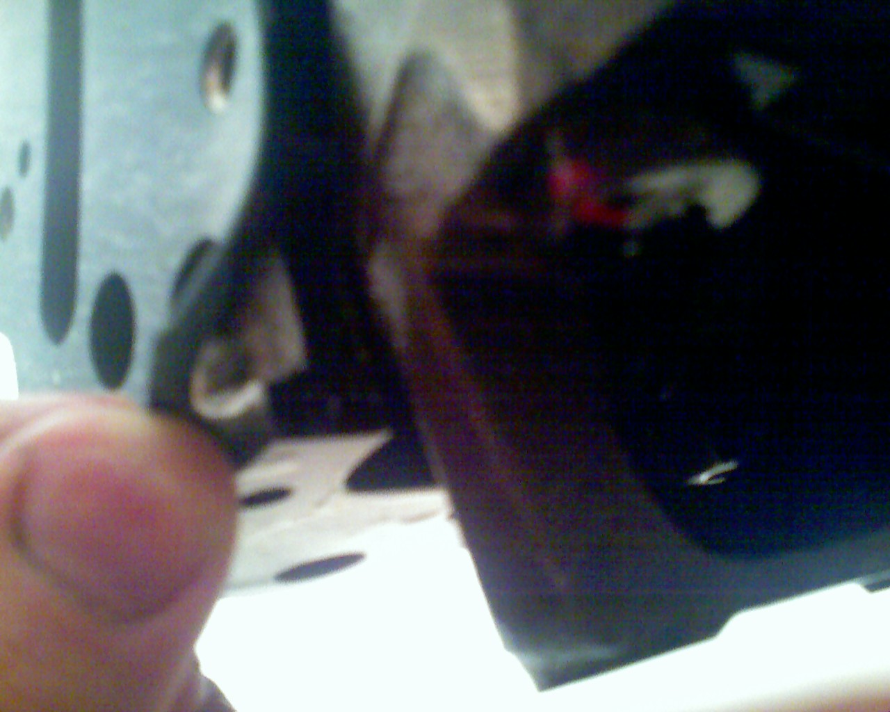

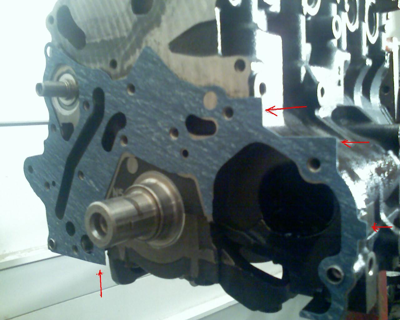

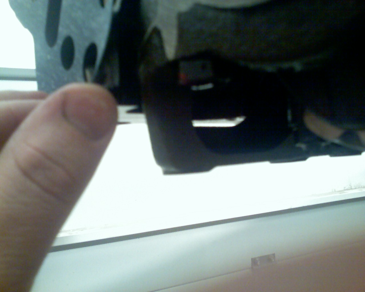

Thanks JET, one last question before I bolt it on. I put the front cover gasket up against the block. I noticed there is various overhang in spots where there isn't even anything behind the gasket. Is this ok or am i supposed to trim it. This area in the picture on the right side of the crankshaft is at least 1/2 to 3/4" of overhang without any engine metal behind it.
Thanks!!!

Overhang won't hurt. As long as all the ports are open, and whatnot it will be ok. Copperspray the HG, as long as it's a non metal one. Also, hi-temp paint works too.
-A. Swift

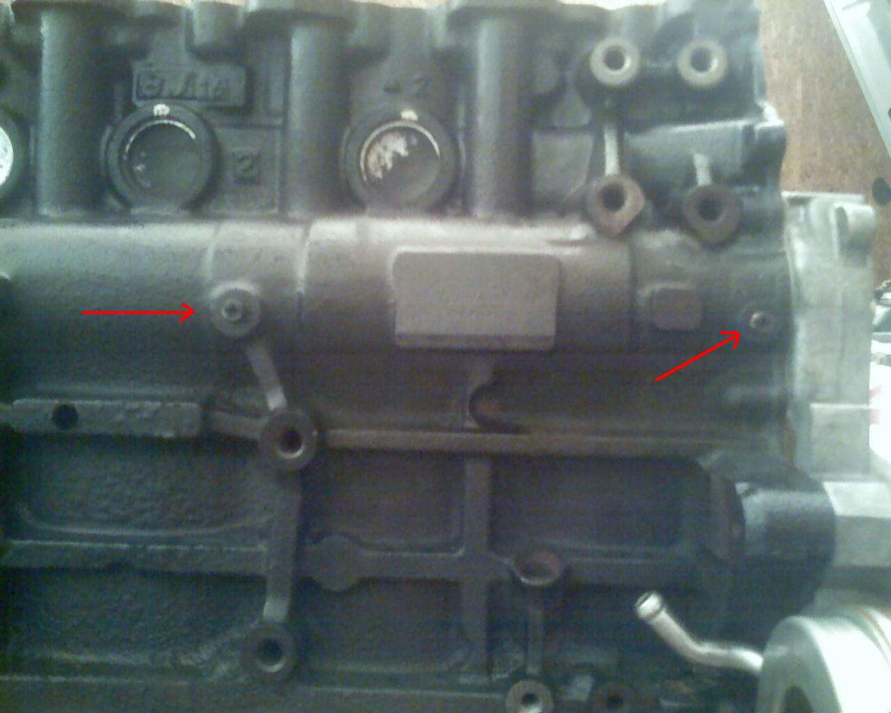

Rather than starting a new thread, I'll just post in this one. I'm just going through all the bolt and plugs on my motor during assembly. I did have new balance shaft bearings put in. Can anyone tell me what these 2 screw in plugs are for. I took the plug out and tapped in there with small screwdriver and it seems like it is the back side of the balance shaft bearing. It doesn't go all the way through. In otherwards, It's a hole that goes nowhere. When the machine shop put the bearing was this hole supposed to line up with a hole on the bearing?

" Note the screw in plug on the left (circled) - that is to allow the factory to drill the oilfeed hole from the bearing journal into the oil galley."
Looks like it's just a one time use thing when they made the blocks. The oil holes would be directly across from these screw in plugs.

Yes that is so the oil galley to the front BS could be drilled, you can put the plugs back in or drill them out for a bigger AN plug.

Access points to allow Mitsu to drill into the inner oil gallery for the balance shafts.

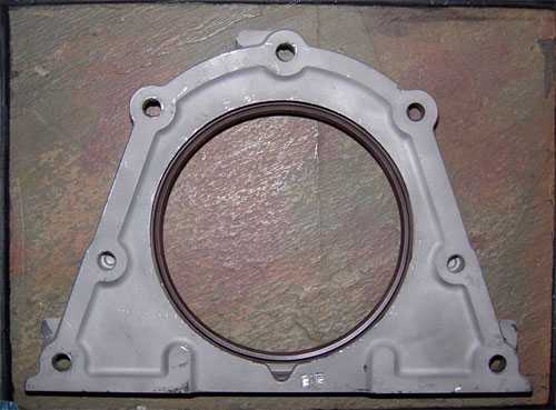

What do you engine builder guys recommend for gasket sealer for the rear main thing (pic attached)?
Do you normally use grey or black RTV?
I have a big chauk type tube of black engine RTV that I picked up to do the oil pan for when I put it on. Just wondering if it makes a difference on the rear main bracket thing.

The rear main seal housing should have a gasket, and a little copper spray would not hurt. I use Black RTV for all oil needs and grey for coolent.

Yeah, shouldn't need any silicone in there, just the gasket. I am a big fan of Ultra Black for most everything.

dam.. I ordered the full engine gasket kit from Brookdale Mitsubishi. I looked through everything last night and didn't come across a gasket for the rear main housing thing. I did some more reading up last night and I guess I'm wondering if the 6 bolts are the only ones that use a regular paper gasket for the rear main housing and the 7 bolts used RTV. Went to extremepsi also and they only show a gasket for that for 90-94.
Can you or anyone clearly confirm that the 7 bolts do indeed use a paper gasket? Come to think of it, I don't remember scraping paper gasket material off it but that was several months ago. I don't remember.

Just put a real light coat of black RTV on there and call it done.

Mitsu service manual says for oil pan and rear main seal housing on 96+ 4g63 use Mitsu part#MD970389 or equal, so black RTV will be good. I should have looked it up in the first place.
