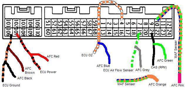

Re: help
When you unplug the plugs. Stare at them with the latch facing up. So the pins read from right to left. I used the vfaq help on connecting the SAFC to a 1g ECU here is the 1g GVR4 SAFC install. I know it says GVR4.... But that car also has the same ECU as a 1g. Also I know they should of said pinout numbers. But by reading that it seems pretty straight foward for me. But I hope the photo helps you out. Sorry for my bad MSPaint skills. I am more use to Photoshop.... I can not find my CD to install it. So eh...good luck with this. I would love to help you but it take me 14 hours to drive to help you. Oh ya btw make SURE you connect the brown AFC wire as close to that plug as you can. And then plug the AFC black wire alittle bit behind the brown wire. And the AFC blue wire is optional. As stated in the faq....
