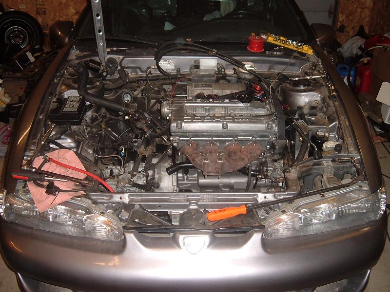

Well, I don't know if anyone cares, but here is where my car is at. I just got a new camera, so I wanted to play with it
I should hopefully have the rest of the engine together today or tomorrow. Maybe have it in tomorrow night? That is probably a little optomistic, but we'll see what happens.
For those that don't know, that is a 2.4l with Wiseco 8.8:1 pistons on eagle rods. Majorly ported head done by myself. HKS 272 cams, Crower springs and retainers. No balance shafts, plugged balance shaft oiling holes, and deleted or cut down brackets on most everything.

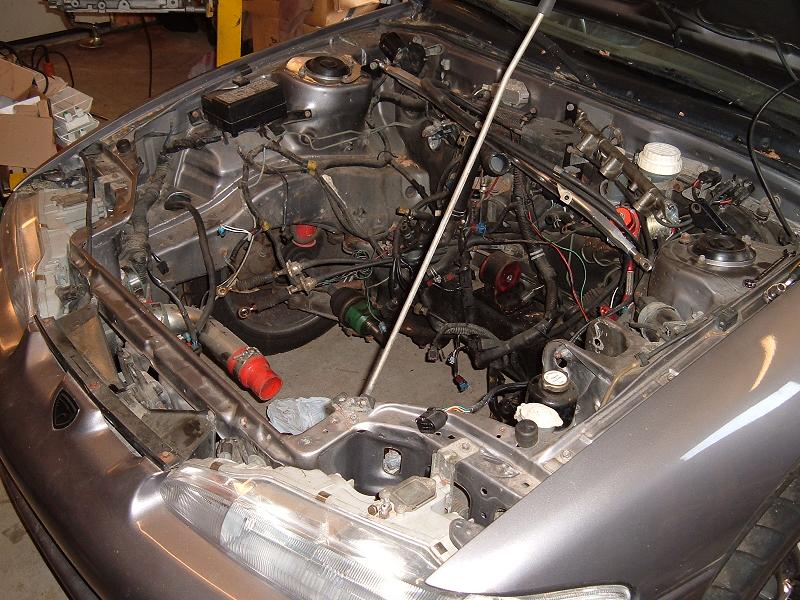

And the empty engine bay...

520Talon
Posts: 350
Dude, how bad is your luck that the worlds smallest hurrican ran right through the inside of your car. Good luck on the clean up.
Also I noticed that you remove the tranny mount from the frame. I always just pull out the center bolt and pull the bracket from the top of the tranny. No big deal just looking at the different way people pull.
Yeah, I pulled the whole mount off when pulling it. It gives you more room to get it out.
Cher, you definately are farther along than I am. I still have to fabricate a 3" O2 housing and DP for my car after everything gets in. I want it running next weekend though.

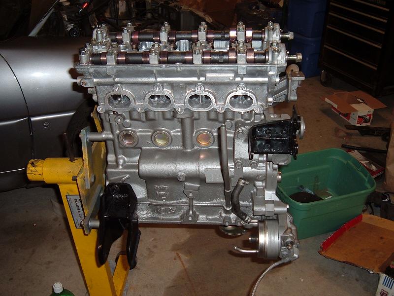

A pic of today's progress (not much!)

Enes
Enes's Avatar
Posts: 2,789
what cams are those?
Nice looking... i can't wait to see it running again!
-E
HKS 272
