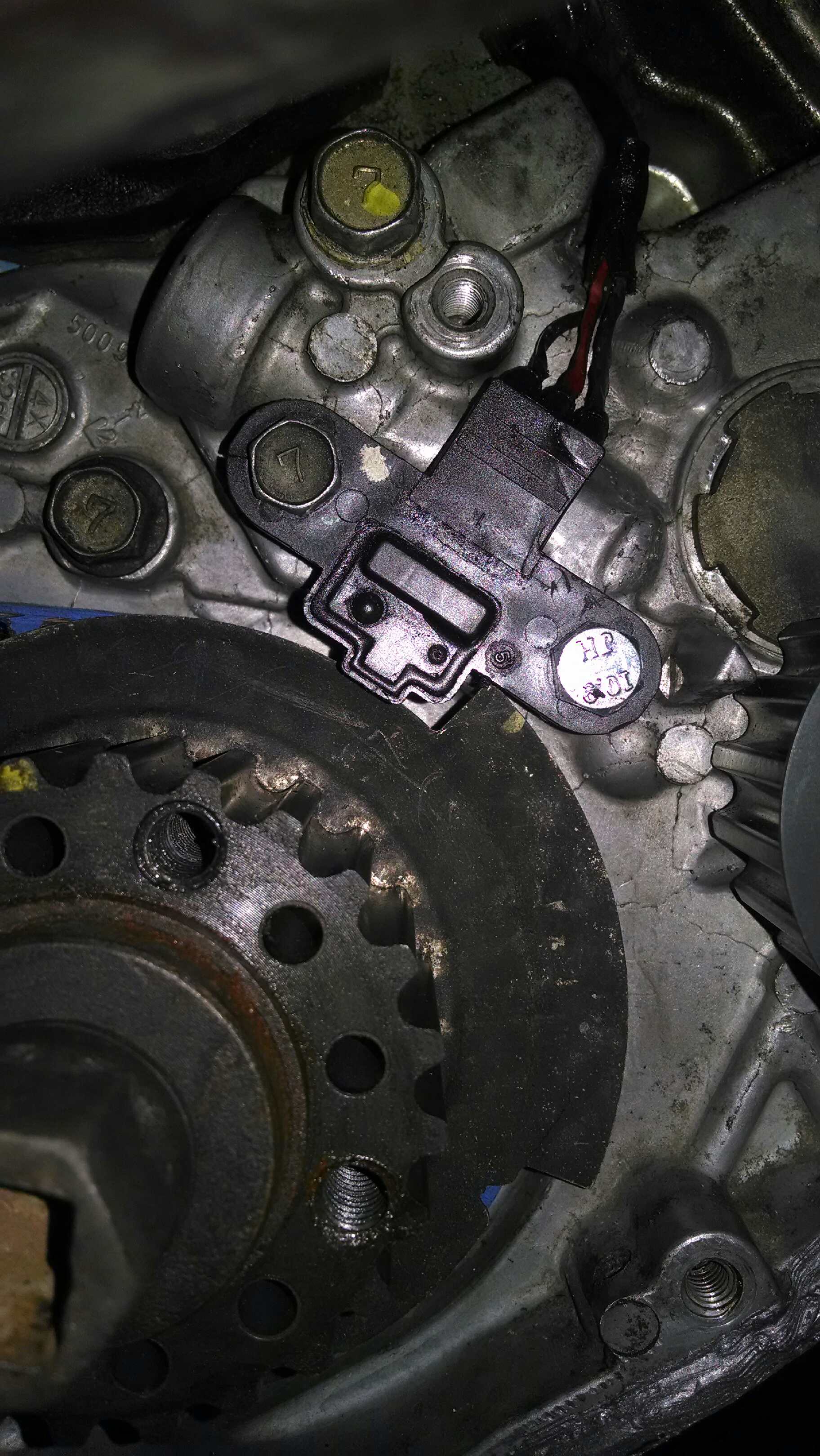

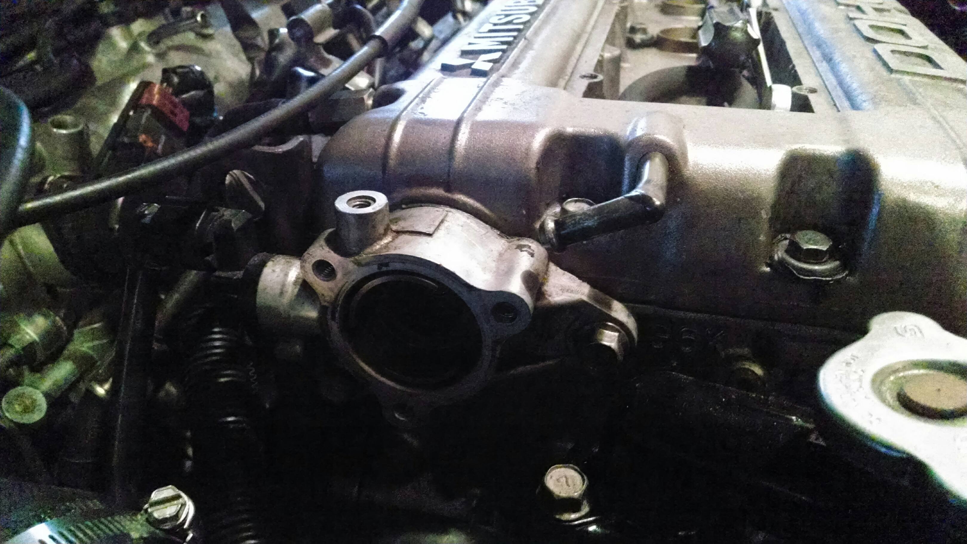

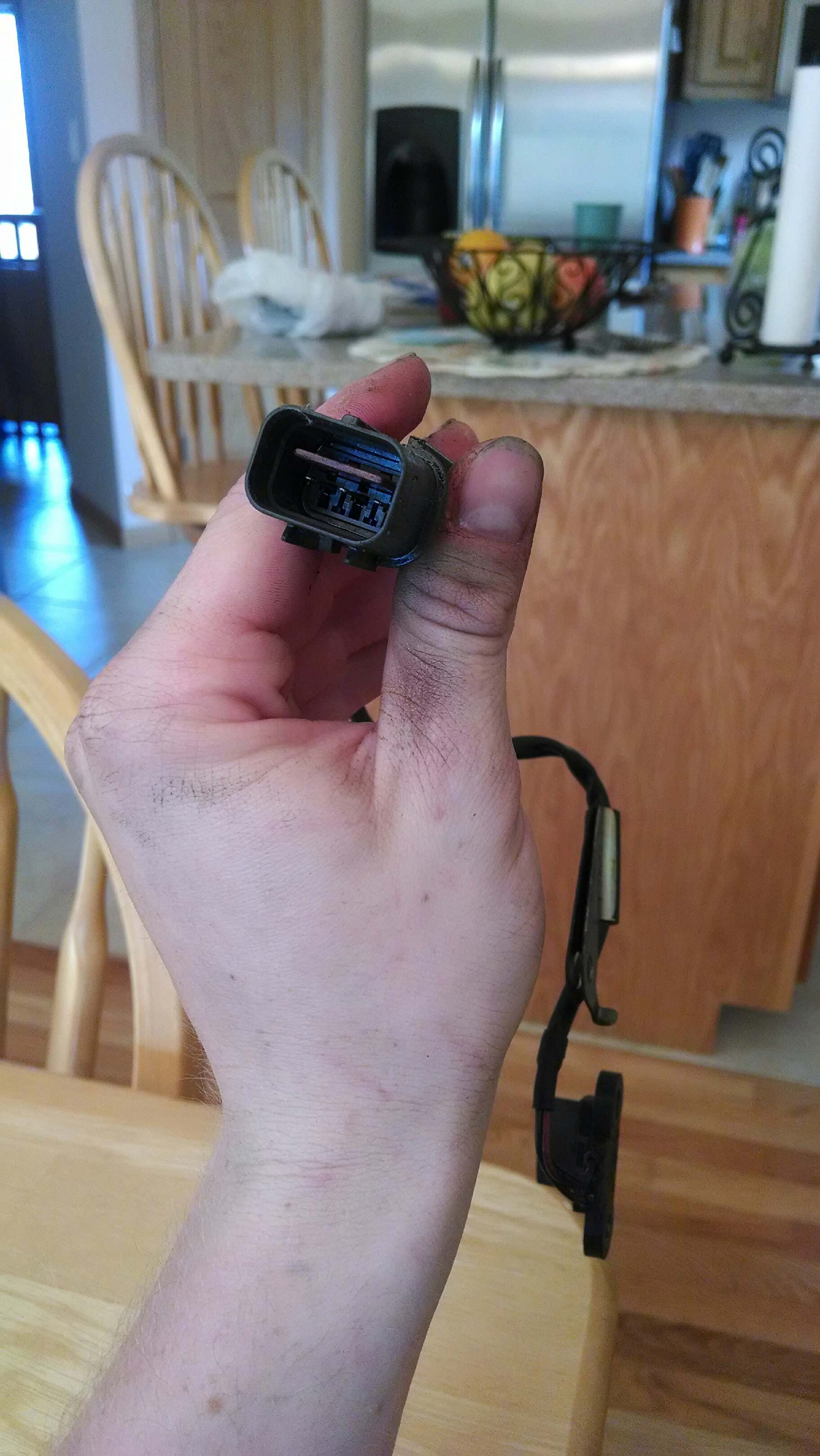

I am almost done putting my car back together after having the head off. I cannot figure out where this hooks up to. I know it is the cam position sensor and it sits behind the intake cam, but I have no idea where the connector plugs into.
Please help! Im hoping to get this running asap.

I think it might have been on there still from when the previous owner put a JDM engine into it. It has the CAS on the passenger side of the intake cam and that is actually hooked up.
So my question now is, do I even need this?
mitsukid124 is offline   Reply With Quote

Re: Where does this sensor go?
If you have a 1g cas you do not need that one
That's a 97-99 cas.
You need the 97 cas and the crank sensor
Or
95-96 cas behind the cam gear and crank sensor.
Just depends in the cas plug on the harness 95-96 or 97-99

ok, that makes more sense, now I just have to find where the cas behind the cam gear plug into. I see nothing that has a square plug.

Is anyone with this style plug (from the original post) able to chase the wires in their car and see where it connects to and where that connector is located?
If it's in the 97 it will not have a plug for the cam gear cas. Just will have the crank plug and cas plug on the pass side for the 97+ cas
95 and 96 had the cam sensor behind the cam gear. All others had it on the end of the cam. It looks like you have a 97-99 style cam sensor so you shouldn't need the one behind the gear.
