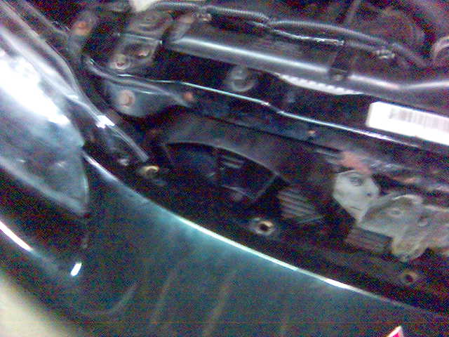

Hey guys. I had a single 12" spal fan mounted on the driver, engine-side off my radiator on my 2G. I never had an issue with over heating until I tried to run the AC for extended periods of time. So, I picked up a second spal fan. It had to fit in front of the radiator (compressor/j-pipe clearance issues) and I thought a 10" fan would do the trick. So, I ordered up a 10" High-flow SPAL fan rated at 1060 cfm. I just about cried when I got it, as it's about 3.6" thick where the motor is, and I have a 3.5" FMIC core, condenser, and power steering lines that it has to fit inbetween. Ugg...
Well, it was *tight* but it fit. I took some pics, but they were with my phone, so please excuse the poor quality. I'll get some high-res ones tonight.
