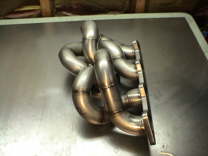

What material does Alien use? It looks like the flange is different than the runners. What thickness is it? The #1 runner turns very quickly after it comes out of the head. I don't even think it is straight in the beginning. I like the polished one a little better where the runners come together.
Archer used to offer a warranty on their tubular mani's too. They may offer to reweld anything that cracks, but that is a PITA. Do a lot of research before you decide.
1/2 inch carbon steel flanges, 304 stainless tubing. 321 flanges and tubing are available, but the price goes up. If I remember correctly (and I may be wrong on this) they said it was 8-gauge stainless tubing. I have some more pics below that show the thickness. I also have a pic of how the runners exit the head flange as Jet has a concern about the runner turning too quickly.
