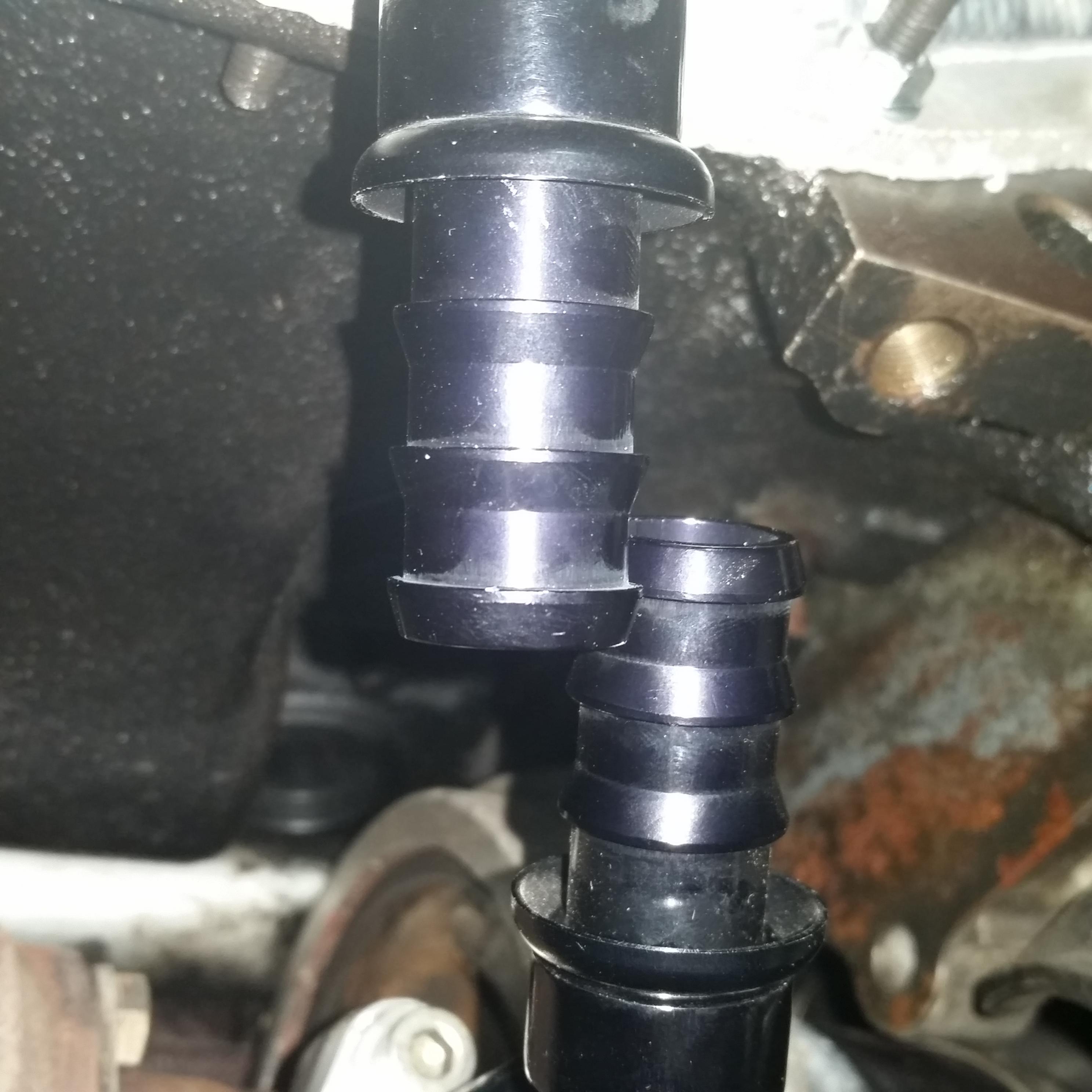

12an oil drain finally done.
(Months of waiting for fittings only to be to large for the distance between turbo and drain on the pan.
12an standard fittings won't work. Finally had to go with 12an push on fittings and then cut them down to size. And took a "press" at work to finally get the braided line onto them. Was a pain in the ass.
