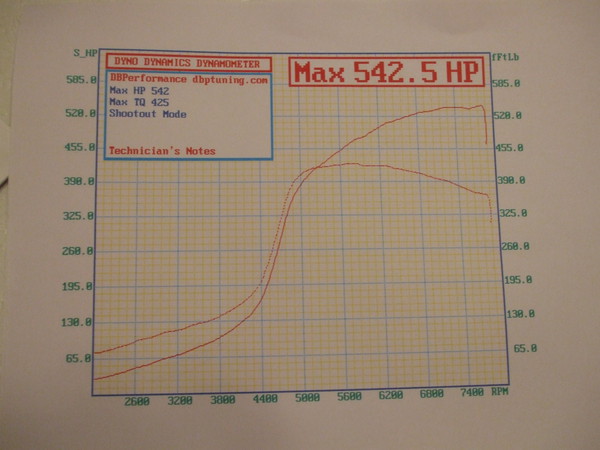

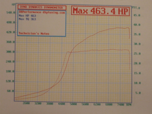

OK so, I brought my car to Shane today and we gave it our best. I am running into ignition issues about 27psi so we had to stop at that mark... With the ignition issues being fixed he said I would have no problem getting over 500awhp on his dyno.
He also recommended running speed density with a AEM 5 bar. My GM MAF is all over the place. My main problem with the spark is that I'm not getting enough volts from my alternator to my battery. But I'm also throwing a alternator CEL. Any how here's the graphs.
