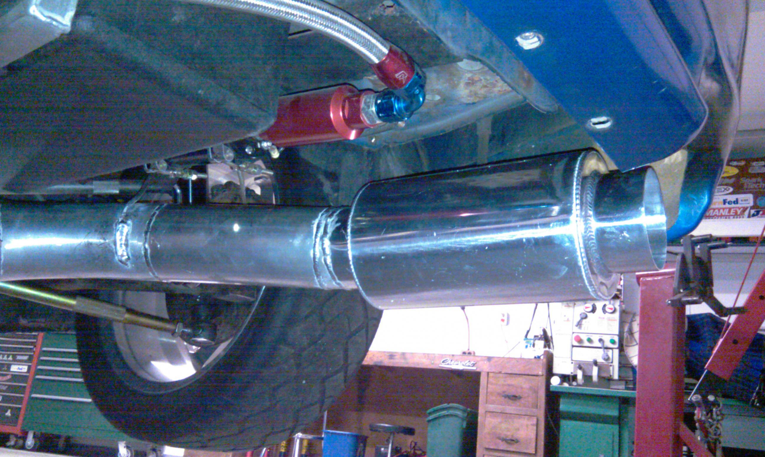

Just finished up my 4” aluminum exhaust this winter on my 1G and thought I would throw up some pictures. I want to drive the car on the street and didn’t want to do a fender dump, so this is a great alternative. It transitions over from stainless steel to aluminum at the back of the oil pan. Its 3.5” stainless from the turbo to the transition at the pan. I made the 3.5 to 4 inch transition to a v-band. It uses a vibrant aluminum muffler. The total weight of the aluminum section is around 13 lbs. I cannot wait to hear what it sounds like!
