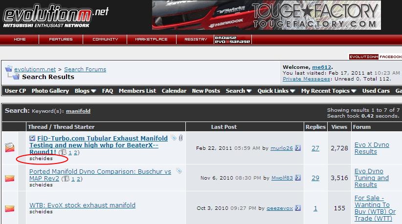

1 Attachment(s)
Originally Posted by Kracka (Post 378117)
FiD posted Scheides' manifold testing results all over EvoM.
Wat?
http://mitsustyle.com/forums/attachm...1&d=1301085077
Murlo26 03-25-2011 04:32 PM
Re: MAP's Evo X Exhaust Manifold Testing / Dyno Results
Scheides posted some, but FID posted all the results that Scheides didn't really plan to post where they upped the boost and what not.
I am guessing that is what Kracka meant.
Shane@DBPerformance 03-25-2011 04:46 PM
Yea, we upped it a psi or two to try to match the psi that the car was running with the MAP exhaust manifold. That was after running it with no changes and it dropped a little bit of boost.
