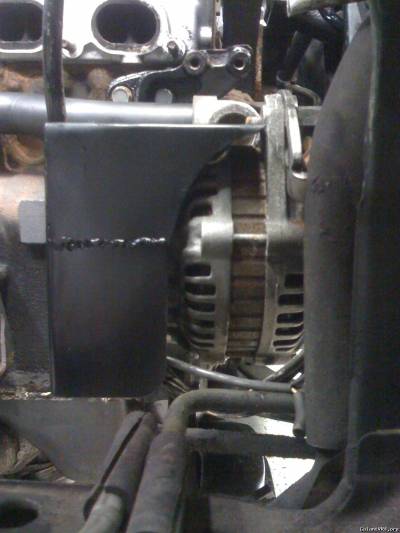

I made a heat shield for my alternator. I'm trying to gauge interest in these to see if I should make some more.

That little bad boy could have saved me two tripes to the 24hr auto zone when touching a wrench to it blowing fuses. LoL. But it's Fugly

Just grind on it for a little bit, have them Powder coated and voila. Function.

I only had time to make it, not paint it.
I'm going to use high temp engine paint. A low gloss black.

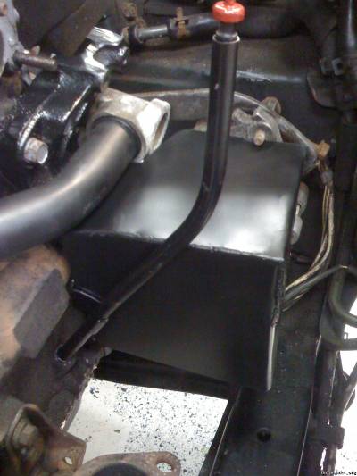

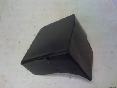

I cleaned up the welds and painted the shield to see how it would look finished.
I also took a picture from underneath, to show the airgap around the alternator. The shield doesn't block any vents for the alternator, just the heat from the exhaust.
I'm planning on mounting it to the dipstick mounting tab, I'd like to find a second mounting location. I'd hate to create another rattle in our cars. :P

if you give me one ill weld up a bunch of them for you and youll have really good looking tig welds

personaly i think it's also a little fugly, clutters up the front of the engin more.

People with external wgs may have a hard time using that. I know Both me and Project2gs dump tubes go right where that would sit.
I think its a good idea, but you would neeed to make it much less boxy. Use a bender to basically make it bend with the alternator. The other thing would be the fact that its metal and sitting really close to the positive of the alternator, you would need some kind of rubber to make sure it doesnt ground out.
There is already a rubber boot on the alternator eyelet from the factory.
Looks good man, If I wasn't relocating mine I'd snap one up.
