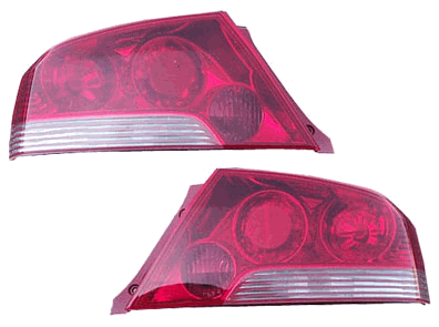

I'm looking at options for painting my tails to make them JDM Evo VII style, and stumbled across this stuff:
http://i76.photobucket.com/albums/j3...s/IMG_1091.jpg
I was straying away from paint because everyone I talked to said that they ended up looking pinkish. Well with that paint above, someone got these results:
http://i76.photobucket.com/albums/j3...s/IMG_1097.jpg
Not half bad, very nice red color! But my main concern is, how will a paint like this hold up to daily use on a car?

3 Attachment(s)
I think you should paint the red stripes over the turn signals. I think it makes that taillight look more complete, even though it would prob be alot more work.
Attachment 7595
Attachment 7594
Attachment 7596
had to just attach the pictures at work..
