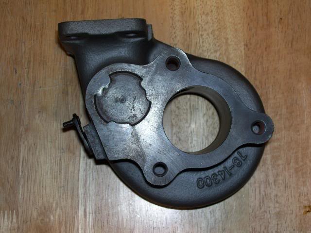

talonsway 04-10-2015 12:03 PM
Re: Over Boosting? Need some help guys
1 Attachment(s)
If it's a Chinese 16g just get rid of the Damn thing, they are known garbage
not an ebay piece of shit
Wouldnt the solution with the test he did be to port the hole behind the flapper until its close to the size of the flapper? probably a ebay or amazon 16g ive read you have to do this to eliminate the boost creep on them.
http://www.dsmtuners.com/threads/evo...%C2%94.163103/
I could...... but i think imma take a different approach.
Attachment 15134
Imma run a 10cm t3 turbine hosing on my 16g. Then get a nice t3 manifold, with a provision for a external wastegate. Then get a flange for the o2 housing and weld an elbow on it and maybe do a v-band down pipe i have always wanted.
