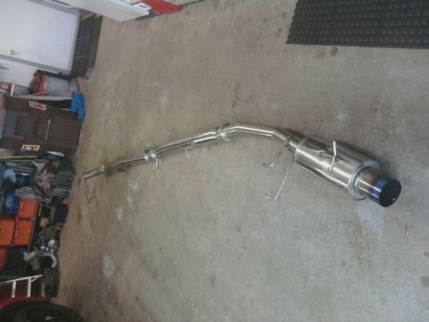

Just got back home from picking up a turbo back. The down pipe back has 1000 miles on it. The o2 Dump had 10k on it will be selling it I have no use for it. He bought th down pipe back and new rims and tires and blew his engine after putting them on.
http://i122.photobucket.com/albums/o...ms_picture.jpg
http://i122.photobucket.com/albums/o..._picture_2.jpg

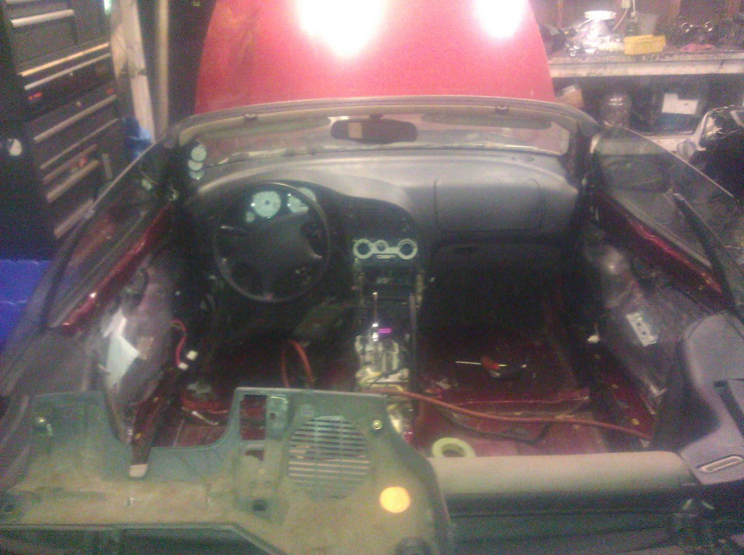

Have had some time sine I cut a huge hunk of meat out of my thumb at work and have been off since sat. Felt ok today after I got home from a check up on the thumb, I got the brackets done and the evo 3 seats put in the car. Also put in the megan exhaust and drive shaft.
http://i122.photobucket.com/albums/o...018_181258.jpg
http://i122.photobucket.com/albums/o...018_181227.jpg
http://i122.photobucket.com/albums/o...018_181310.jpg

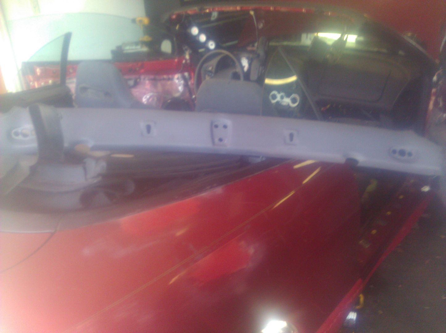

the rest of the grey parts showed up yesterday.
the home link visors will recover them in a darker grey
http://i122.photobucket.com/albums/o...021_152817.jpg
top panel and a-pillers
http://i122.photobucket.com/albums/o...021_152838.jpg
http://i122.photobucket.com/albums/o...021_152857.jpg

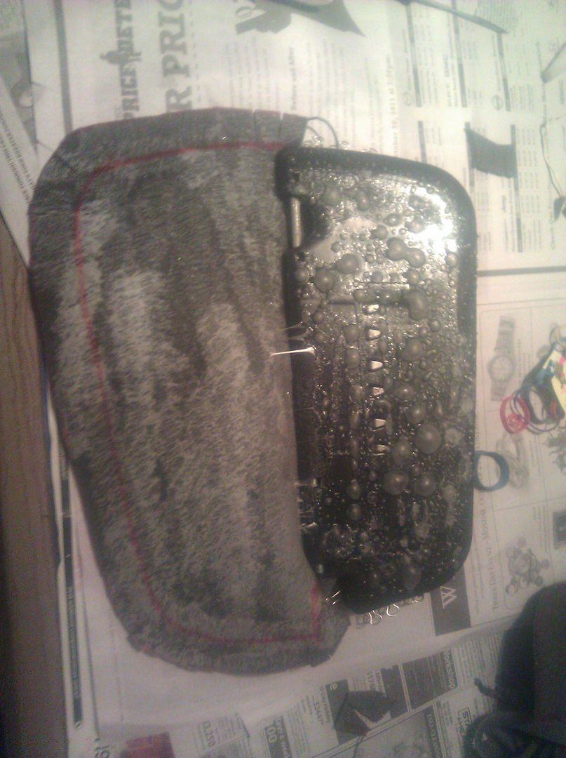

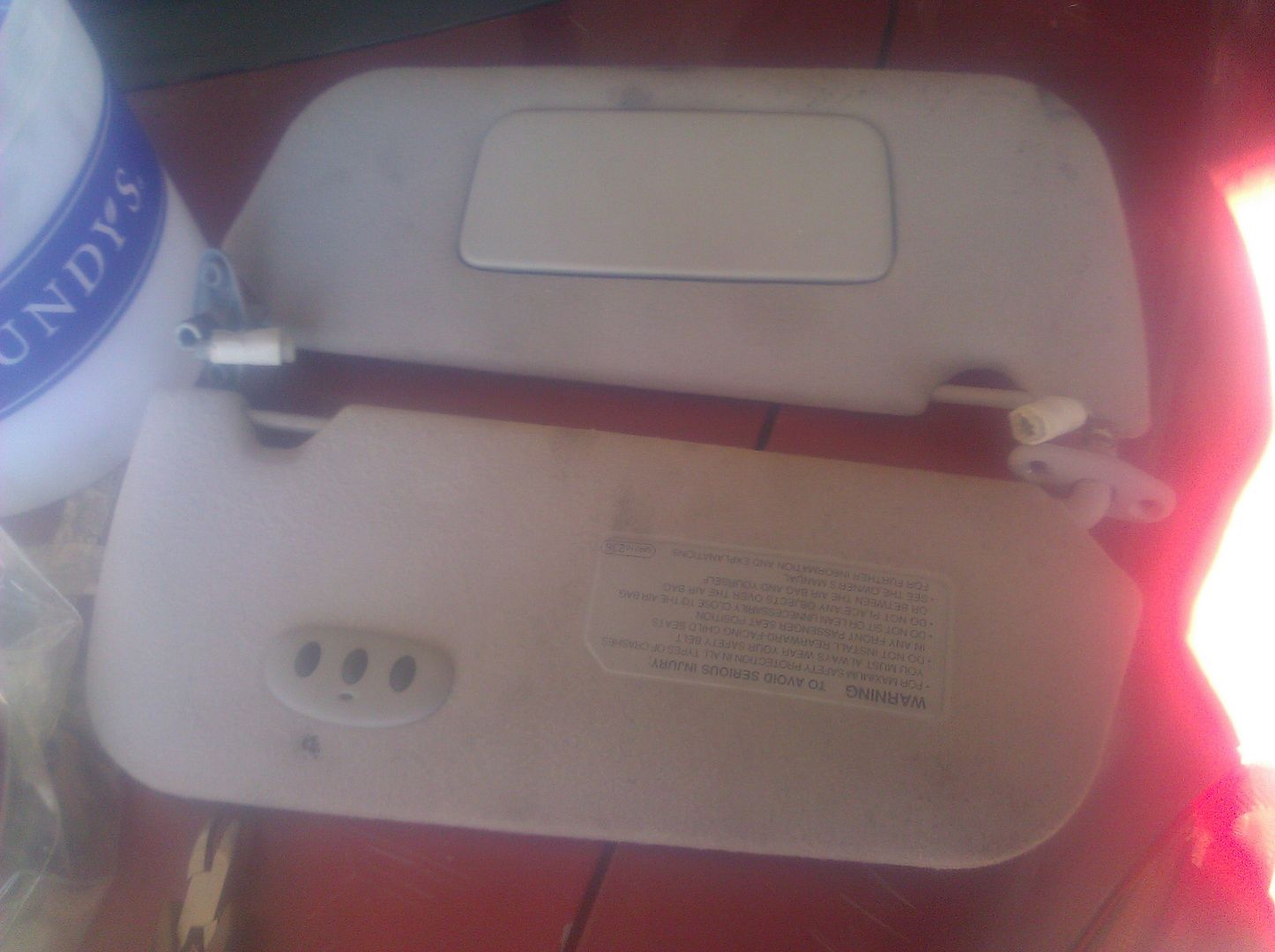

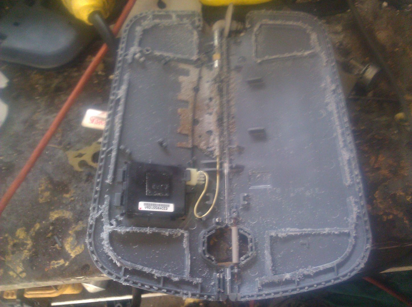

Got 1/2 a yard of headliner fabric so I could redo the visors.
1st took the old fabric off the visors
http://i122.photobucket.com/albums/o...024_153913.jpg
Used a body saw to cut the visors so they could be opened all the way up
http://i122.photobucket.com/albums/o...024_155253.jpg
http://i122.photobucket.com/albums/o...024_155248.jpg
Using 3m 74 spray glue for headliners and fabric. Glued 1/2 at a time since I don't have any more clipse to do it all at one time.
http://i122.photobucket.com/albums/o...024_214812.jpg
http://i122.photobucket.com/albums/o...024_221551.jpg
The drivers side it done. Used 5min epoxi to glue the visor back together as one piece
http://i122.photobucket.com/albums/o...024_214800.jpg

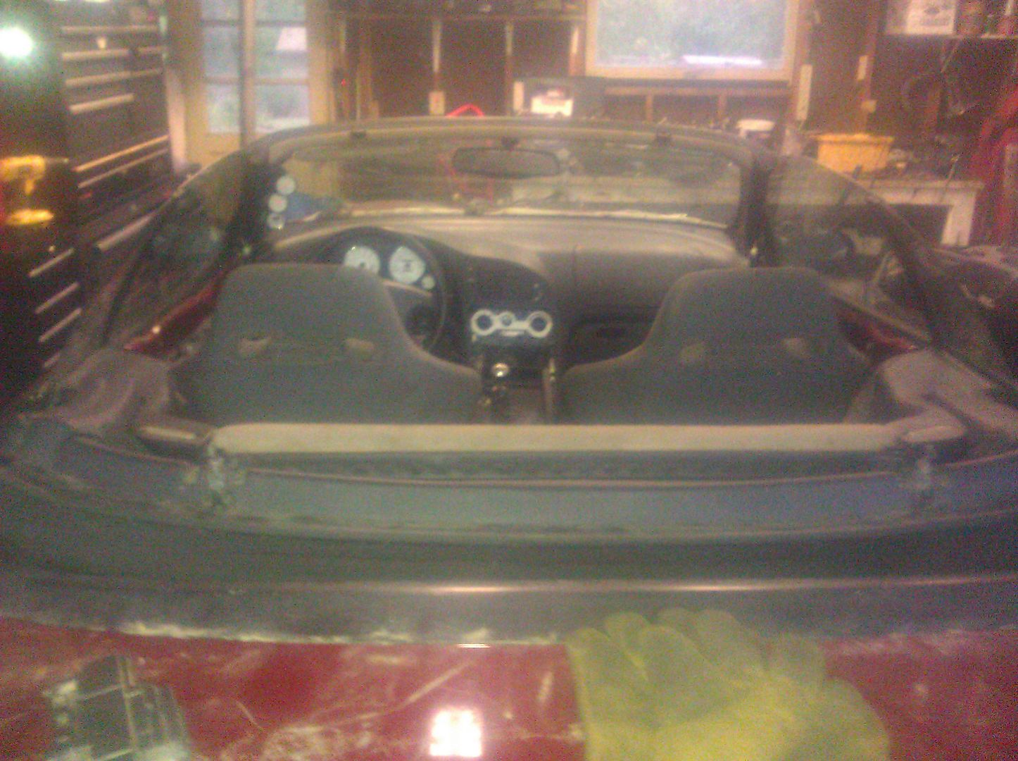

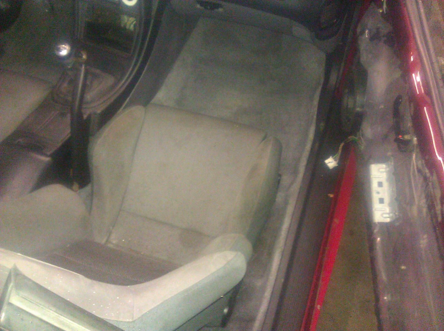

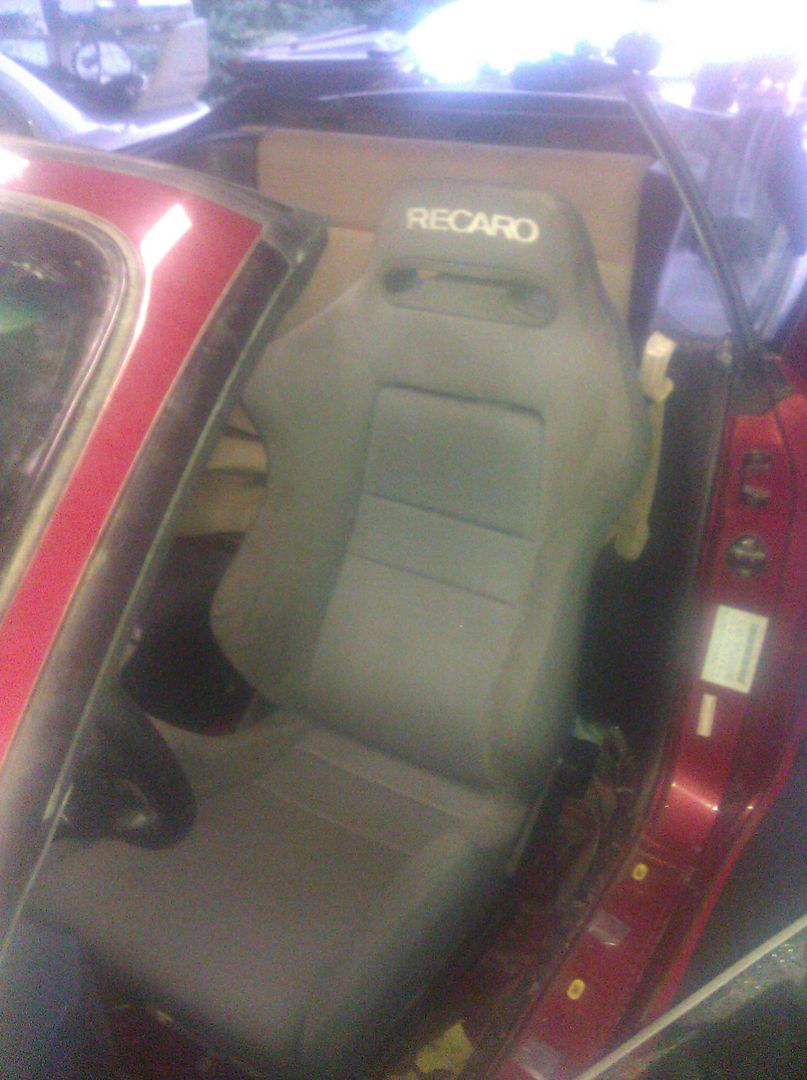

the carpet was all dry today so took the seats back out to put it in and put the rest of the panels in also.
http://i122.photobucket.com/albums/o...025_175538.jpg
http://i122.photobucket.com/albums/o...025_175551.jpg
http://i122.photobucket.com/albums/o...025_175609.jpg
pass side visor all done and painted the mirror darker to match the new color of the visors
http://i122.photobucket.com/albums/o...025_175618.jpg

Looks good! I liked the pictures of taking apart the visors, I never knew how people did that.
Kinda wish I had that fmic back haha
TkrPerformance 10-28-2011 05:11 PM
Re: after 10 years its coming back to life
Every one I seen just prys the visors apart and they end up braking. Used one from the talon to start with to see the easyest way to take them apart.

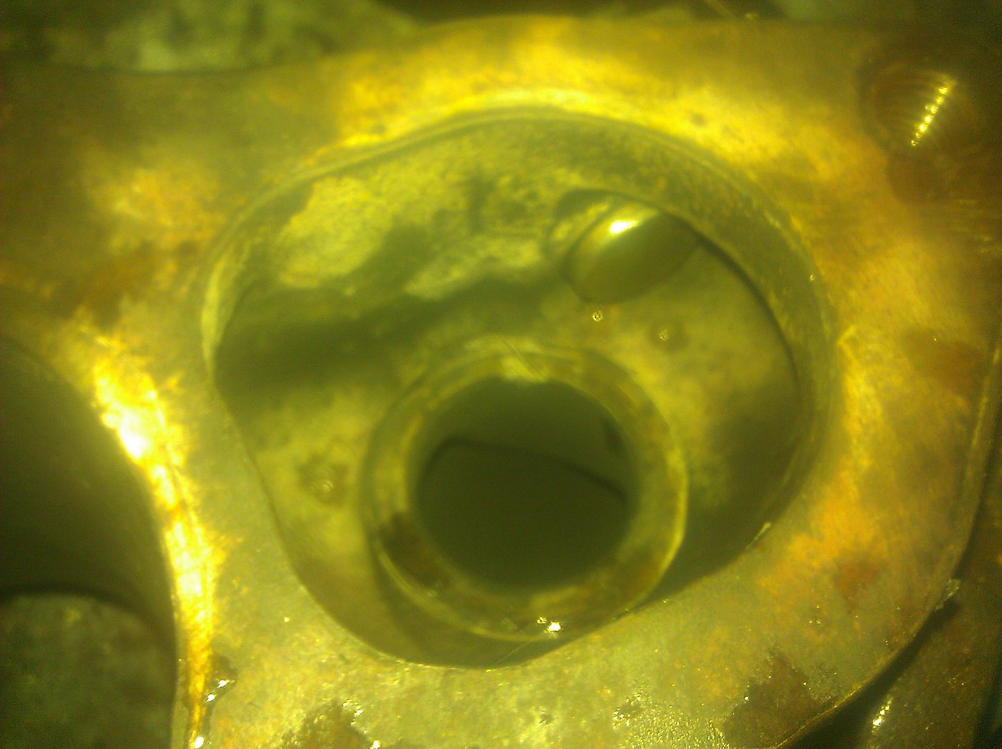

also took the turbo apart to cut out the flapper since I will be running a tial 38 gate
http://i122.photobucket.com/albums/o...105_173456.jpg
cut the flapper arm off flush and put it back in and welded it back on
http://i122.photobucket.com/albums/o...105_173503.jpg
http://i122.photobucket.com/albums/o...105_173510.jpg
all back together out
http://i122.photobucket.com/albums/o...105_175248.jpg

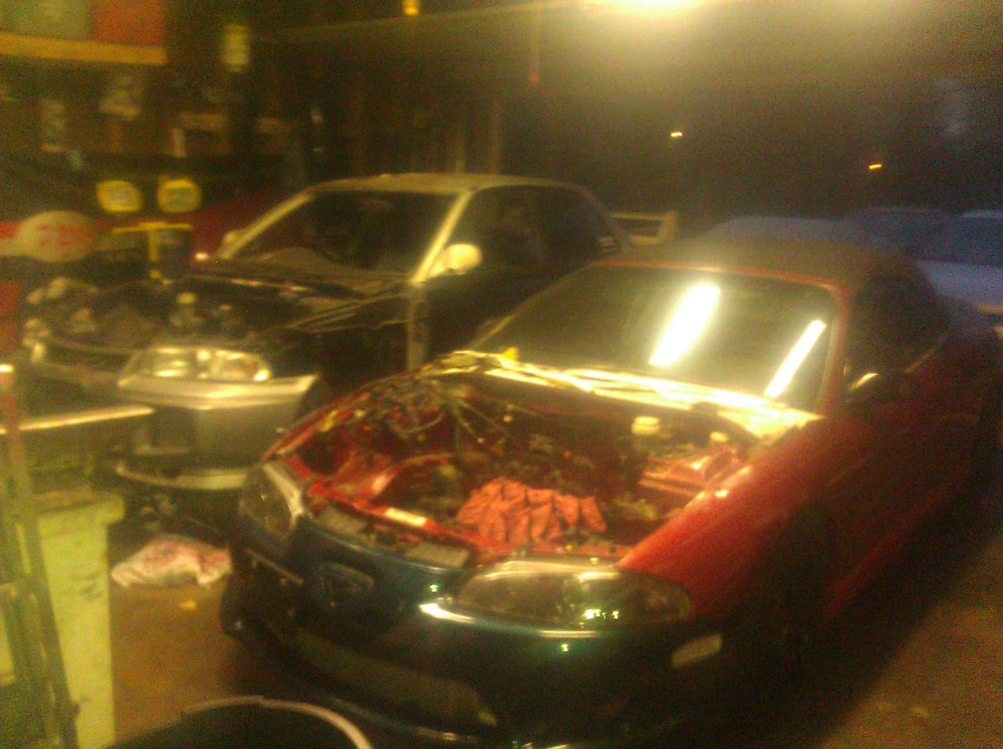

TkrPerformance 11-05-2011 07:54 PM
back in the garage for the night
http://i122.photobucket.com/albums/o...105_181327.jpg
