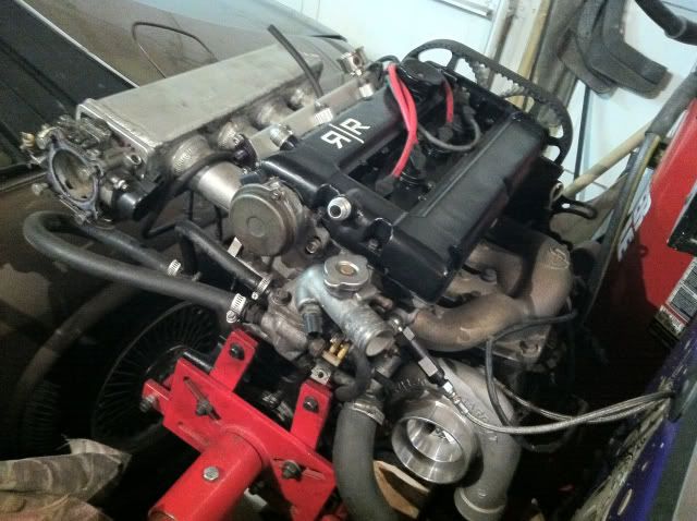

http://i6.photobucket.com/albums/y20...A/7e6b03e9.jpg
http://i6.photobucket.com/albums/y20...A/b9a25e56.jpg

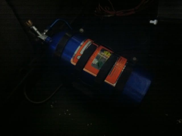

Still need to figure out a way to wire up my nitrous with the auto and mount it in the new car. I want it use it to get up on the converter, but also need to spray the whole pass. Need to do my research on this still.
http://i6.photobucket.com/albums/y20...A/0d75b0a1.jpg
Intercooler that was on the car (top) vs my tried and true SBR intercooler with some battle scars.
Also started pulling the tien coil overs off the black car to put on this pig.

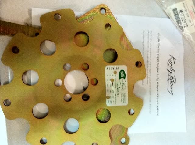

Kiggly parts showed up today :D
http://i6.photobucket.com/albums/y20...A/IMG_0711.jpg
Still need to figure out what I'm going to do on a converter and then get this sum bitch on the road.
Really need to get a tranny temp gauge though and a couple other little things but now I only need to figure out a converter and I can drive this pile.
Anybody know of any local places that re-stalls converters?
