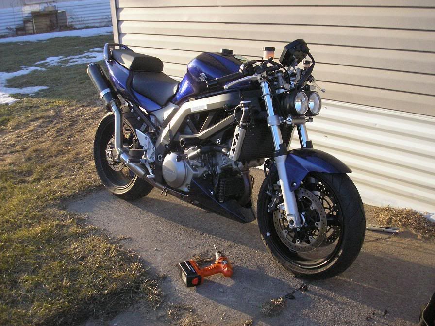

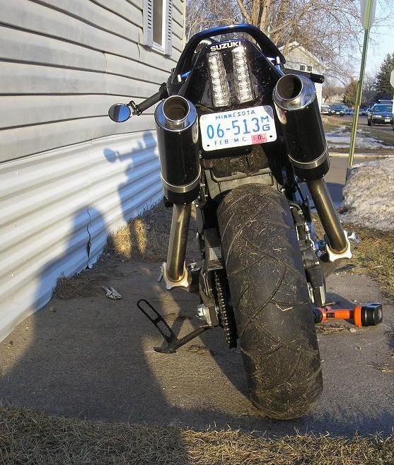

So I know this is a car this is a car forum, but I know there's a few people here with bikes, so I decided I'd make a project thread. As some of you may know, I just got a new Suzuki SV1000 a few months ago since my last one got stolen.
I've never really liked the way the fairing on the SV's look, so I decided to take mine off and make a naked style bike. I ended up taking off almost 15 pounds of metal and plastic off the front end. I didn't weigh the brackets, and new lights before I put it all on, but it can't be more than a couple pounds.
Another thing I did was gut the mufflers and cut them in half cuz the factory exhaust was way too quiet. I couldn't hear it at all at any speed above 50 mph, so that had to change. The reason I cut them in half, is cuz I kinda like the way a stubby exhaust can looks. The only thing with modifying the exhaust like that, is that it made it quite a bit louder than I would have thought it would be, so it looks like the first thing to be done this spring will be some slip-ons.
The last thing I've done so far is remove the stupid mudflap from the tail section, and make a bracket for the lisence plate and turn signals.
It's not totally finished yet, I'm gonna make a little flyscreen to cover up the wiring between the gauges and the new headlights, and put some frame sliders on it. I've also been considering painting the tank, and tail section white, and the chin spoiler and front fender black, I think that would make kind of a cool contrast, and I haven't seen too many white SV's around.
Anyways, that's my project, and here's some pics of it. Feedback is welcome :)

Super Bleeder!! 11-04-2007 06:10 PM
Re: Project Streetfighter
dude i LOVE the streetfighter look for bikes. The ktm superduke and Triumph speed triple are two of my favorite machines for sure.
I like the dual bulb arrangement you went with. You should remove the "handle slash wing" on the rear. It cleans up the look of the SV substantially.
get rid of the passenger pegs too! put em back on when a lady friend wants a ride or something.
Kevin 1G Drummer 11-04-2007 07:01 PM
The passenger pegs are the mounts for the exhaust cans, so I can't really get rid of those. A friend of mine has the handle removed from his SV, and I haven't really decided if I wanna take it off or leave it. One thing I forgot to mention is that it'll also be getting a seat cowl to clean the rear end up even more.
As far as factory streetfighters go, I really like the look of the Suzuki B-King http://www.cycleworld.com/article.as...article_id=298 and the Honda concept NAS http://www.sportrider.com/bikes/146_...nas/index.html The B-King is basically a re-designed Busa without the fairing.

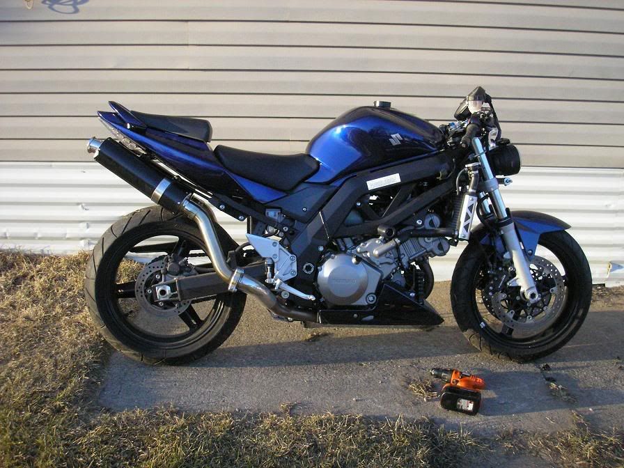

Kevin 1G Drummer 03-14-2008 08:33 PM

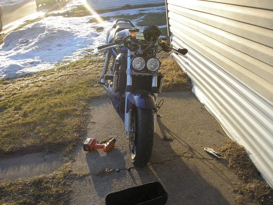

It's been pretty nice lately, so I've been putting a little time into this project. First off, I installed the new exhaust system and installed the new tail light
http://i250.photobucket.com/albums/g...spring08-1.jpg
The exhaust sounds amazing. Nice and quiet at idle, but crack the throttle and all hell breaks loose :D
Today I installed the new Buell headlight and got it wired in, put on the frame sliders, and bar end mirror. All I have left is to figure out how I'm going to make the brackets to mount the flyscreen, and cut up the stock windscreen.
http://i250.photobucket.com/albums/g...spring08-2.jpg
http://i250.photobucket.com/albums/g...spring08-3.jpg
http://i250.photobucket.com/albums/g...spring08-4.jpg

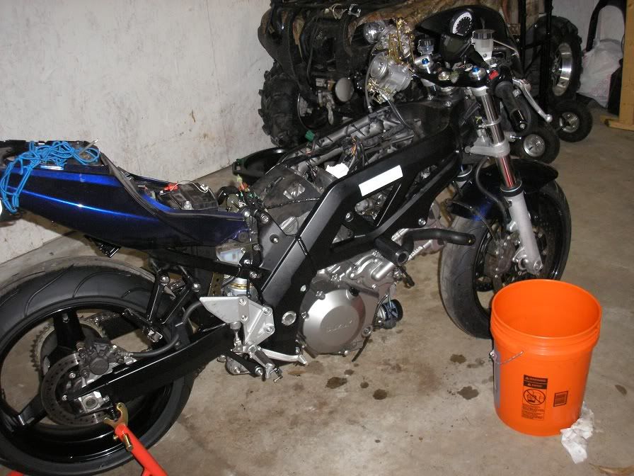

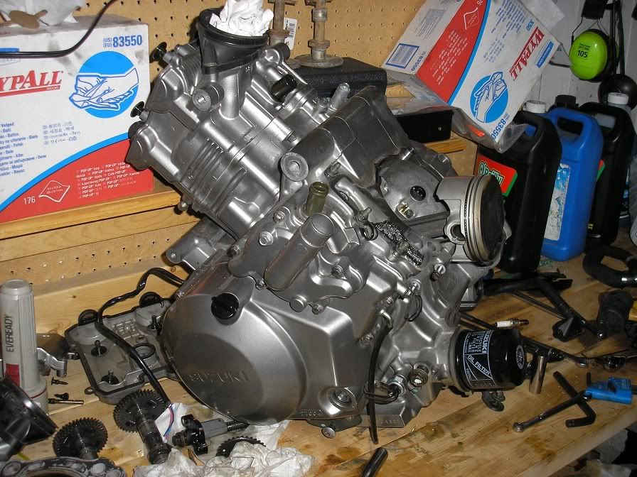

Kevin 1G Drummer 04-16-2011 05:54 PM

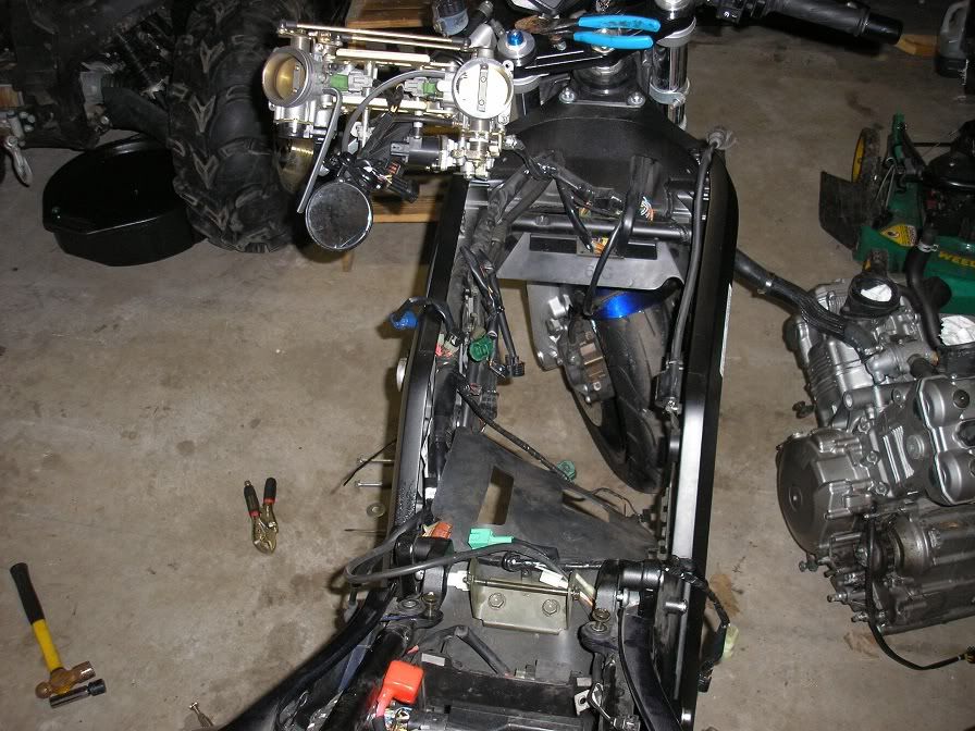

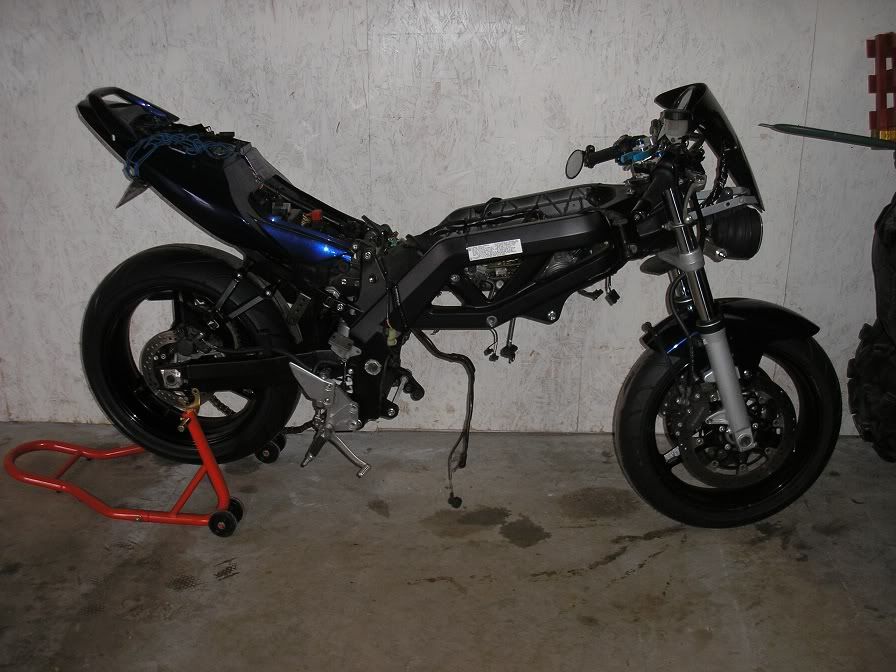

I started working on it today but since it's cold I didn't spend too much time on it, or put too much enthusiasm into it. Worked on it from about 10:30 till about 2:30
When I started on it the only thing off of it was the lower engine faring
http://i250.photobucket.com/albums/g...V/P1010590.jpg

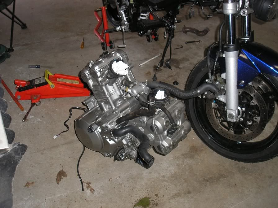

Pulled off the gas tank, both seats, exhaust, air filter box and throttle bodies, loosened the rear plastics for access to wire connectors, radiator, oil cooler, disconnected all the necessary wires, and loosened the chain to get it off the drive sprocket. All that's left is to take out the engine bolts and pull the motor out of the frame. Then of course tear the motor apart and see what needs to be replaced.
http://i250.photobucket.com/albums/g...V/P1010600.jpg
http://i250.photobucket.com/albums/g...V/P1010599.jpg
http://i250.photobucket.com/albums/g...V/P1010598.jpg
Kevin 1G Drummer 04-23-2011 11:56 PM

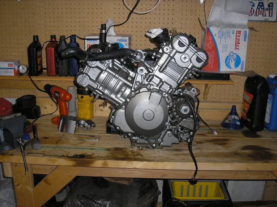

I got the motor out and half way torn down today, pics to come. Still not entirely sure what's making the noise but I'm leaning towards rod bearings. Both rods are on the same journal and there's a little side to side play on both rods which I don't believe should be normal. Hopefully I'll get a little more done on it tomorrow around dinner with the fam.

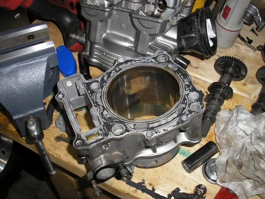

Kevin 1G Drummer 04-24-2011 10:07 AM

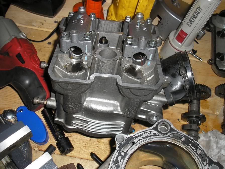

Thankfully nothing here locked up. I got lucky on a couple levels with this.
Anyways, here's pics of day 1 of engine teardown. about 2.5 hours worth of taking my time and making sure everything came apart right, nothing broke, and most bolts ended up back where they came from.
http://i250.photobucket.com/albums/g...V/P1010602.jpg
http://i250.photobucket.com/albums/g...V/P1010605.jpg
http://i250.photobucket.com/albums/g...V/P1010604.jpg
http://i250.photobucket.com/albums/g...V/P1010606.jpg
Front cylinder taken apart
http://i250.photobucket.com/albums/g...V/P1010607.jpg
http://i250.photobucket.com/albums/g...V/P1010608.jpg
http://i250.photobucket.com/albums/g...V/P1010609.jpg
http://i250.photobucket.com/albums/g...V/P1010610.jpg
Rear cylinder taken apart
http://i250.photobucket.com/albums/g...V/P1010611.jpg
The end of the first day
http://i250.photobucket.com/albums/g...V/P1010612.jpg
All that's left is to remove all the stator stuff, clutch stuff, the drive gears between the crank and trans, and split the case.

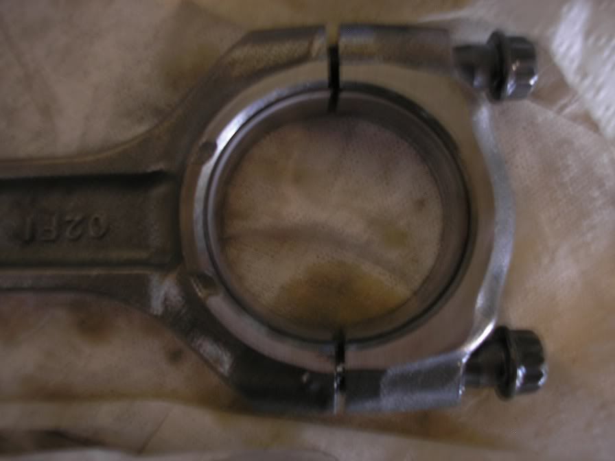

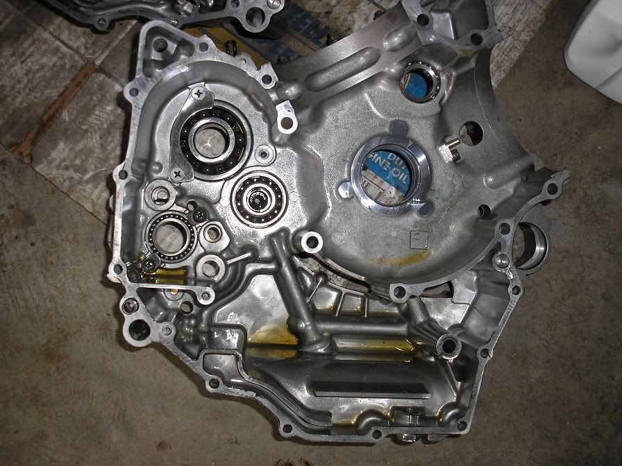

Kevin 1G Drummer 05-07-2011 09:11 PM
Well, I finally got the case split today. It's for sure spun rod bearings. The mains and all the trans bearings are just fine, and the rods are barely damaged at all. I can't feel any of the grooves, but they look pretty bad, and the bearing for cylinder #1 is turned just a little bit in the rod and cap. I think I should be able to get away with just getting the crank polished. There is no scoring at all in it, just some light marks that are only visible, not able to be felt at all.
Here's some carnage pics!
Half of the case and the trans gears
http://i250.photobucket.com/albums/g...V/P1010613.jpg
the other half of the case
http://i250.photobucket.com/albums/g...V/P1010614.jpg

rod number one
http://i250.photobucket.com/albums/g...V/P1010623.jpg
http://i250.photobucket.com/albums/g...V/P1010624.jpg
http://i250.photobucket.com/albums/g...V/P1010625.jpg
