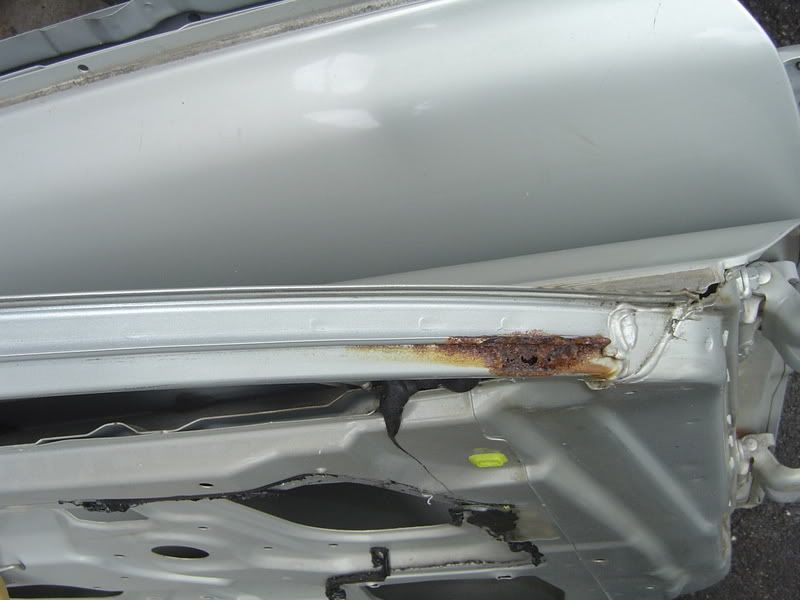

here is why they are getting replaced

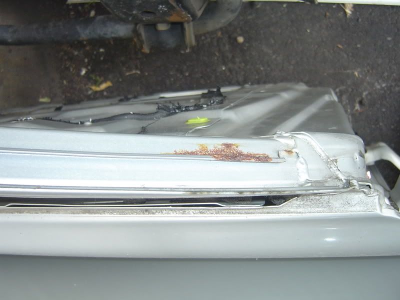

http://i122.photobucket.com/albums/o...evo/evo019.jpg
http://i122.photobucket.com/albums/o...evo/evo020.jpg
I can fix the dents in the new doors but it is not worth it trying to fix the rust on the bottom of the doors that were on the car

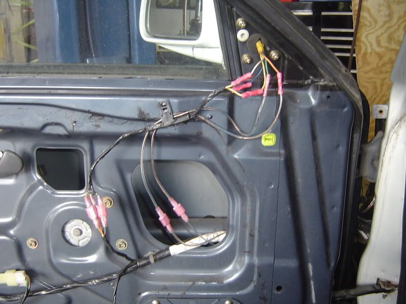

TkrPerformance 06-11-2007 08:48 AM
Re: the evo 3 swap parts are coming
that is what I have been doing
I have the locks working the same way now the fronts would unlock and the rear would lock when you pushed the button. All the windows work right now just wating on the 3 new window regulators to show up sence the gears on the ones that I have are to far gone to use the window too much. Also got the mirrors to work and the power folding part also on them.

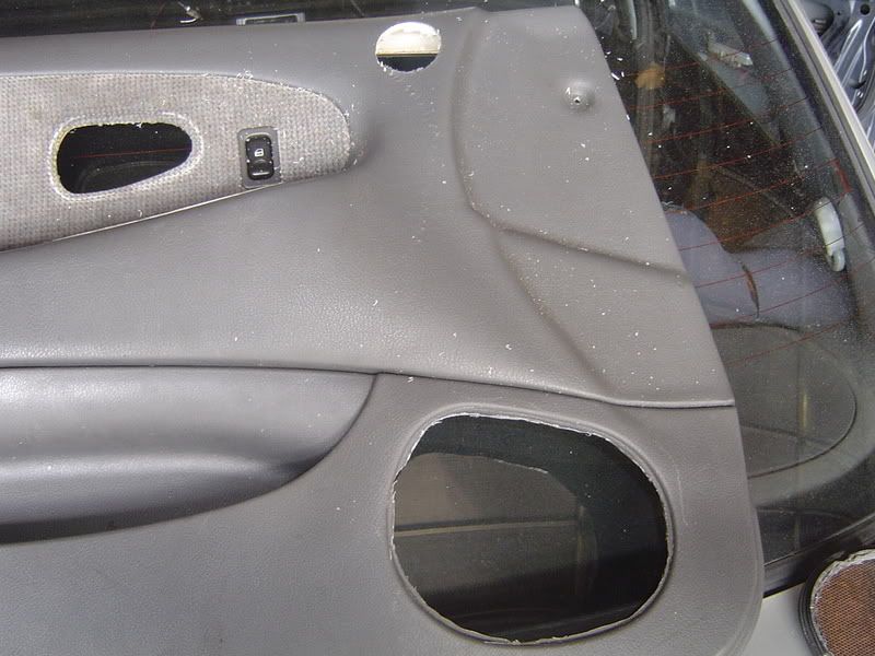

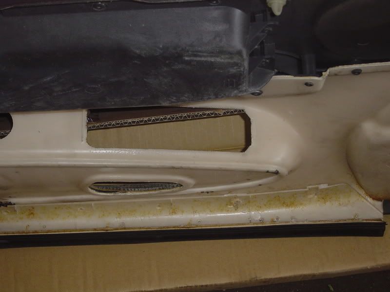

TkrPerformance 06-11-2007 06:04 PM

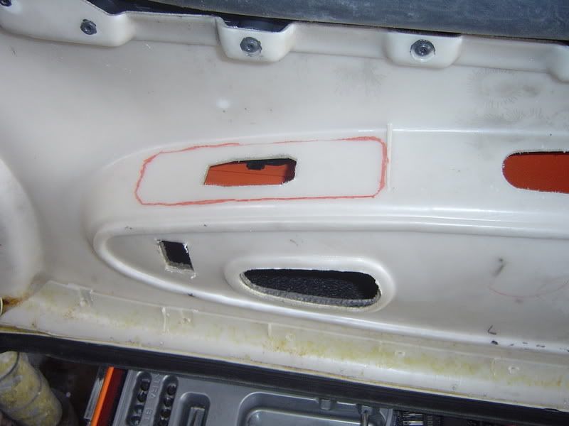

some of the fronts

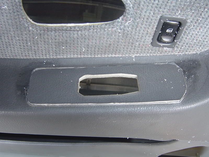

door panels were cut for the speaker holes and tweet holes and the drivers door was cut for the main switch panel and the cut out pice was glued into the pass door for the 1 switch and the door lock switch was put in the pass door also. Got all the wiring figured out for the power folding mirrors just had to add 2 wires to make them fold in and out.
http://i122.photobucket.com/albums/o...evo/evo021.jpg
http://i122.photobucket.com/albums/o...evo/evo022.jpg
http://i122.photobucket.com/albums/o...evo/evo026.jpg
http://i122.photobucket.com/albums/o...evo/evo027.jpg
the mirror wiring and the 2 rusty front doors that came off
http://i122.photobucket.com/albums/o...evo/evo025.jpg
http://i122.photobucket.com/albums/o...evo/evo023.jpg
http://i122.photobucket.com/albums/o...evo/evo024.jpg
