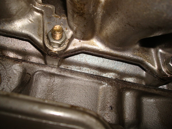

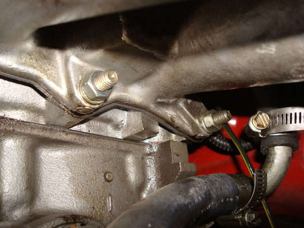

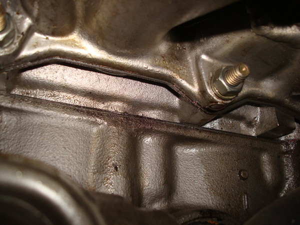

And I looked into my coolant pushing problem today and I think I found the problem.
Here's left to right under the intake manifold:
http://www.mitsustyle.com/photopost/...m/DSC02982.JPG
http://www.mitsustyle.com/photopost/...m/DSC02984.JPG
http://www.mitsustyle.com/photopost/...m/DSC02985.JPG
the head gasket looks delaminated right there, and I'm pretty sure it has to be coming from there since there was coolant all over the lower part of the intake manifold and everywhere on the engine crossmember, motor mount, frame rail, etc.
So, I asked around and my best bet for holding big power is to take the block out, completely strip it down and get it o-ringed.

I finally got the engine out after struggling yesterday. I had to use a 1/4" ratchet with an extension through the clutch fork hole to take all the pressure plate bolts out of the flywheel. The motor and tranny wouldn't separate because the pilot bearing was stuck on the input shaft and the clutch splines are smaller than the OD of the bearing. So, got it apart today and took the head off the engine. The head gasket wasn't really blown, but you could clearly see on almost every cylinder where the head was lifting and leaking horsepower. I'm pretty excited for the o-rings now, and the cheap head gaskets I can use!!

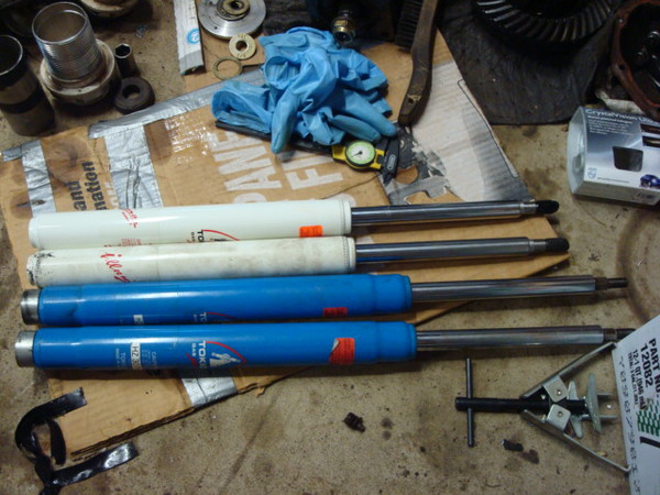

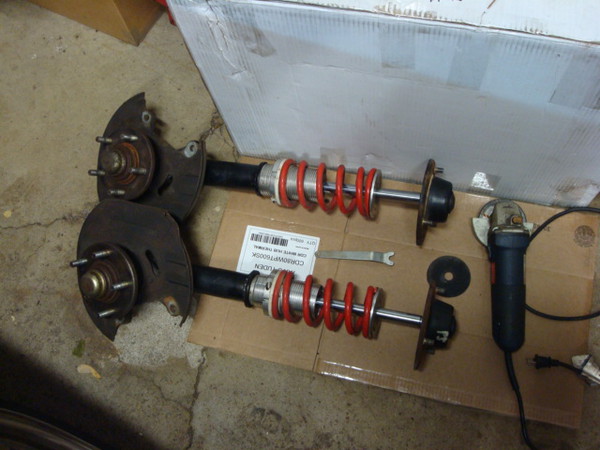

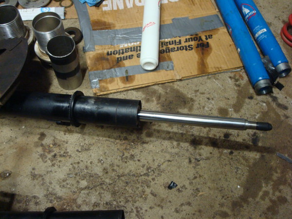

Well you all kind of know where my car was at until a couple days ago. I had a blown passenger side front shock so I bought some Tokico Illumina 5 way adjustable shock inserts for the rear of a second gen MR2. They are shorter than the stock ones by quite a bit and the stock replacement tokico blues that I had were even too short for the housings (see the spacers on the bottom of the blue ones?).
http://www.mitsustyle.com/photopost/...m/DSC03219.JPG

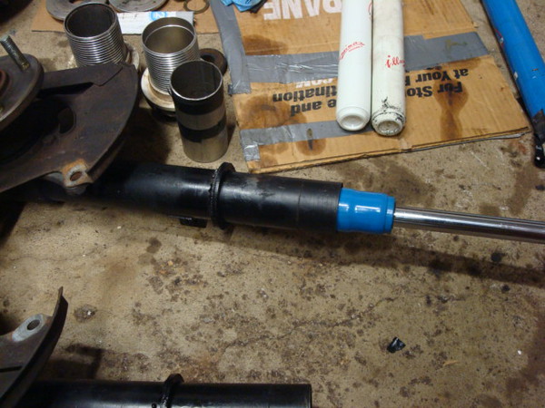

So I cut off the stock spring perch and cut a 62mm section out of the middle of the shock housing, then welded it back together, adding a steel ring around the body to serve as a base for the sleeve coil over.
http://www.mitsustyle.com/photopost/...m/DSC03220.JPG
http://www.mitsustyle.com/photopost/...m/DSC03221.JPG
http://www.mitsustyle.com/photopost/...m/DSC03222.JPG
So the car has a static (almost) 2.5" drop if the springs stayed where they are. It allows the car to be slammed and still have suspension travel, which might be what killed my old shocks. That or the scores from trying to hold the shaft with a pliers (like an idiot).
Anyway, I'll get these on the car tomorrow and see how low it can go. My plans for the car right now are re-do the exhaust so it doesn't sag, install an idle control motor so any dummy can drive it like it was a normal car, install the good torque tube I have for it, tune up the brakes, and for asthetics, get new front tires that match the rears better. Another muffler might be in the works also. So I will take some more pictures when those things happen, but for now the new shocks should be awesome, and the ability to lower the car another 3" from where it's at will require some camber plates and hopefully some roll center adjusters.

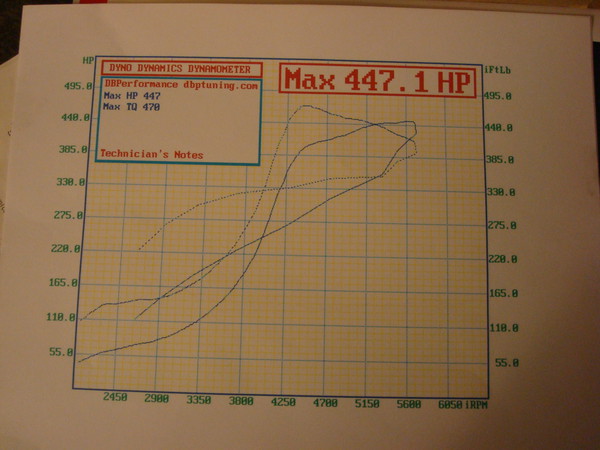

Well, I had already gotten pretty bored with it. Didn't spin in 2nd unless it was cold, or there was cement, or it was wet out, or if I dropped the clutch, or if I was turning a corner. So, now it should do that. Here's the results from today, with a couple pictures to do the talking.
First:
http://www.mitsustyle.com/photopost/...m/DSC03255.JPG
Then adding a pound:
http://www.mitsustyle.com/photopost/...m/DSC03254.JPG

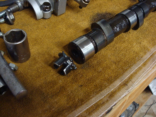

And as you can see there was a problem, which is shown below:

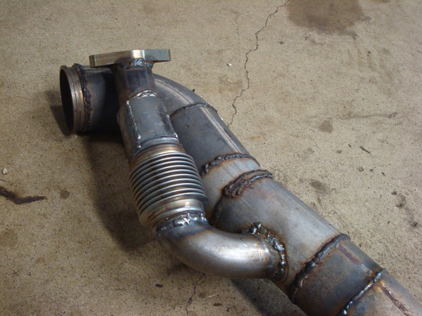

http://www.mitsustyle.com/photopost/...m/DSC03253.JPG
Also fuel pressure was dropping on that last pull, so the pump is probably done flowing. I had all kinds of little issues like this. The idle control was difficult to get right, and it's pretty nice, but has a little random surge, you should hear the camming though. Not like an evo, but pretty wicked for a quest. The blow off valve has an o-ring on the plunger that broke and was holding it open, so after ripping that out it leaked just a tiny bit, but the next run was more power and more awesome. Then my crappy welds broke and ended the fun, but nothing is mechanically wrong otherwise. Gaining about 15hp per psi, so by that math at 30psi I'd be around 510whp.
Given the clutch's rated capacity of about 545 torque, I'd be pushing it at 500+. Not only that, but the rods, transmission, u-joints, all that stuff. But with the out-of-steam pump, the 1000's that were at 92% and broken CAS drive, more than 450 isn't really in the cards. And holy crap. 450whp. I'm flabbergasted.
