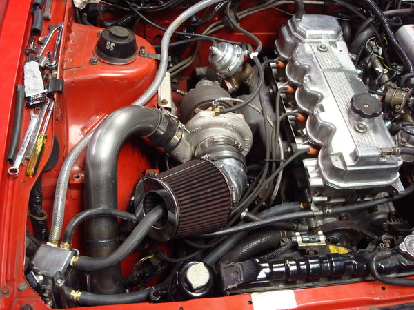

Well, I was going to get some tuning done tomorrow, but there is still way too much to do before then, so I cancelled. But at least I got the catch can shit done.
http://www.mitsustyle.com/photopost/...m/DSC02652.JPG
Thanks Scheides for telling me where to get this thing.

goodhart 04-07-2009 10:20 AM
Re: Turning my quest into a dsm.
Wow, theres like a bagillion hoses comin off that catch can! Whats the one going into the air filter for?
It's looking good though!
FattyBoomBatty 04-07-2009 10:54 AM
That's for a little suction. It's pretty much the only outlet for crankcase pressure. In the future I'll give it a buddy and maybe do a pan-e-vac in the exhaust. That's if I determine that there's little to no oil coming out the top side port.

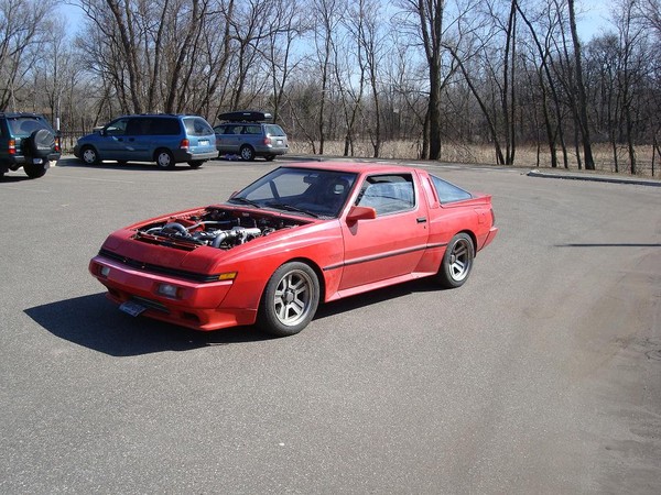

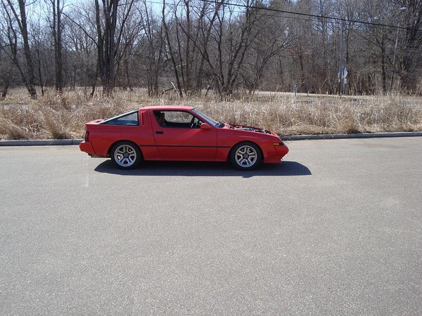

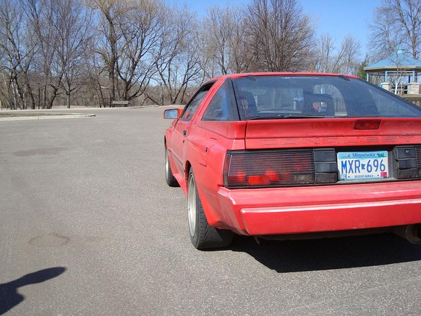

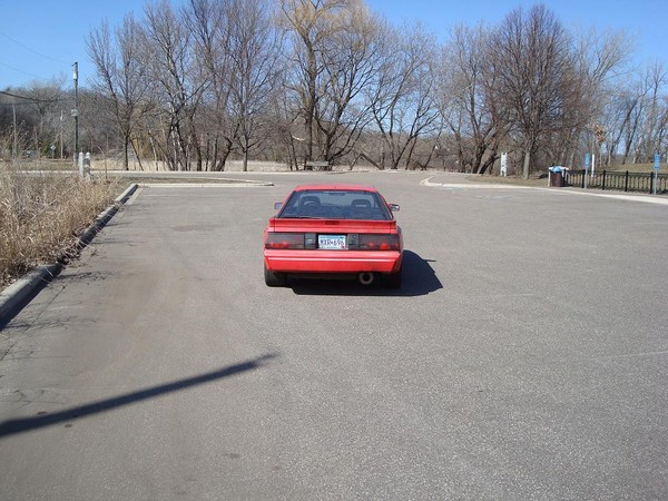

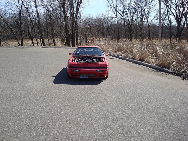

FattyBoomBatty 04-09-2009 09:42 PM
Dirty, and I tried a new radiator plug, It may have fixed the problem.
It needs a couple more little things, but at this point they are almost non-issue things like interior bits.
http://www.mitsustyle.com/photopost/...m/DSC02662.JPG
http://www.mitsustyle.com/photopost/...m/DSC02663.JPG
http://www.mitsustyle.com/photopost/...m/DSC02664.JPG
http://www.mitsustyle.com/photopost/...m/DSC02665.JPG
http://www.mitsustyle.com/photopost/...m/DSC02666.JPG
Halon 04-09-2009 09:51 PM
sweet!
FattyBoomBatty 04-09-2009 10:03 PM
I pulled into that parking lot and this lady with like 3 or 4 rug rats playing on the playground was staring at me like I was satan or something. Probably thinking, "damn loud ass car, get out of here before it explodes and kills everybody!"

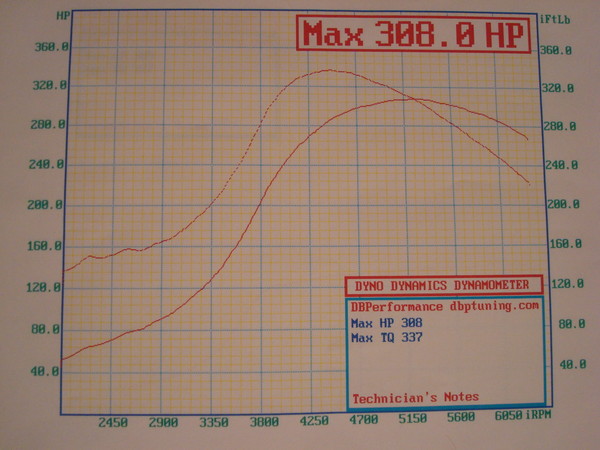

FattyBoomBatty 04-23-2009 12:31 AM
Re: Dyno Day Graphs, Pics and Vids! Post them here!
http://www.mitsustyle.com/photopost/...m/DSC02683.JPG
This is me on the 20th. Big thanks to Shane at DB for tuning it. I will be headed back once I get an idle control motor hooked up somehow.

scheides 04-23-2009 09:36 AM
Moved these from the old dyno day thread you posted in....that thread was for the dyno day from who knows when! LOL!
So, how much boost is this? Pump gas still? Looks like good power to me!

FattyBoomBatty 04-23-2009 10:56 AM
It peaked at 17.5psi right at redline, but it was pretty steady from when it spooled to redline. There was pretty much no knock on the dyno, and the only problems were that the injector clips (plugs) were popping off.
It's funny now, but on the dyno, when that happened it sounded like a really bad misfire, then when it came to idle it sounded exactly like a WRX. I heard that sound before when I blew my engine, and the plugs that most easily came off on the dyno were the same cylinders I had major damage to. So I think I found the main culprit of engine destruction.
I wonder if it'd do 20psi on 92 octane. I guess I don't see why not since it didn't show signs of problems other than the clips. But as you can see in the graph, the head really doesn't like to flow much past 5500rpm or so. Maybe I'll pull a Ben Stiller from Happy Gilmore and tell it, "you will flow more, or I will make you flow more."
scheides 04-23-2009 11:53 AM
20psi should be no problem. 3psi on that turbo might yield you another 40whp, so it'd probably be worth it :)
