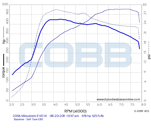

PlanoEvo 08-21-2011 01:41 PM
Re: SE take two!
yeah the graph from last week is all jagged not pretty and smooth. But went from 449hp last week to 478hp I bumped my timing up 3 degrees and made some slight afr changes mainly in the midrange. Boost remained unchanged from the previous week 28psi at peak torque and 23 at peak hp.Measured Intake air temps were 115+ as air in the dyno room was close to 100F.

PlanoEvo 08-23-2011 10:51 PM
Re: SE take two!
1 Attachment(s)
Results! Be kind self tune Attachment 11927
Boost was tapering bad 23psi at peak hp
scheides 08-23-2011 10:55 PM
Re: SE take two!
25psi before 3500rpm woot! Goddamn you must just be in heaven, this is a fukin rip of a setup!
PlanoEvo 08-23-2011 11:08 PM
Re: SE take two!
Hell yeah!!! I just tightened the wga tonight so hopefully it will hold more up top. Then I'm gonna need more fuel and hopefully I can get it somewhere like 32psi tapering to 28-30 that should easily make over 500whp and probably close to 500wtq!!!!!!
PlanoEvo 08-23-2011 11:11 PM
Re: SE take two!
Actually 26psi at 3500rpm you can go th cobb online and look at the dyno database and look under Evo IX and Andrew Kereluk and see all the details.It builds boost so fucking fast sometimes I wonder what it would be like with the EF4

Kracka 08-24-2011 08:42 AM
Re: SE take two!
Great results so far Andrew, the progress you made in a week was awesome! This turbo definitely had 500+ in it, and I'm sure you'll be there come the NTEC fall dyno day.
Kevin 1G Drummer 08-24-2011 05:06 PM
Re: SE take two!
Damn... That thing has to hit like a freight train at spool-up.
goodhart 08-24-2011 05:15 PM
Re: SE take two!
That friggen boost line just goes straight up!! Awesome setup you got yourself there man. Enjoy it!
PlanoEvo 08-25-2011 01:55 AM
Re: SE take two!
Yeah before I do a pull it damn near has to be wide open because it reals shit in so fast.On the ntec cruise several people in front of me started a pull on a long straight and I was holding back because I knew and my wife turned and said "come on gas it their getting away" and I said hold on let them get a little farther and I gunned it and came up on them so fast it freaked her out!
