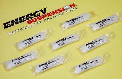

Rmondoh 12-13-2010 12:22 AM
Re: Deadmau5X: MOAR Mods 'N Stuff
1 Attachment(s)
That's my lube and there's plenty more of it to go around. ;)
The grease that came with the Perrin sway bar is Energy Suspension Formula 5 Prelube. It doesn't feel like the grease that came with the Whiteline bar nor the grease Hughes and I have. This stuff feels like thick maple syrup.
http://www.mitsustyle.com/forums/att...1&d=1292217627
