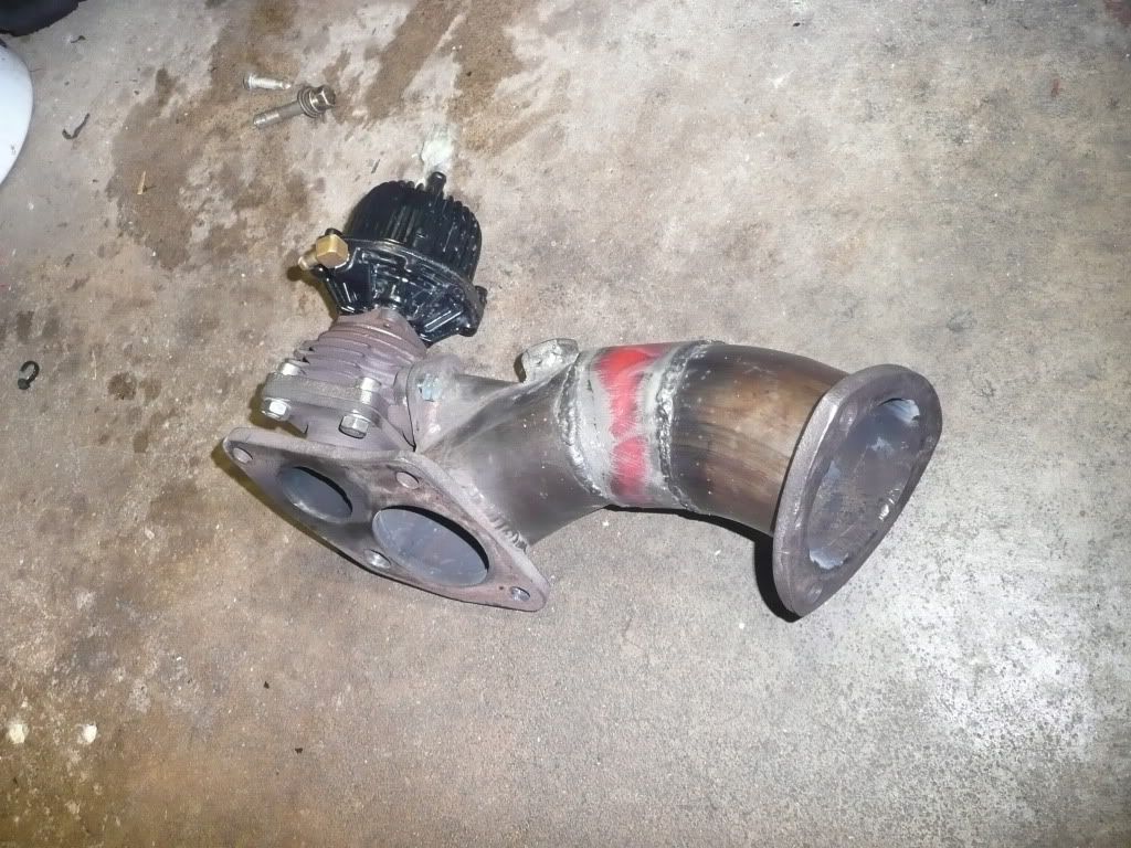

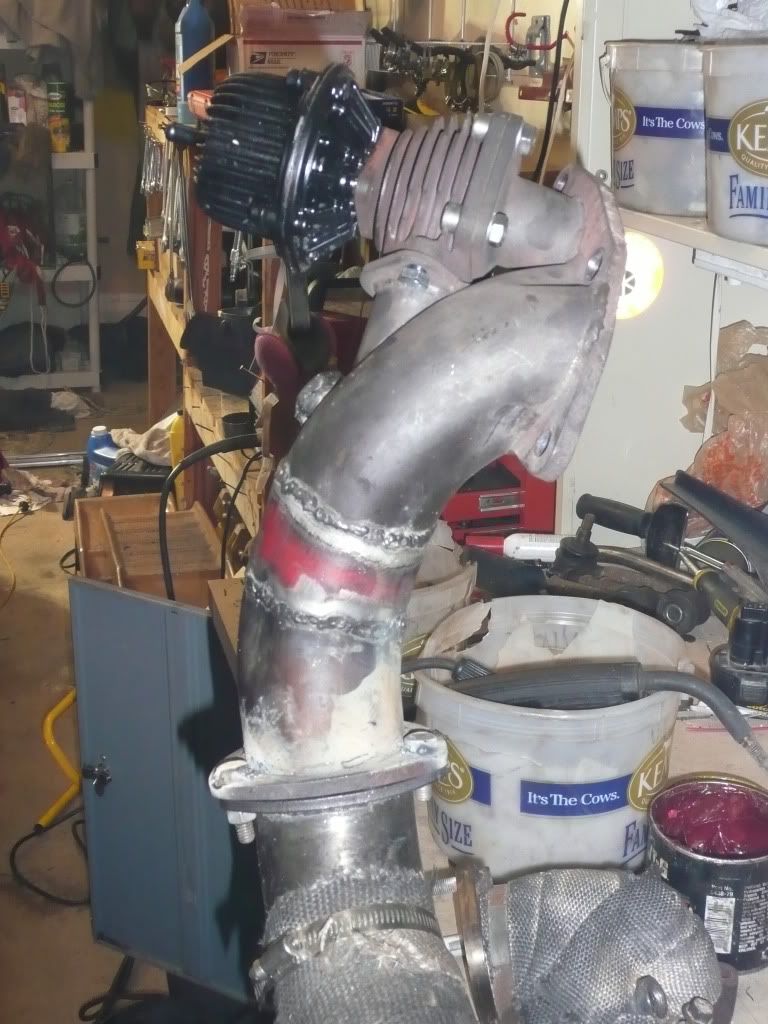

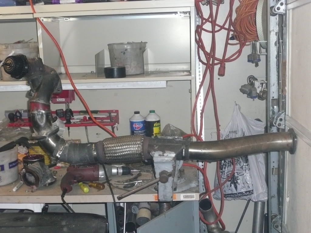

So I started with the o2 housing. Right away I noticed a problem. The flange hit the LICP and the oil filter. My solution was to add about 2" so the flange sat lower and that gave me the clearance I needed. I also was able to get a better angle on it to bolt up to the downpipe.
http://i224.photobucket.com/albums/d...0/P1030038.jpg
Next was my downpipe. My downpipe reduced down to 2.5" like most do to bolt up to the o2 housing, But mine is 3" all the way through. So I used the new 3-bolt flange I got from mark and after measuring 15 times and cutting twice ;) I was able to weld it up.
http://i224.photobucket.com/albums/d...0/P1030041.jpg
You can also see I dented the o2 housing so I can get the oil filter off. It's a tight fit.
http://i224.photobucket.com/albums/d...0/P1030040.jpg
Then I welded some bolts to act as studs to make the install MUCH easier. Here is a pic to show off my s1ck gas-less mig welding skillZ. :guns:
http://i224.photobucket.com/albums/d...0/P1030036.jpg

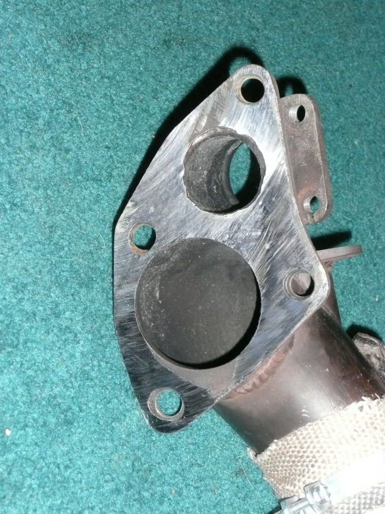

After getting everything back together and started the car. I got to hear the sweet sound of exhaust leak coming from the o2 housing. So I had to take everything off just to find out the o2 housing surface was completely warped.
Big thanks to Mike (CarPsyco84) he was able to get the surface as straight as possible. WAY better then it was before. It used to actually rock back and forth on the turbo.
http://i224.photobucket.com/albums/d...0/P1030047.jpg
Now I'm gonna be picking up a new o2 housing gasket from map and then I'll be able to bolt everything back together. I'm also looking for an FP exhaust manifold to replace my DNP since I wont need to run a spacer with it. If I don't find an FP manifold soon then I'll just stick with the DNP for now and enjoy the setup.

Were you having O2 housing sealing problems before? That flange is too thin, would be very prone to warping. Looks like you guys got it flatten out though.
4g63tcrazy 02-11-2010 12:03 PM
Re: 4g63tcrazy's new setup for 2010
I couldn't tell you. I've never ran any of these parts before. If it warps again I'll just buy the flange and cut this one off and weld a new one on.

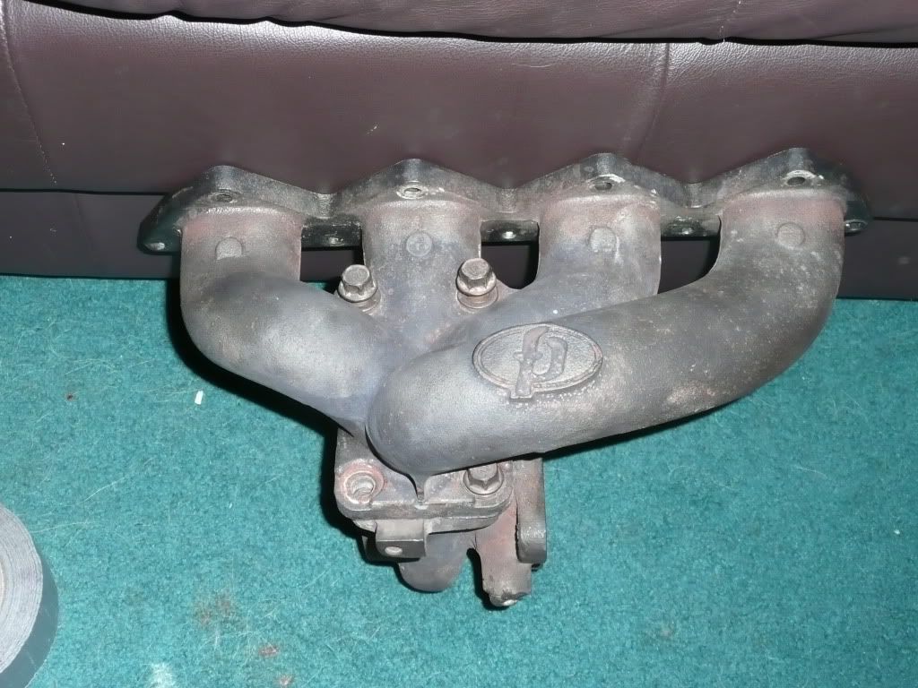

Just got a FP manifold and heatsheild for a great deal! Probably won't use the heatsheild since I don't like the way they look. The plan is to get it ceramic coated black like the DNP mani.

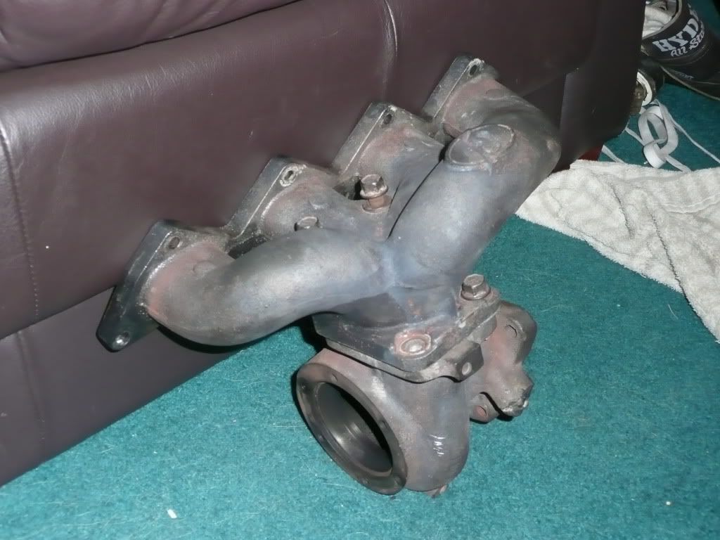

4g63tcrazy 02-24-2010 10:05 PM
Got my FP manifold today. :) Gonna drop the manifold and exhaust housing off at Primo to get ceramic coated. Still decided if I should do the o2 housing as well..

goodhart 02-24-2010 10:26 PM
I would coat the whole works, that's what I'm having them do on my new setup. Otherwise the o2 housing just looks ugly and out of place ya know?
