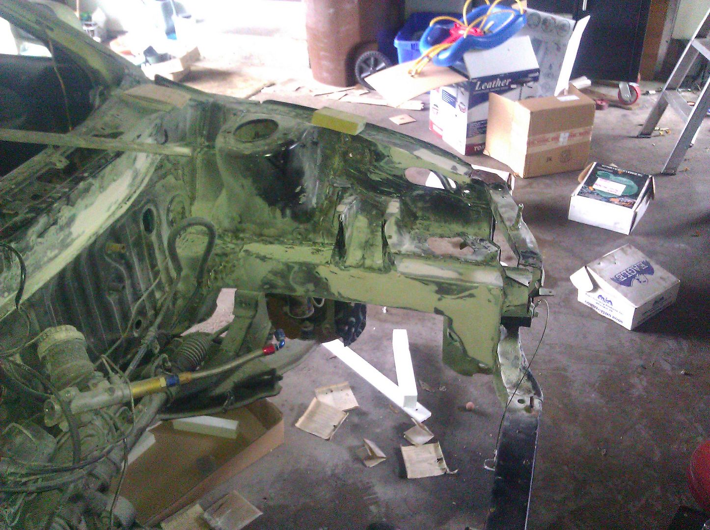

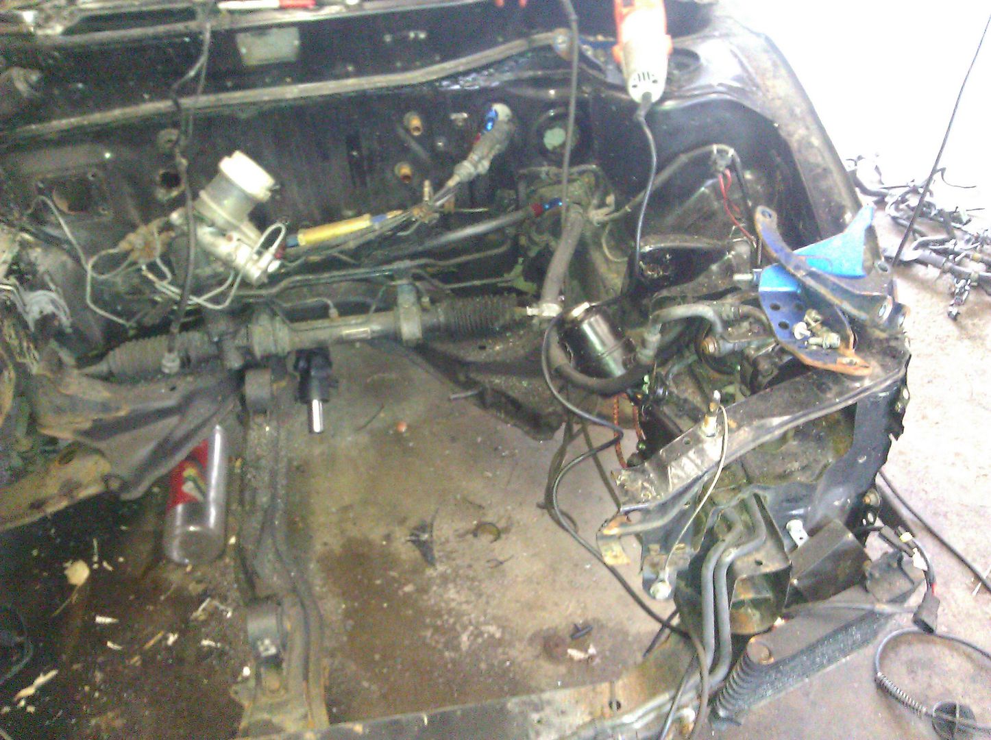

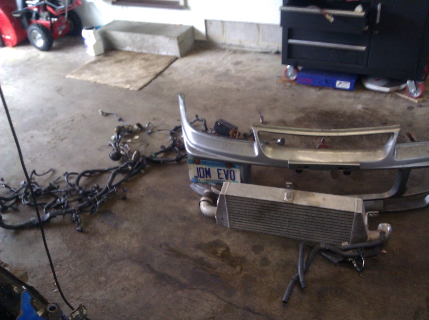

took the engine harness out so I can take it all apart and shorten up wires and reloom the full thing and get it tucked. Also got the engine bay harness out so I can get the other one that I took all the extra wiring out of that was not needed. One of the nuts came off the front bumper bracket and had to cut a hole in the frame rail to get the bumper off the car.
http://i122.photobucket.com/albums/o...421_153841.jpg
http://i122.photobucket.com/albums/o...421_153858.jpg

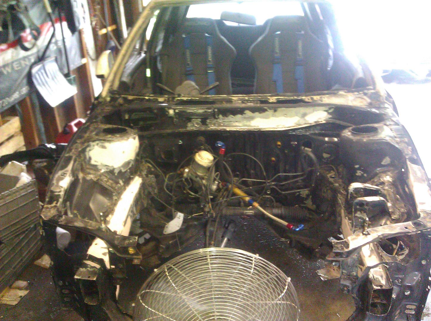

started on the right side of the engine bay. Took out the cusco brake stop bracket,brake booster,clutch master,line and slave.
Then I went after the body glue with the torch and then the wire wheel to get the car ready to seam weld the car to make it stiffer. Also wire wheeled all the bolt holes that are not need on the frame rail.
http://i122.photobucket.com/albums/o...421_153830.jpg

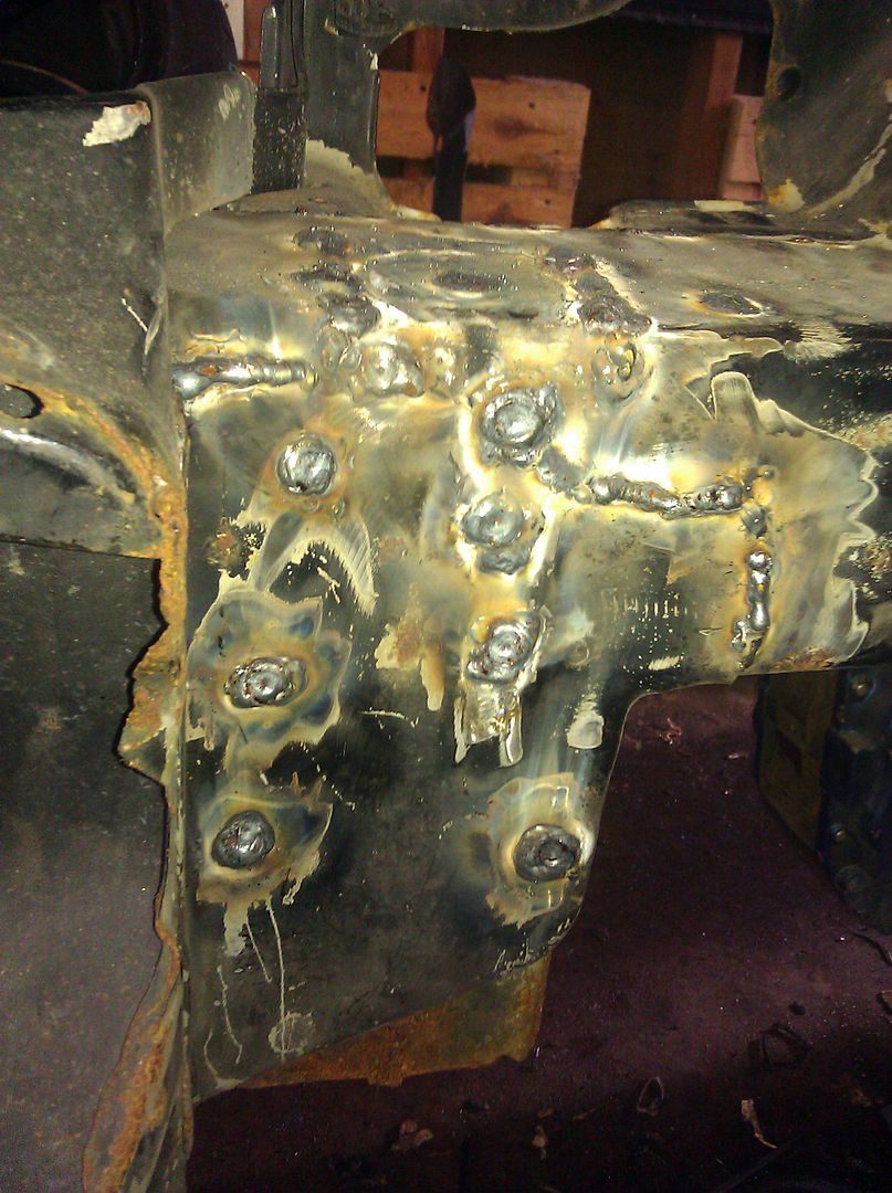

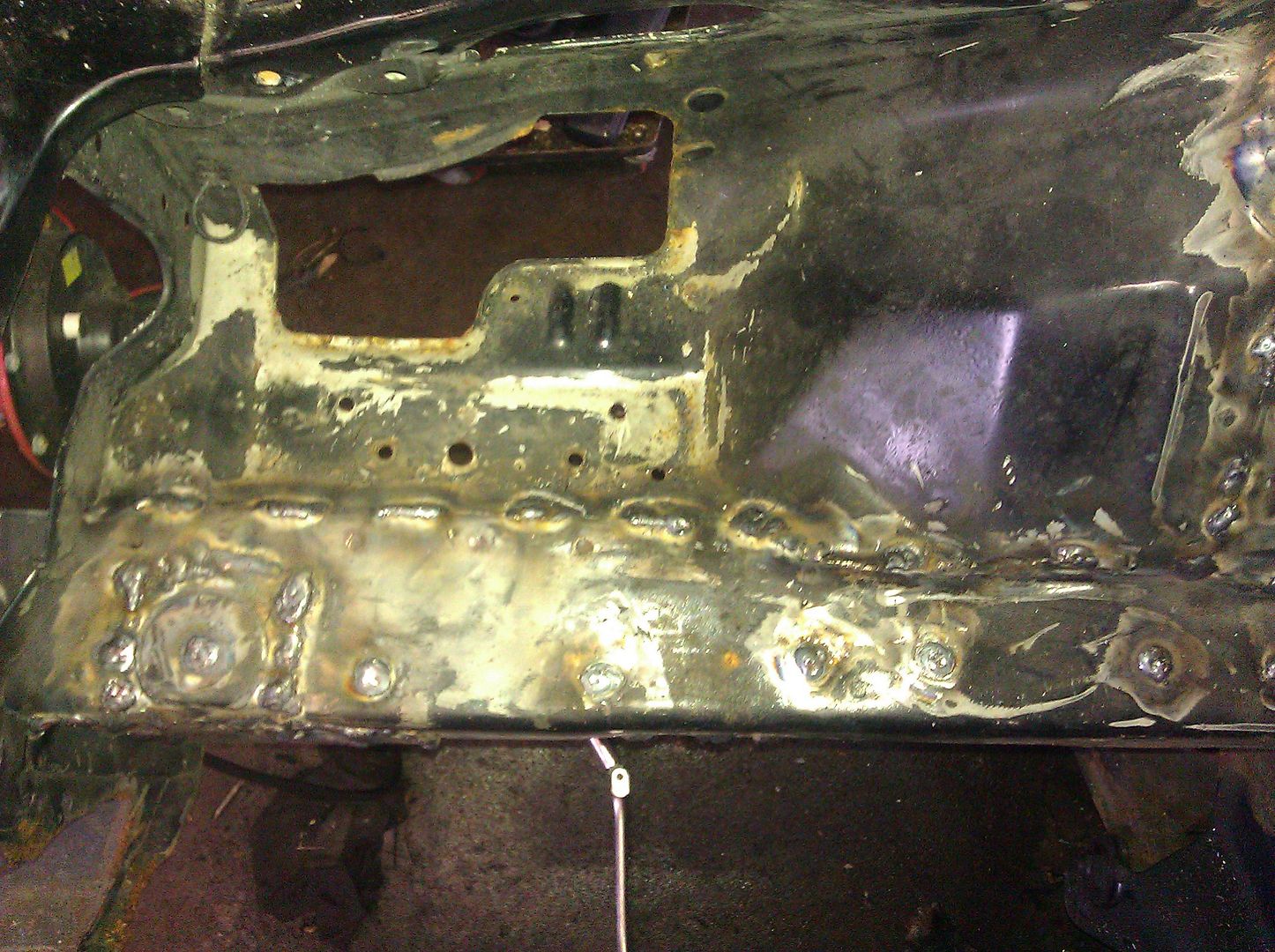

got all the bolt holes welded shut just have to go after them with the flapper disk to make them look better.
http://i122.photobucket.com/albums/o...421_174312.jpg

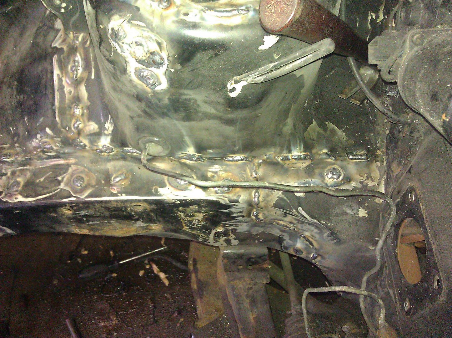

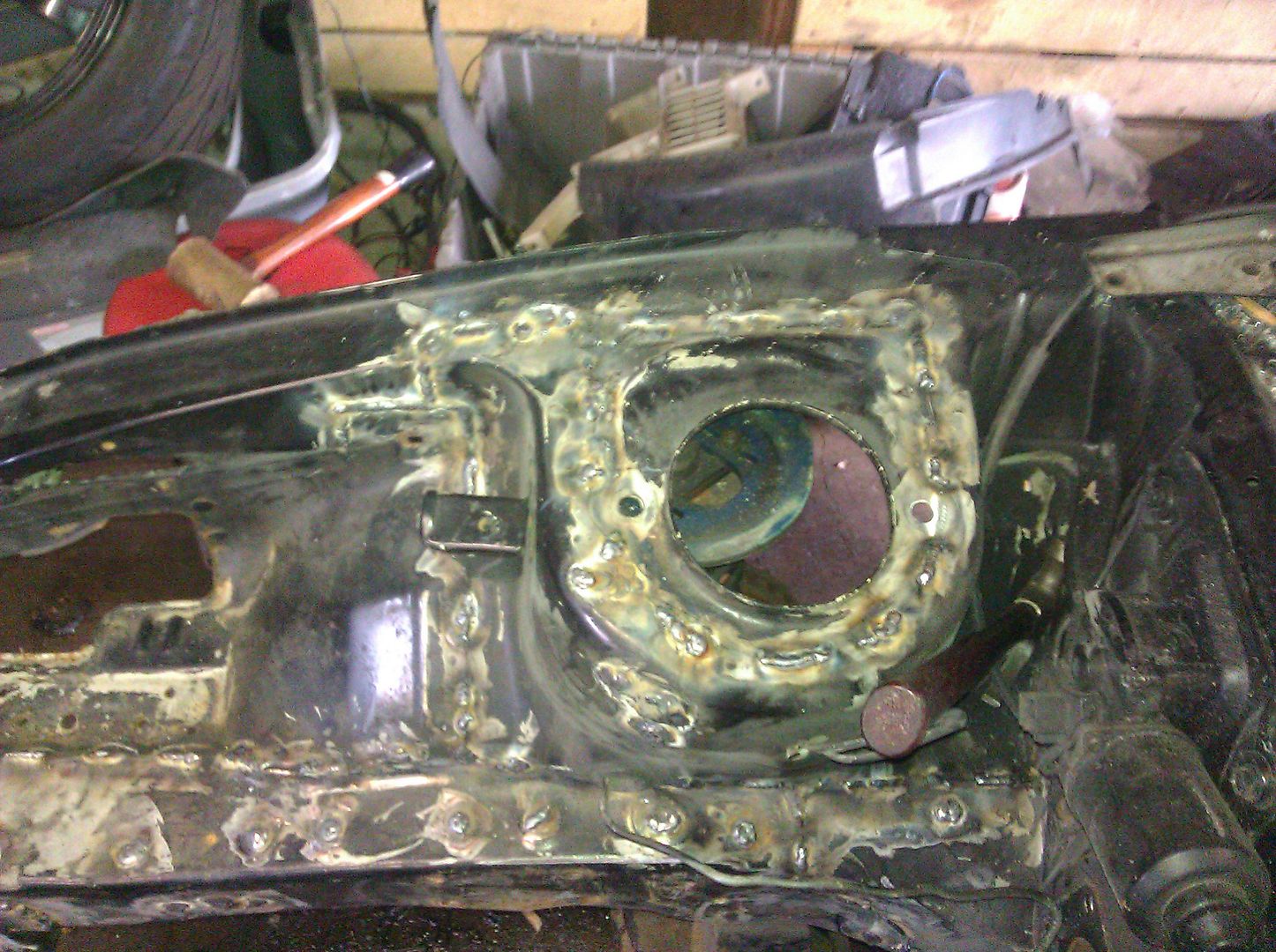

Also got the full right side seam welded up
http://i122.photobucket.com/albums/o...421_174323.jpg
http://i122.photobucket.com/albums/o...421_174332.jpg
http://i122.photobucket.com/albums/o...421_174338.jpg
just have to seam weld the left side,weld the bolt holes on the left side. Also have to weld the the bolt holes on the fire wall shut

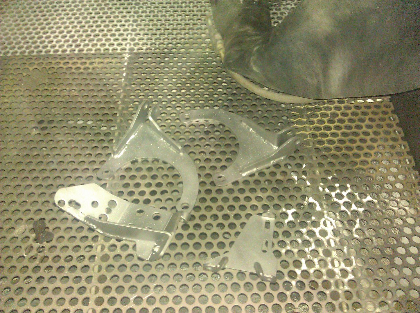

Brought the cusco brake stop and strut bar mounts to work today and blasted them so I can repaint them on wed.

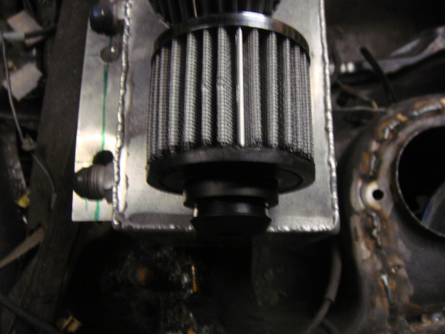

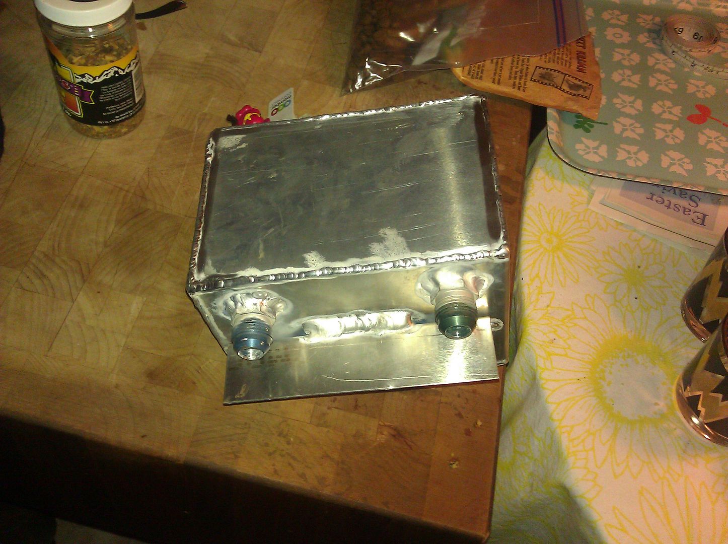

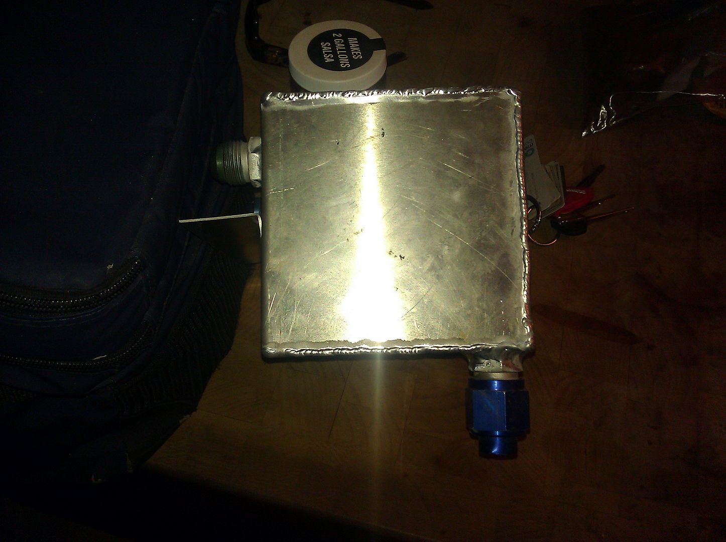

Work was slow today so we looked through the aircraft alum and s.s. Scrap bins and got some 6061 alum and found a few 10am fittings for a oil catch can. Also got some 304 half hard s.s. To make a battery box. We finished up the oil catch can to night and got the battery box all bent up just have to Finnish it up tomorrow. It needs the ends and to be tiged.
Here is the new oil catch can two 10am in and a 10am drain line. Just have to get craig to get me a pair of k&n breather filters for v8 valve cover. An drill the holes in the top for them.

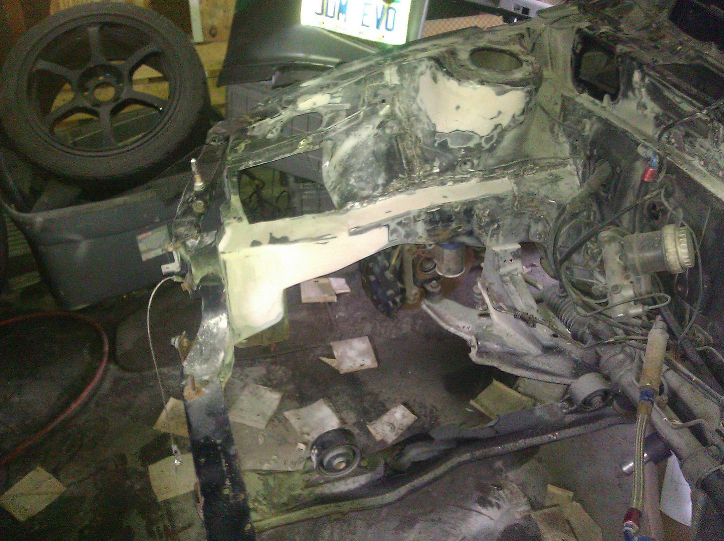

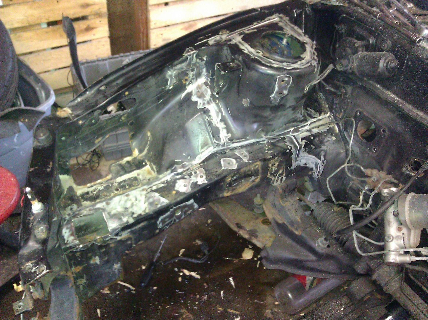

got the left side all done yesterday. got the body filler on just have to sand it down tomorrow. Then to prep the rest of the engine bay for paint.

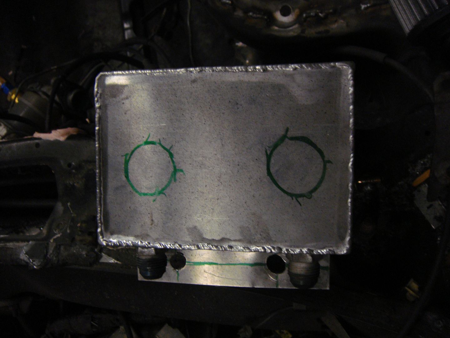

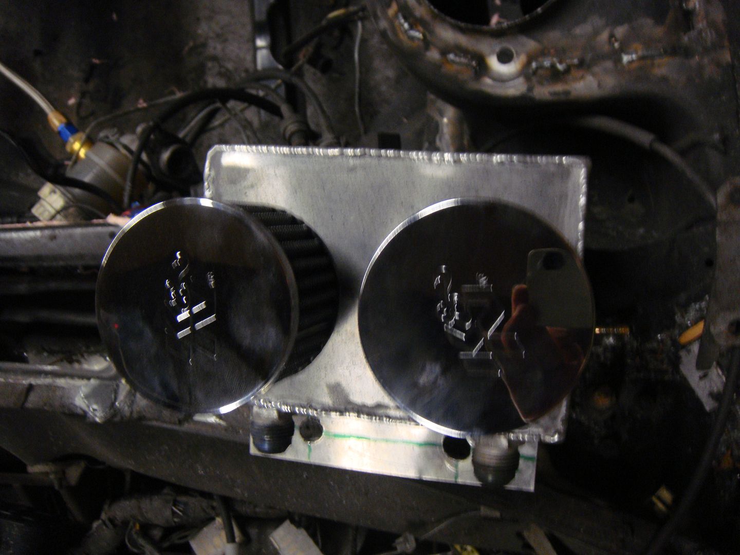

got were the new catch can will sit so I could mark out the two K&N filters my bro got me for my b-day
http://i122.photobucket.com/albums/o...o/DSC03125.jpg
1.25in Flange push in. 3.0in Diameter 2.5in tall
http://i122.photobucket.com/albums/o...o/DSC03127.jpg
http://i122.photobucket.com/albums/o...o/DSC03126.jpg

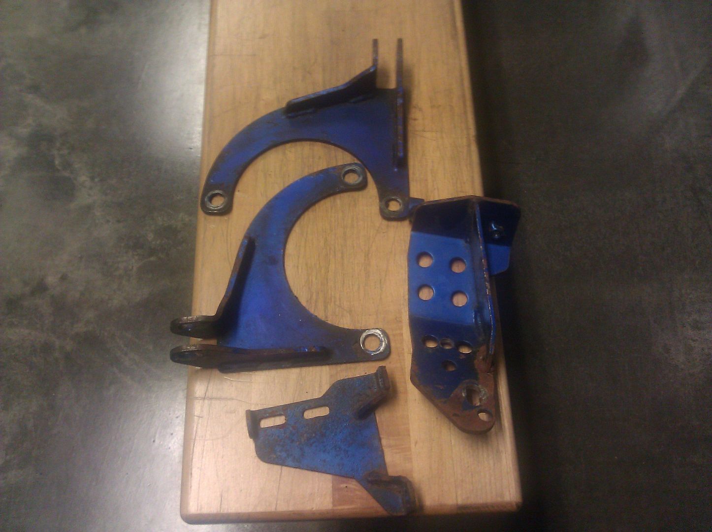

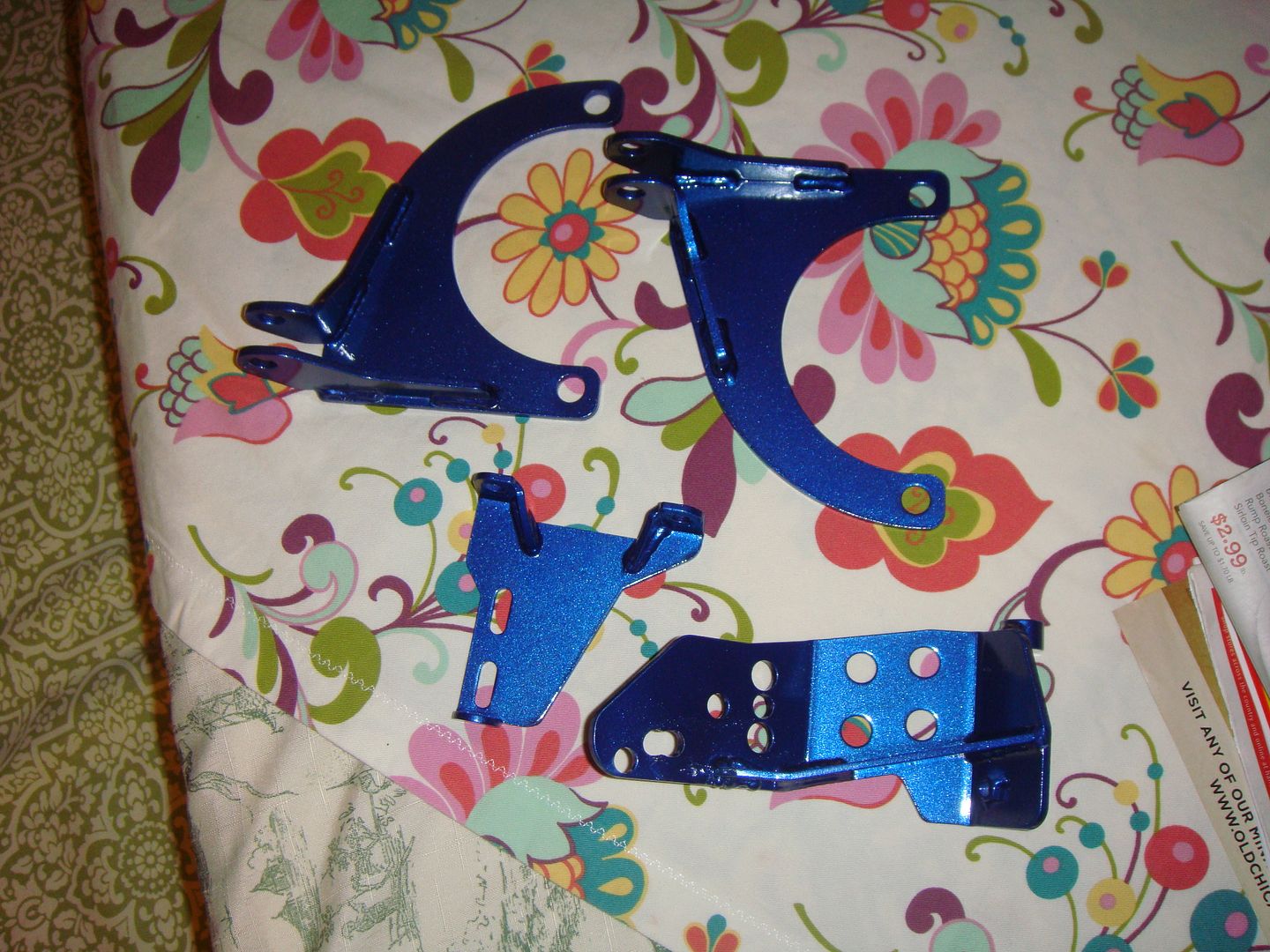

also got the cusco brake stop and the cusco tower bar mounts repainted. It is pretty close to the original cusco blue. I used the same color on the brembos
http://i122.photobucket.com/albums/o...o/DSC03130.jpg

The parts are spray painted it is the same paint I used for the brembos.

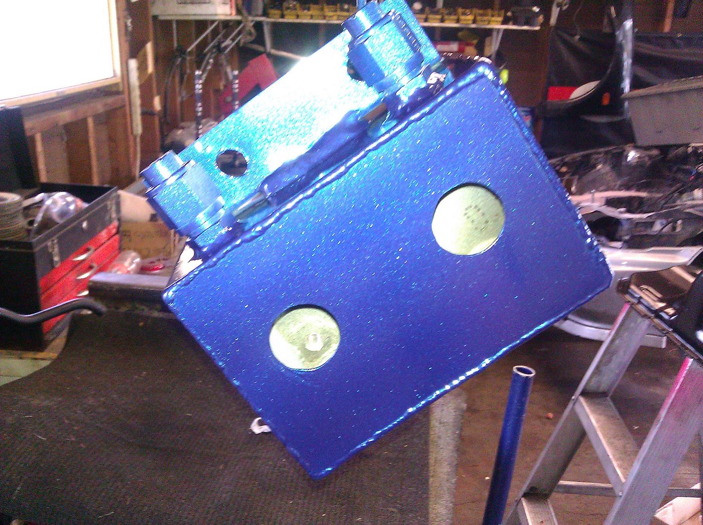

Also decided to paint the oil catch can also. If I get tired of it I can blast it and polish it later on.
http://i122.photobucket.com/albums/o...505_180036.jpg

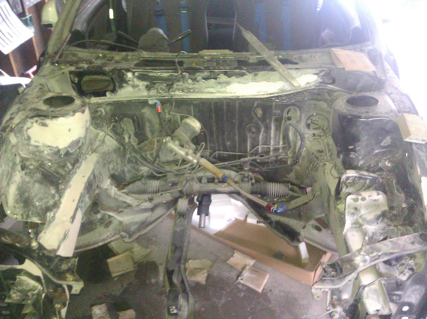

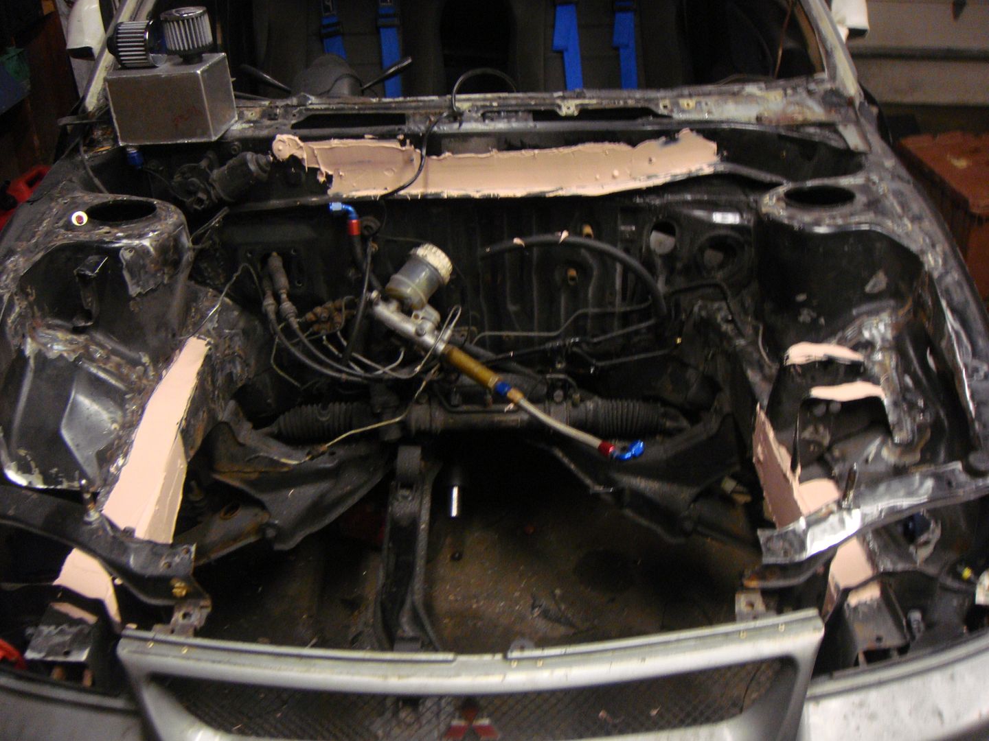

Got all the body work that I am going to do to the engine bay done. Now just to get the paint for it and start the rewire of the car.
http://i122.photobucket.com/albums/o...512_125022.jpg
http://i122.photobucket.com/albums/o...512_125031.jpg
http://i122.photobucket.com/albums/o...512_125039.jpg

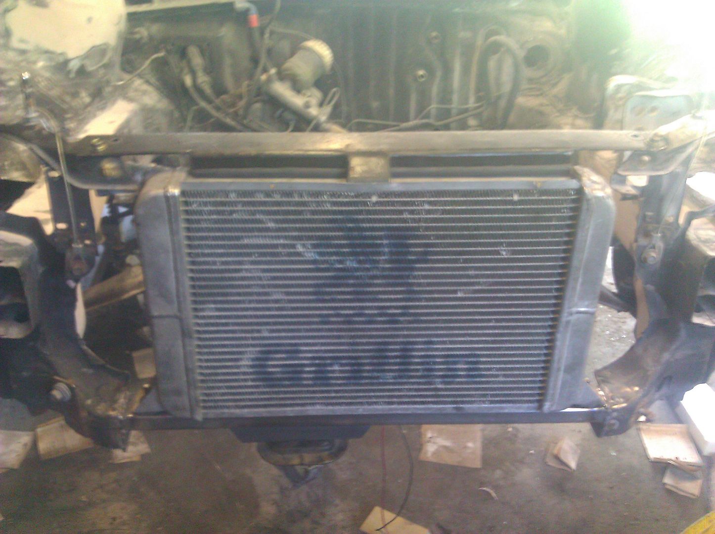

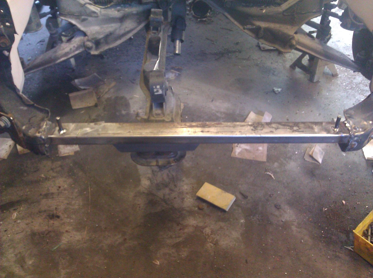

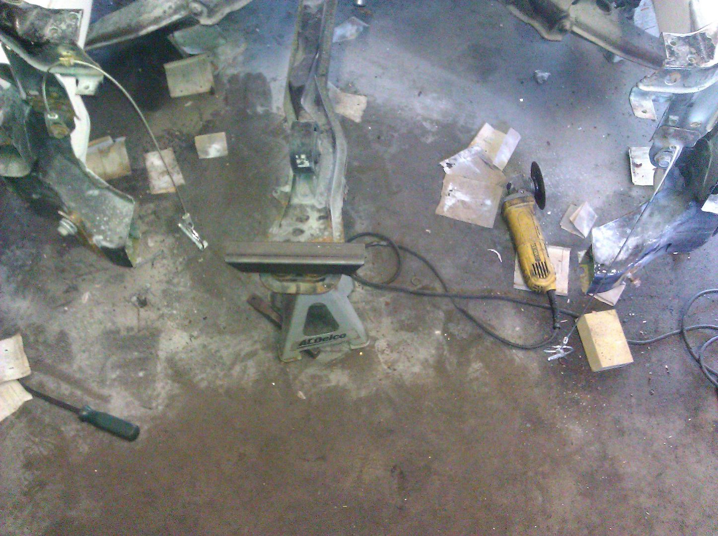

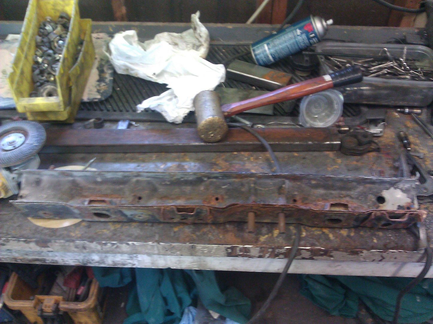

got the new lower core support finished up today. I did it to make more room for the lower piping with the top mount. it was touching the stock one and the stock support is rusted and the bolts were frozen in it
http://i122.photobucket.com/albums/o...518_134553.jpg
1.5x1.5 box for the rollstop mount bar
http://i122.photobucket.com/albums/o...518_134559.jpg
the new bar 2.0x1.0 also drilled and droped in and welded new pegs for the griffin radiator
http://i122.photobucket.com/albums/o...518_145848.jpg
seeing how the radiator sits now. little more forward and down a bit more room
http://i122.photobucket.com/albums/o...518_150032.jpg
