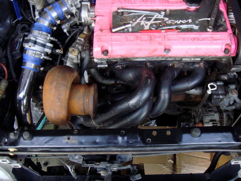

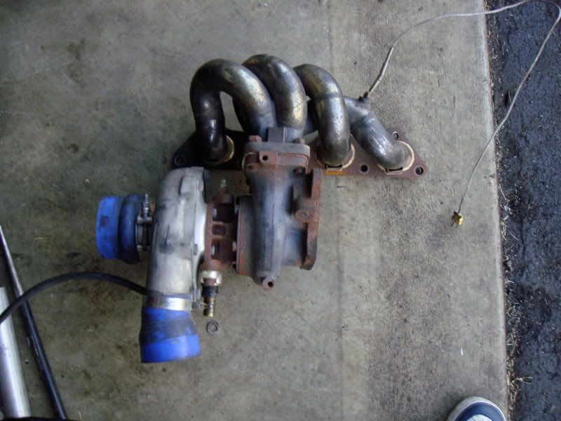

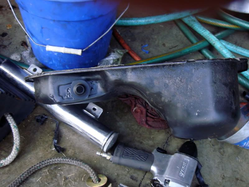

today dad and I got the manifold all fixed up. made a new coil bracket so it will bolt were the a/c bracket was. welded in the 10an bung to the extra oil pan I had. got the dnp manifold and the pte5031e off the car after we started the car up with no down pipe to check out the clutch and it is 100 times better than the QM was.
bye to the dnp,pte5031e
http://i122.photobucket.com/albums/o...o/DSC01028.jpg

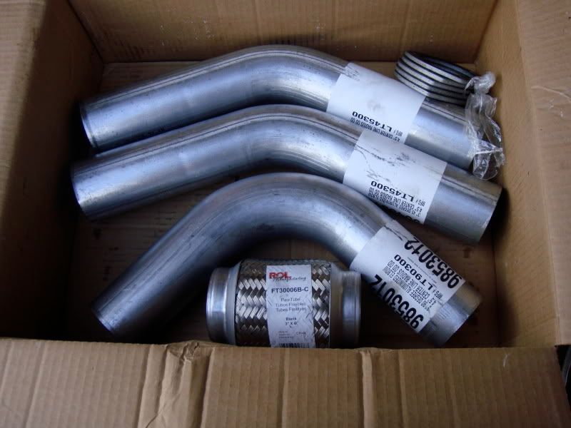

pipes and flex for the new down pipe
http://i122.photobucket.com/albums/o...o/DSC01027.jpg
10an bung (on a 100 year lease :))
http://i122.photobucket.com/albums/o...o/DSC01029.jpg

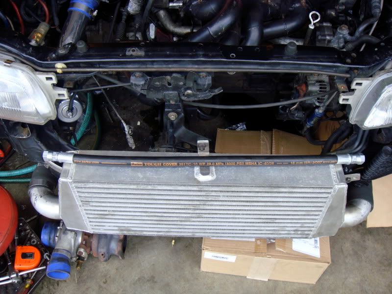

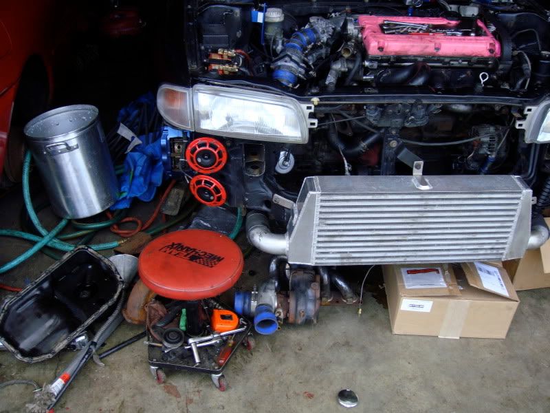

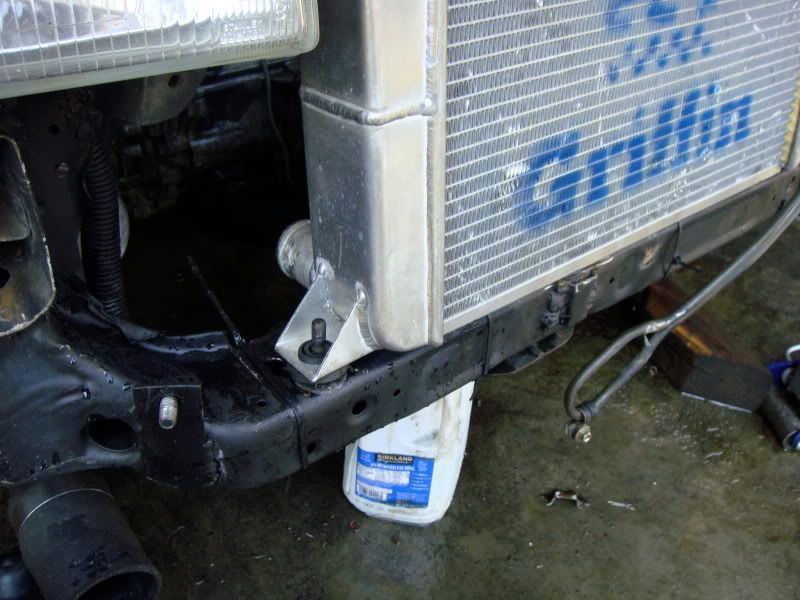

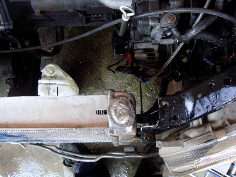

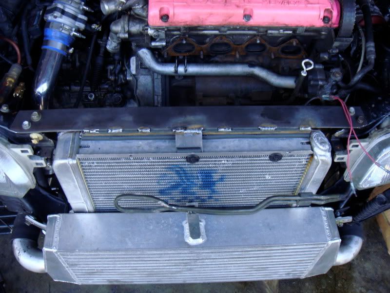

got the griffin scirroco radiator fitted. just have to cut off the water neck and have it welded shut and cut the upper hose fitting and have it come out at a 45 so it will clear the turbo better. Also cut out the full top radiator surport to make room for the radiator so we made a nice flat bar to bolt in and has a 90 piece of steel in on the bottom to hold the top of the radiator.
http://i122.photobucket.com/albums/o...o/DSC01041.jpg
http://i122.photobucket.com/albums/o...o/DSC01042.jpg

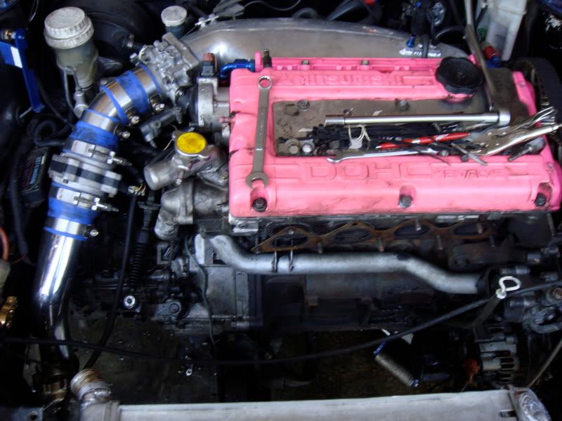

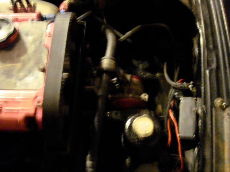

we put in a 2g upper motor mount that we had to mod it to fit with the polly mount
http://i122.photobucket.com/albums/o...o/DSC01045.jpg

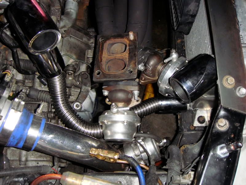

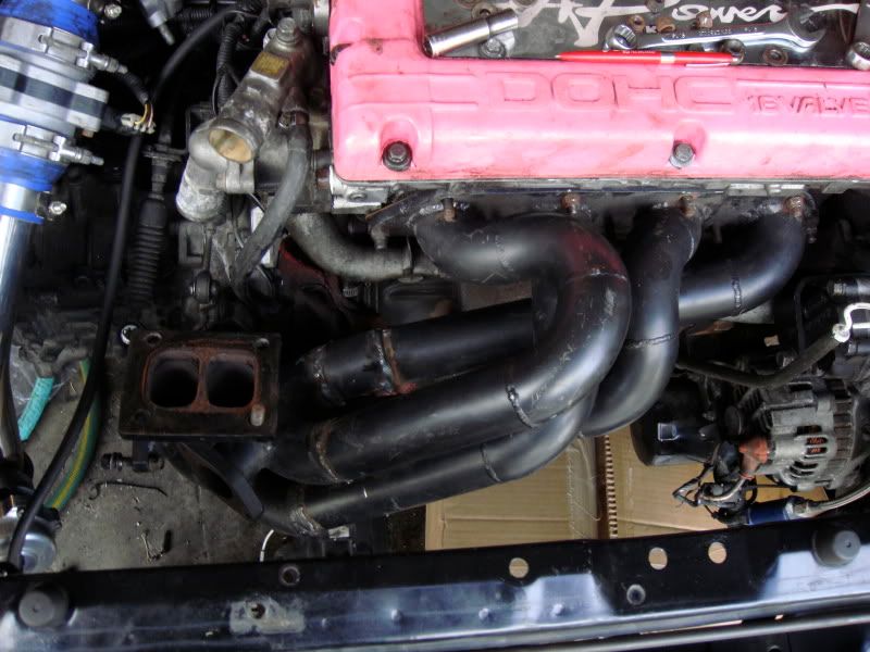

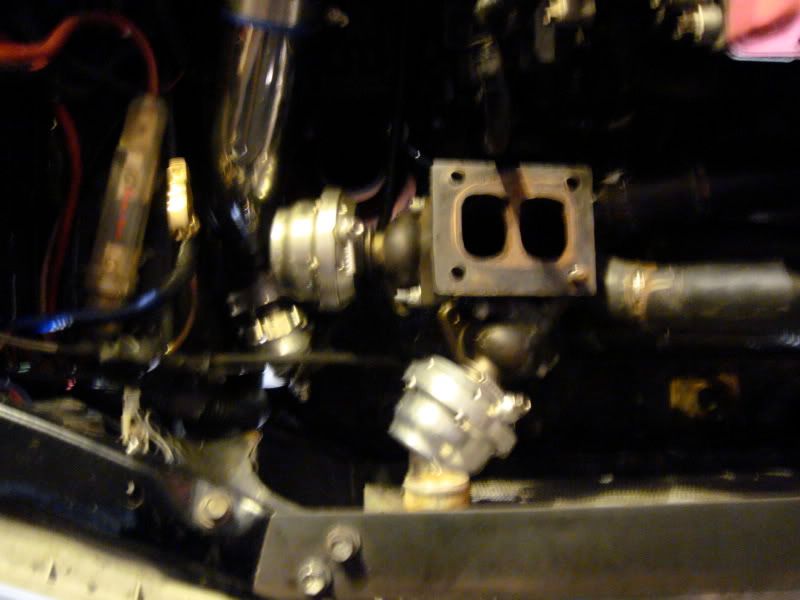

got both of the tial 38's on the manifold
http://i122.photobucket.com/albums/o...o/DSC01043.jpg

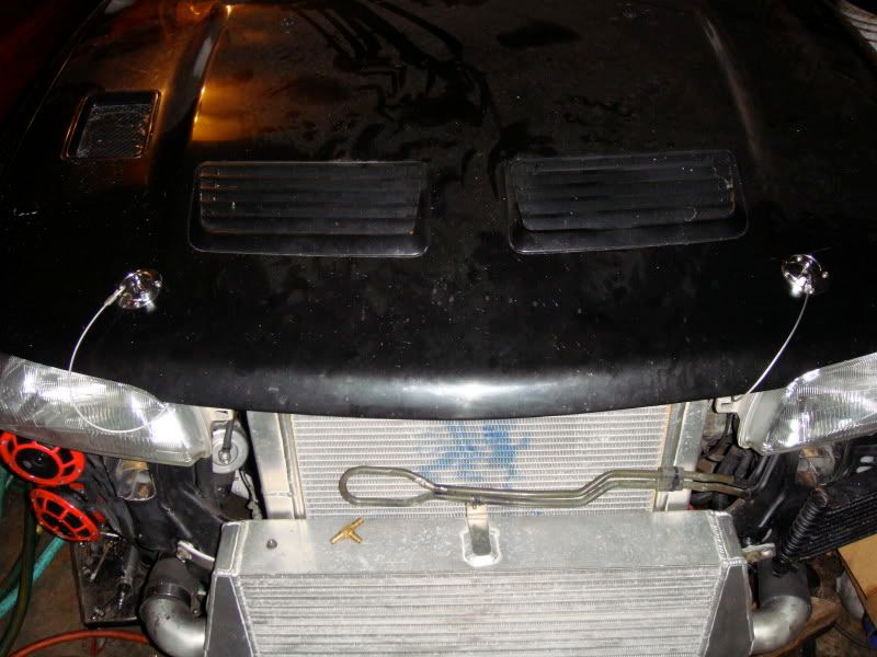

also picked up a set of hood pins from craig. need to use them now since the car will no longer have a hood latch on it because the radiator is now sitting there.

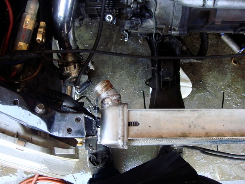

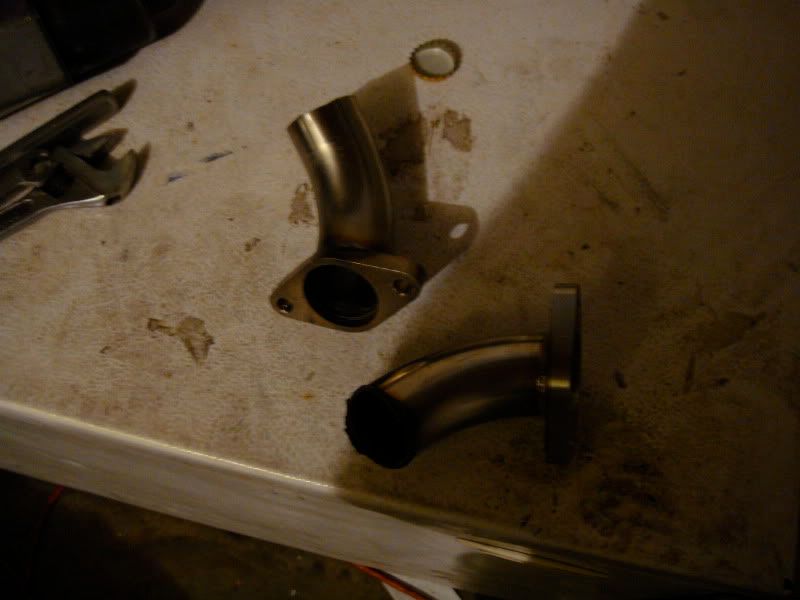

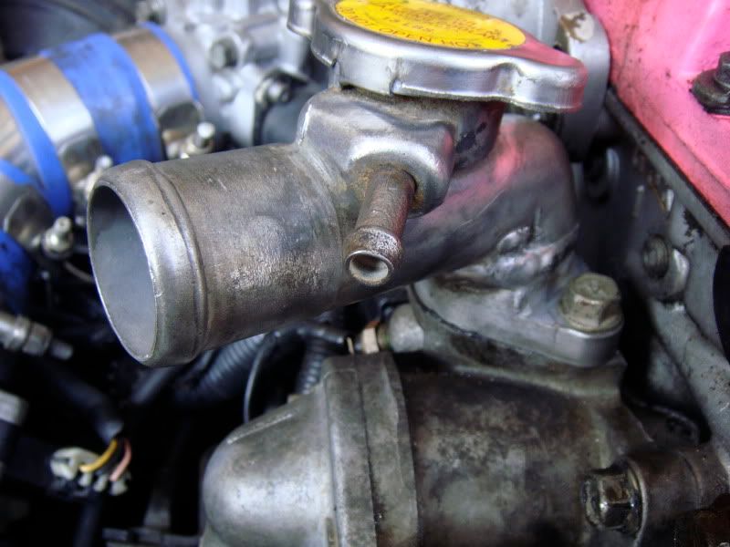

got the radiator and water neck back from John(Pushit2.0) to day. big thanks to him for welding them up. Had the upper hose pipe welded at a 45 and the radiator cap cut off and welded shut. On the water neck it is the evo III bottom and a 1g upper and it is also at a diffrent angle so it will clear the turbo when it get's back I hope soon so I can get the car done.
http://i122.photobucket.com/albums/o...o/DSC01054.jpg

water neck
http://i122.photobucket.com/albums/o...o/DSC01052.jpg
also put in the other evo III water pipe I had since I dont need to run the dented pipe any more. Also show's the new angle for the water neck
http://i122.photobucket.com/albums/o...o/DSC01053.jpg

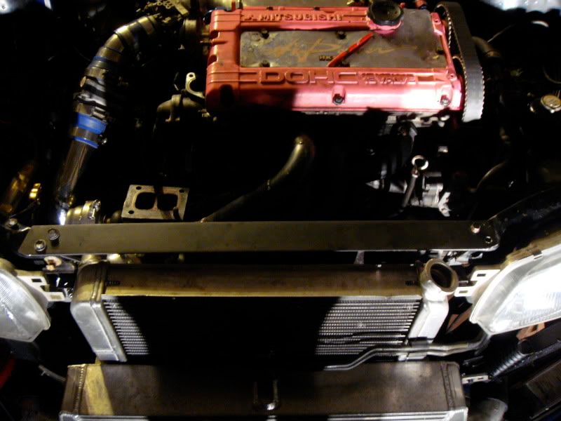

Dad worked on the radiator. cut some holes in the mounting tabs to install the oem rubber mounts for the radiator and welded in a set of bolts to hold the bottom of the radiator.
http://i122.photobucket.com/albums/o...o/DSC01056.jpg

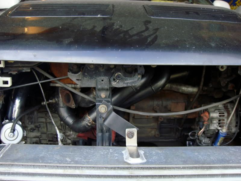

the new upper radiator support. We made it a bolt in so the radiator can be taken out with out taking the top mount off the car. It also holds the front and back of the top of the radiator so it does not move at all.
http://i122.photobucket.com/albums/o...o/DSC01057.jpg

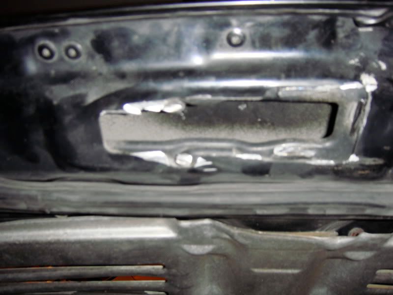

cut off the safety latch and main latch off the hood since it hit the new radiator
http://i122.photobucket.com/albums/o...o/DSC01063.jpg
in stalled the hood pins on the car
http://i122.photobucket.com/albums/o...o/DSC01064.jpg
also picked up a set of tial 38mm flanges with some pipe on them already to make the dump tubes
http://i122.photobucket.com/albums/o...o/DSC01058.jpg
