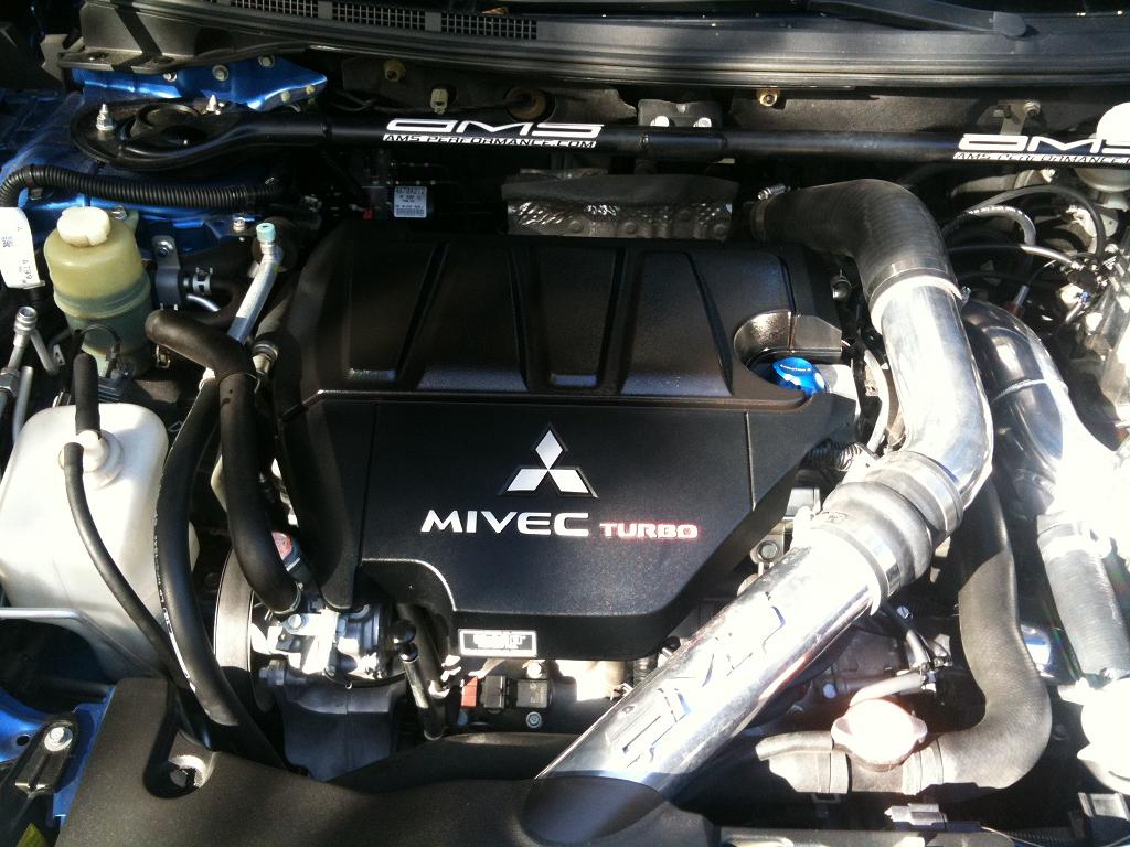

2 Attachment(s)
Well, it looks like my powdercoating plans will have to be delayed for a week or 2. I'll be helping Kracka install his MAP FMIC this weekend. I was originally wanting to garage my car (which for me means putting it in the backyard, lol) this weekend and start ripping out the IC piping and the intake so I could set up an appointment with the local powdercoater the following Saturday. However, due to Kracka's accelerated modding plan, I'll have to put that on hold for a week or so (which is fine by me...more driving around with the fresh tune :D).
I finally decided that I'm going to do a metallic/glossy/pearlescent blue (basically, whatever color matches the car's paint more closely). I'm going to see if the guy can color match my oil cap so that everything will match pretty closely.
I went ahead and painted the red part of the engine cover a glossy black and I think the engine bay looks MUCH better that way. The blue piping will really pop now.
http://mitsustyle.com/forums/attachm...1&d=1288639326
mlomker 11-01-2010 03:51 PM
Re: Greetings MitsuStyles! Kracka recruits yet another one!
Since you have an `08 you should just powdercoat the valve cover and ditch that thing. Looks a lot better imo.
scheides 11-01-2010 04:06 PM
Cover up your battery terminal fool :P Or, its getting painted. Cool :)
IMHO leave the parts shiny, bling bling!
Rmondoh 11-01-2010 04:20 PM
I don't want to mess with doing a wire tuck and getting a cover to put over the coils. I actually like the engine cover to be honest. :)
Actually, Cobb forgot to put it back on after my tune. Kracka actually painted his and mine black this past Saturday as we were both going to do that anyways. Hopefully Cobb didn't throw it away wondering what it was since it's not red anymore. I hope to make it to their 1st Thursdays of the month meet and reacquire my battery terminal cover. :)
mlomker 11-01-2010 05:02 PM
I'm not doing either on mine. Nobody told me that was required. ;)
Murlo26 11-01-2010 05:02 PM
Nor am i on mine :)
Rmondoh 11-01-2010 05:06 PM
Lol! Touche my friend, but if I'm going to run without the engine cover, I'm going to do it right and make it look nice. Since I don't want to worry about rewiring, I'll keep it as is. :D
