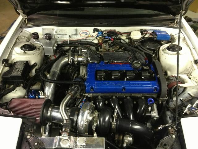

spoolin d dub 05-02-2013 08:44 PM
Re: Chaos! Project phoenix
Swapped out the 2 blue hoses. Should be getting the car by Sunday for motor break in!!!
http://i307.photobucket.com/albums/n...b/newhoses.jpg

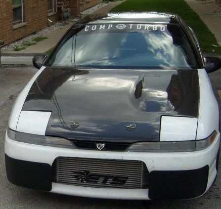

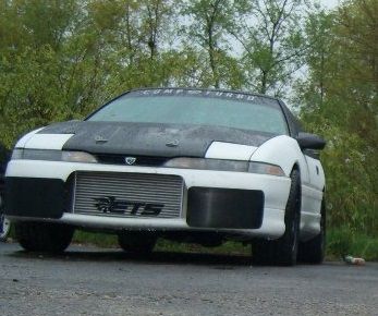

spoolin d dub 05-30-2013 06:36 AM
http://i307.photobucket.com/albums/n...51313-Copy.jpg
turbotalon1g 05-30-2013 08:13 AM
Nice car.
C3L1CA 05-30-2013 08:49 AM
Car looks good!
93gtpeater 05-30-2013 09:42 AM
Wanna race a 600? Haha. Car looks nice. Hopefully I can check it out this weekend
spoolin d dub 05-30-2013 05:23 PM
Thanks everyone. Its almost that time and I'm so damn pumped lol. I wanted to get it painted but after I thought about it I changed my mind. This isn't exactly the kind of event you want to run with a fresh paint job lol

spoolin d dub 07-20-2013 09:53 PM
We finally got to the dyno today. Everyone been waiting to see what this lil turbo can do lol. Reichen and the shop were asked what did I think the car was going to put down. They said 500ish. I never told anyone but in my mind I figured 600ish and I stood firm on that lol. It wasn't the best day to hit the rollers since temps in dyno showed 97* but oh well. 1st pull tach didn't give good signal and numbers were off showing 695whp and 900ft/lbs lol. The Afr were at 11.1 but someone at a meet/car show i went to turned up my boost to 33psi (it was at 29psi). the tune was conservative so it didnt hurt the motor but we noticed a little knock so mike pulled 1* of timing. 2nd pull afr leaned out to 11.7, 12* peak timing @ 33psi car made 693whp 527ft/lbs but then oil pump took a shit . We're pretty sure the engine noise logged was from oil pump going bad. With a little more tuning I'm hoping for around 730-750ish at 33psi then we turn boost up to 40-42psi :banana:. For the record this is a dynojet. i'll be back to update once we get back on the rollers.

Right at the end of pull a little cloud of smoke appeared. Fan blew oil onto downpipe. It may not even be the oil pump. Oil Pressure didn't drop but it was leaking a very tiny trail of oil. I had that issue before when the 10an aluminum fitting to the oil cooler cracked. I just can't find a steel one. But it is one of the two issues and we just didn't want to chance it. It wasn't worth it.
spoolin d dub 07-29-2013 10:47 AM
Well i was incorrect about the dyno pull. It was to 10,000rpm. The shop found the oil leak and it wasn't the oil pump. The car vibrated the fittings to the oil cooler loose. They modded the fittings with wires so they wont come loose again. I went out and did some pulls immediately after that and a saw a oil leak again. This shit is crazy. The leak was now coming from the oil pressure sending unit. they go to try to tighten in in and it falls off and hits the ground lol. The brass fitting broke in the middle of the threads with the other half was still in the block!!!! that is now fixed. Im getting phantom knock in the logs. I know its not the motor so once I find what is causing it i'll hit the rollers again.
