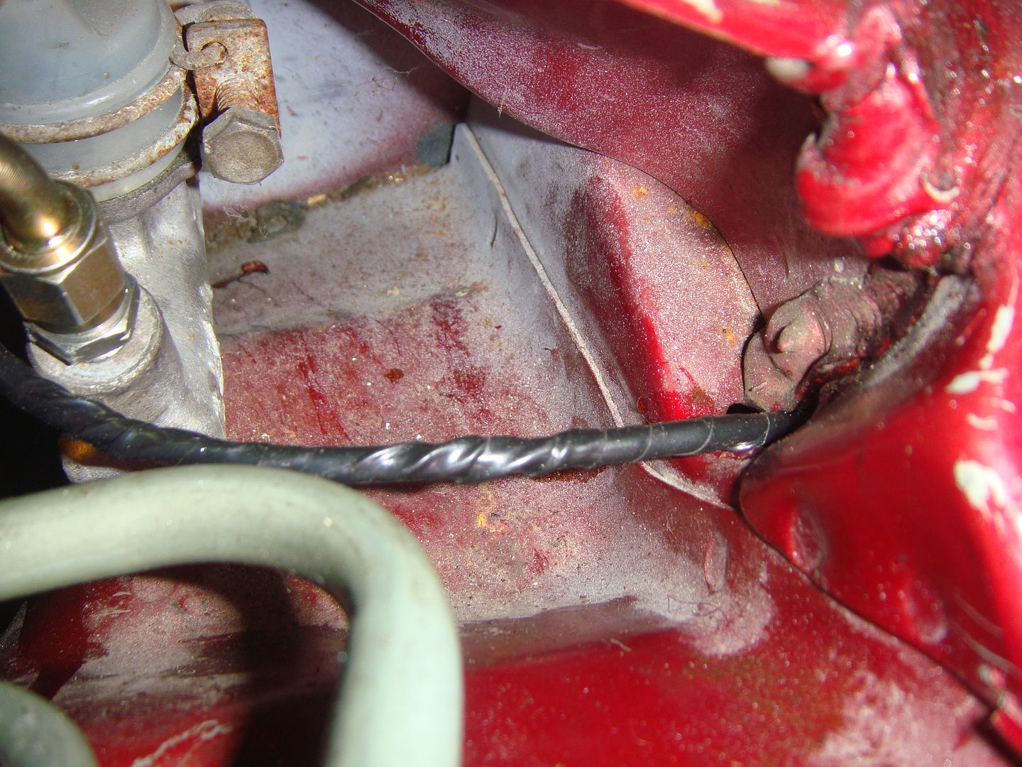

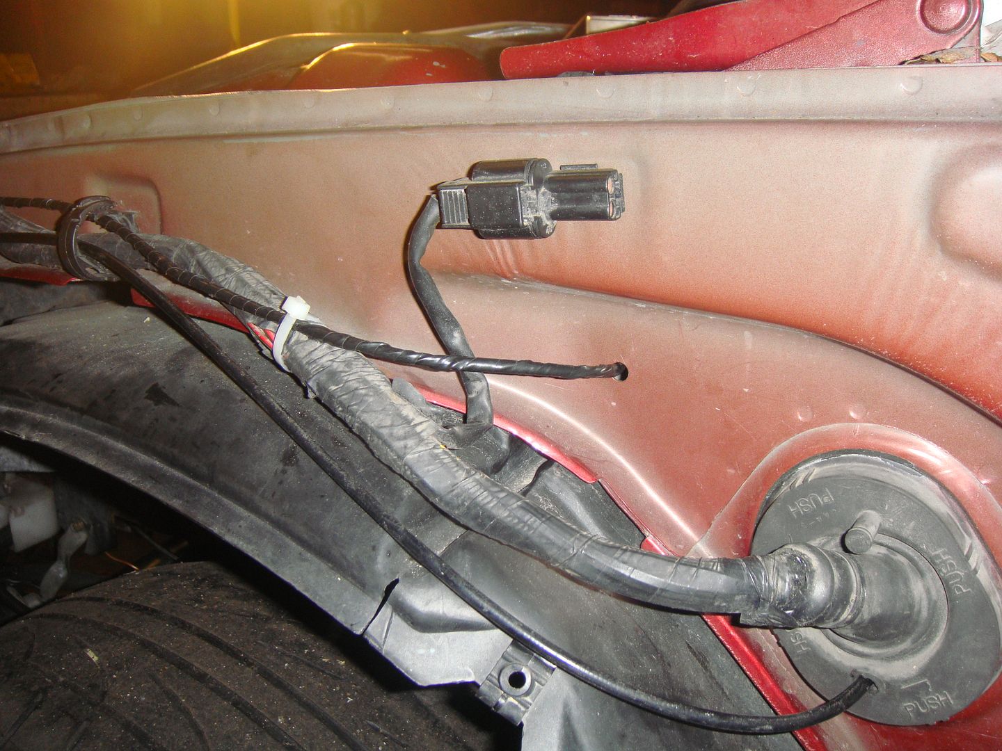

got the boost,oil gauges hooked up and the aem wide band hooked up.
ran the oil line through a pair of stock holes in the car

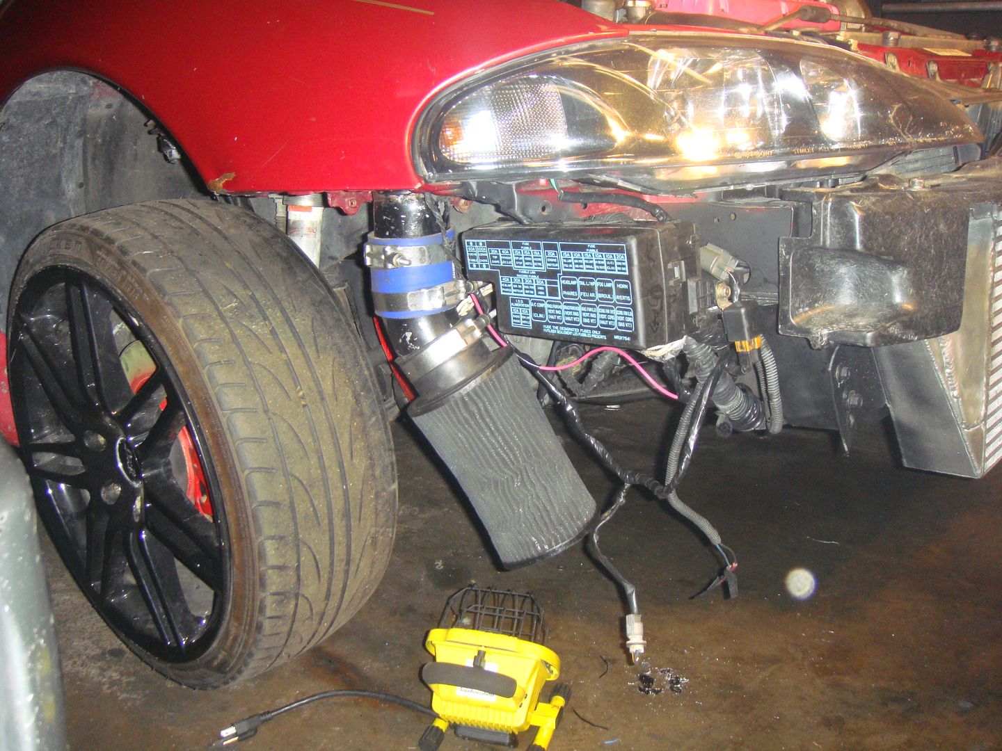

I had some extra 3in pipe and 3in couplers laying around so I made a extra pipe to make a cold air intake for the car. It fits though the stock smic hole
http://i122.photobucket.com/albums/o...r/DSC03968.jpg
http://i122.photobucket.com/albums/o...r/DSC03970.jpg

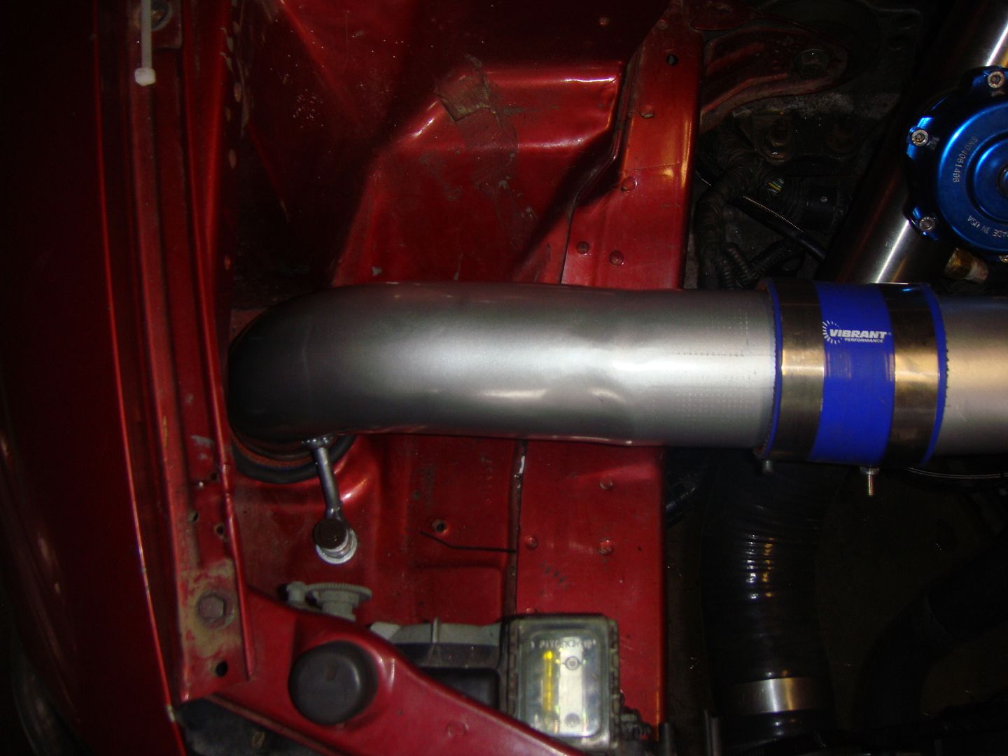

got the broken bolt out of the tranny so I could mount the shifter cable bracket and get them on. After I got them on and the speed sensor in I got the upper piping on the car.
http://i122.photobucket.com/albums/o...r/DSC03969.jpg
It is getting really close now
http://i122.photobucket.com/albums/o...r/DSC03971.jpg

painted the intake pipe in the basement shop last night and used the gas fire place to get it to cure between coats. also cut about 2in off the cold pipe were it comes through in to the bumper the filter was lower than the bumper.
http://i122.photobucket.com/albums/o...r/DSC03974.jpg
used some vac hose to make a buffer so it does not rattle on the frame
http://i122.photobucket.com/albums/o...r/DSC03975.jpg

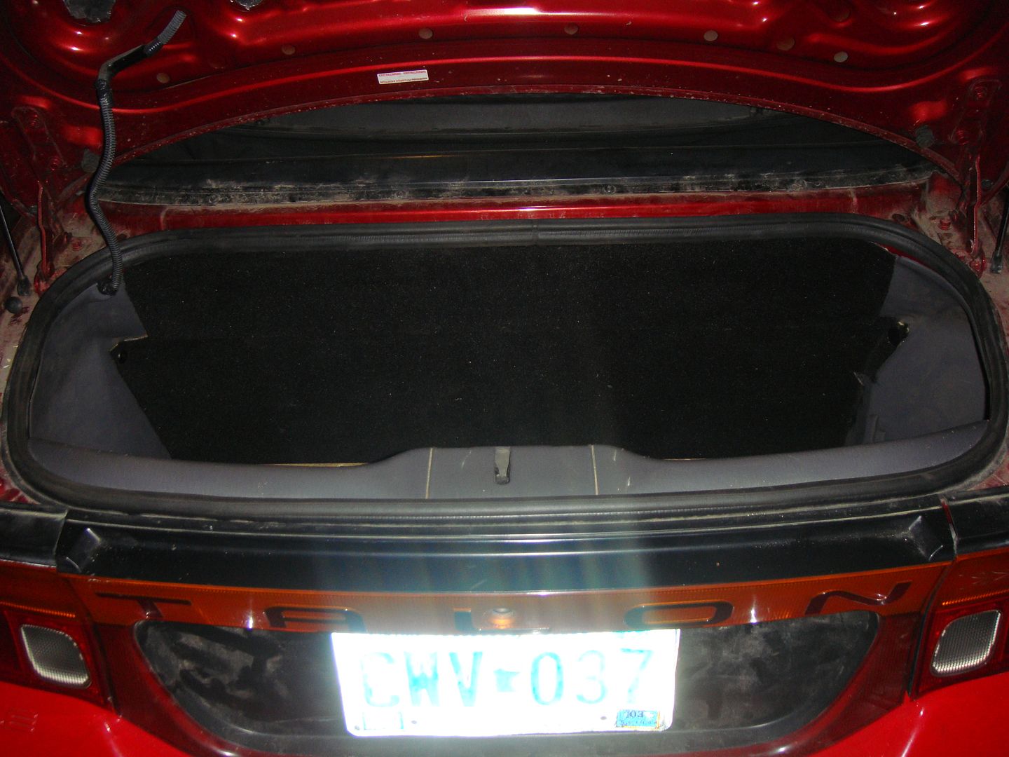

cut the top off the sub box to give me more room in the trunk. did not want to take it all the way out if I ever want to put some kind of 10in sub in it. It had a 15in flat ppi sub back in the day. just have to make a new floor since the one I have for it is cut out for the sub.
http://i122.photobucket.com/albums/o...r/DSC03997.jpg

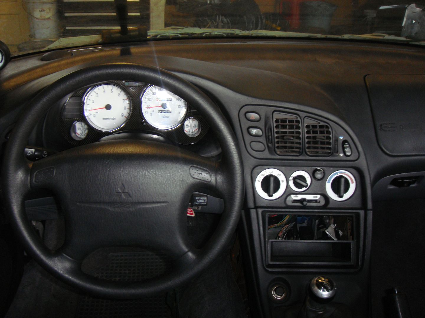

TkrPerformance 01-10-2012 10:10 PM
Re: after 10 years its coming back to life
got the white face over lays installed on the cluster and hvac controls
http://i122.photobucket.com/albums/o...r/DSC04000.jpg
now it match's the auto meter and aem gauges
http://i122.photobucket.com/albums/o...r/DSC04001.jpg

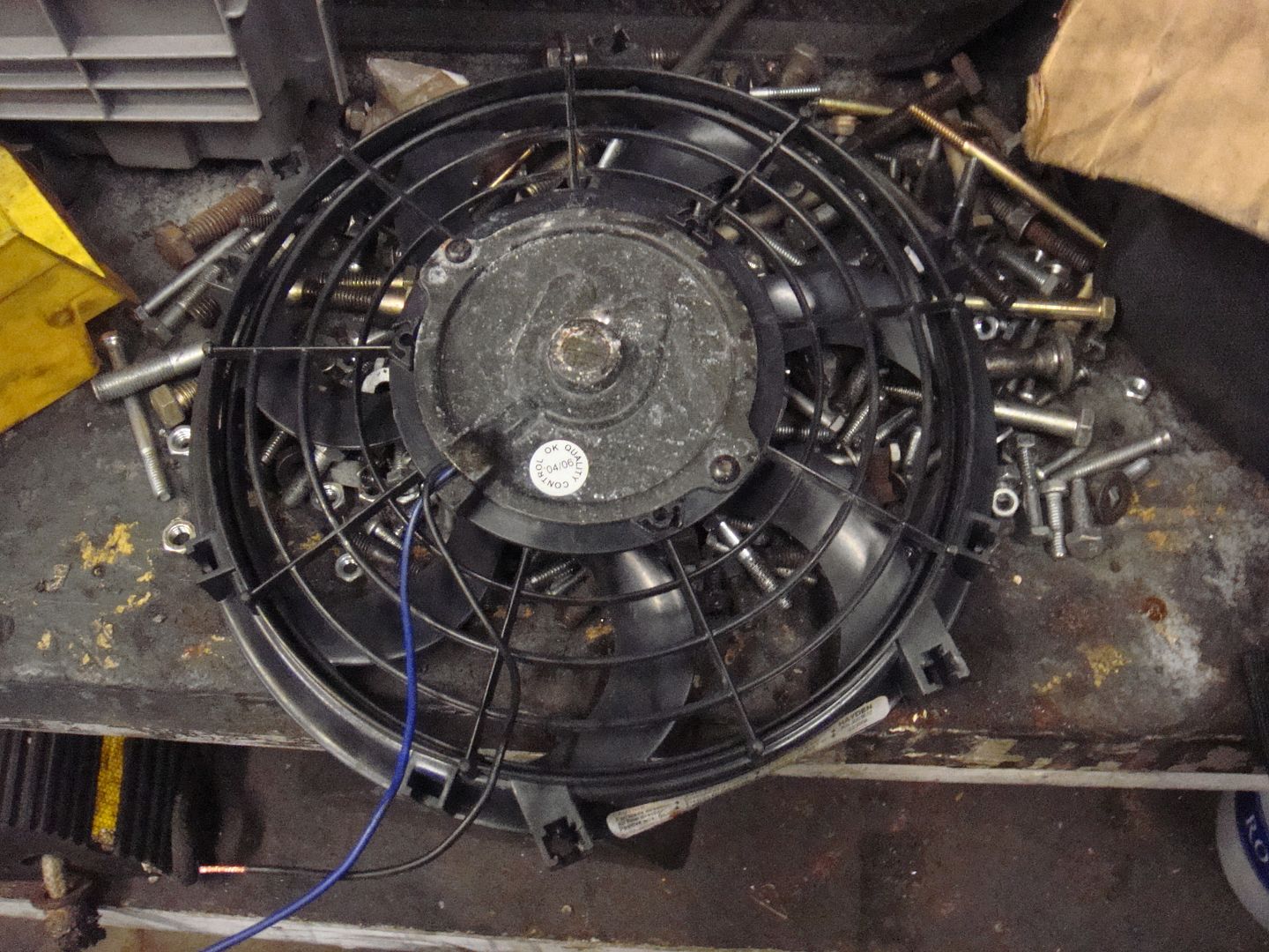

was going to buy a 10in fan for the a/c fan but found one in a box
http://i122.photobucket.com/albums/o...r/DSC04005.jpg
