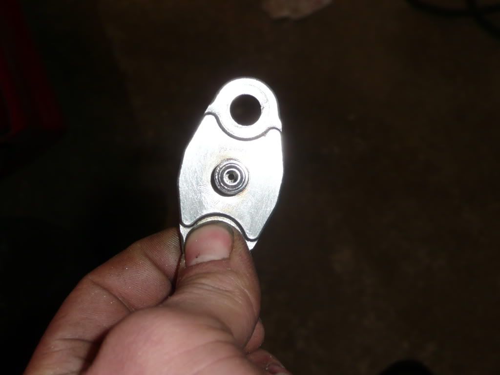

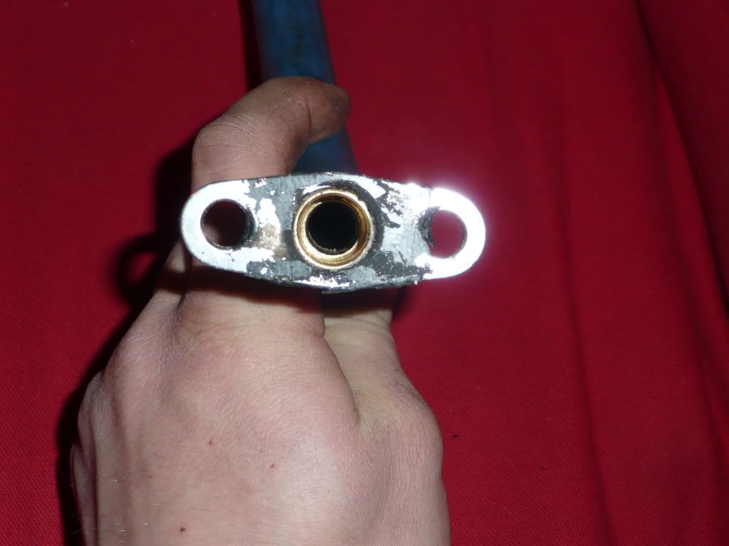

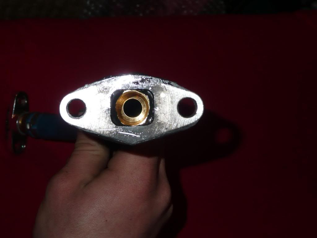

Got my FP drain line saturday. I wasn't too impressed with it. The size of brass nipples used is actually a little smaller then the stock drain line. I took it apart and drilled out the nipples as much as possible. Makes me feel a little better about it anyway..
The line
http://i224.photobucket.com/albums/d...0/P1020960.jpg
Flange for the turbo. Not drilled
http://i224.photobucket.com/albums/d...0/P1020958.jpg
Drilled
http://i224.photobucket.com/albums/d...0/P1020971.jpg
Flange for oil pan. Not drilled
http://i224.photobucket.com/albums/d...0/P1020959.jpg
Drilled (Probably gonna drill it out even more)
http://i224.photobucket.com/albums/d...0/P1020973.jpg

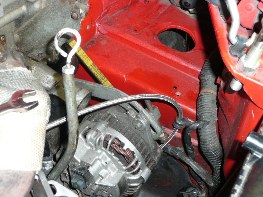

Got my missing piece from CA Racing and finally got to make my oil feedline.
First I had to remove the plug. The allen hole was stripped out so I had to resort to welding the allen wrench to the plug. Thank god it actually worked!
http://i224.photobucket.com/albums/d...0/P1020985.jpg
Then I installed my .65 restrictor, which many people don't run and ruin their journal bearing turbo's when feeding off the oil filter housing. I did tons of research.
http://i224.photobucket.com/albums/d...0/P1020937.jpg
Yes I know my alternator is jacked..
http://i224.photobucket.com/albums/d...0/P1020974.jpg
http://i224.photobucket.com/albums/d...0/P1020976.jpg

I run my oil feed line off my oil filter housing with no restrictor per request of PTE reuilder. Never had a problem at all. I've got a journal bearing 67mm pte turbo with 0 shaft play because of it lol. Your set up is looking pretty nice by the way!! Keep with the black theme! When are you going to ditch the 1g bov though?
It's different for different turbo's and what oil pressure you run. Some have built in restrictors and others do not. Like you said, you can just call up the manufacture and they will tell you. A lot of people just don't bother and end up with blown turbo's. I see it all the time.
