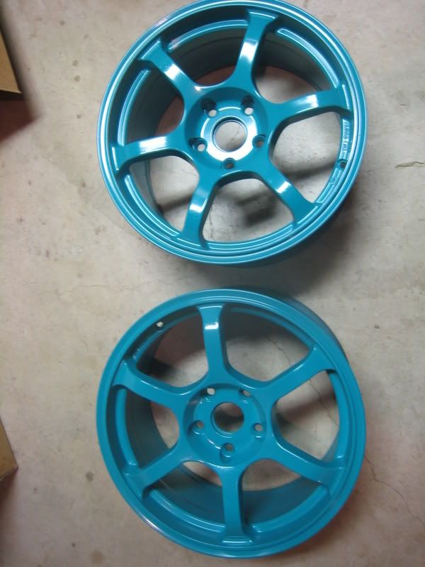

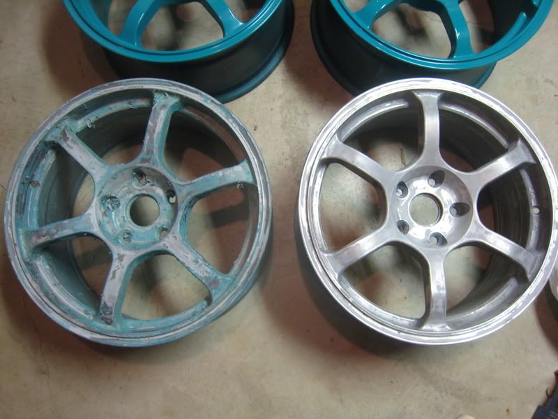

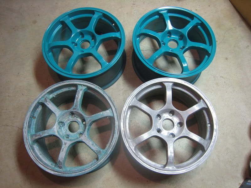

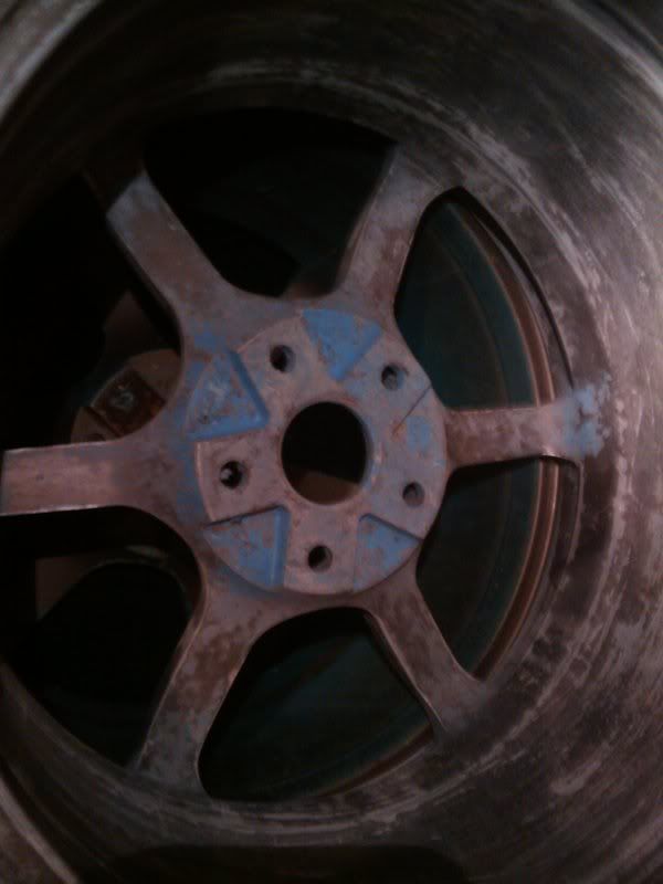

So I just picked up a set of rota boosts 17*8 and a set of all season 215-45-17 tires for 250.00 from a local that painted them 2 diffrent colors to see what he liked better then started to strip and repaint the other 2 but gave up. They will be droped off to a buddy to get blasted and powder coated black tonight. I will have them back in less than a week.
http://i122.photobucket.com/albums/o...cture002-2.jpg
http://i122.photobucket.com/albums/o...cture003-2.jpg
http://i122.photobucket.com/albums/o...cture004-2.jpg

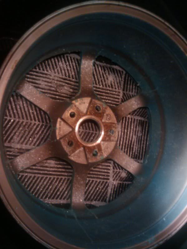

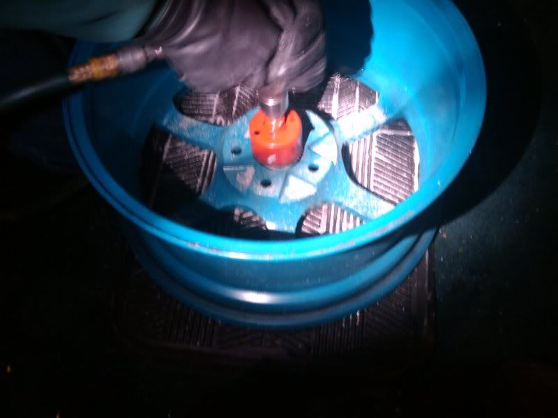

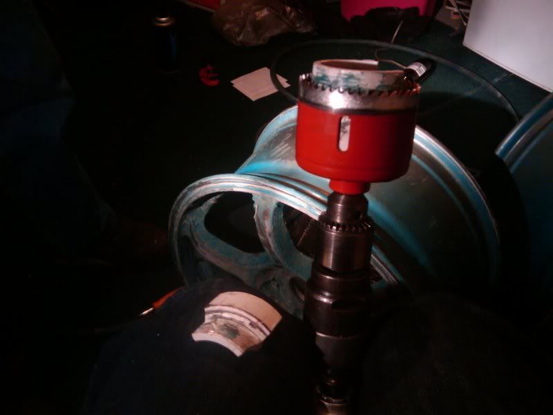

What really pissed me off I tryed to fit them and found out that the centering ring was way to small for a dsm/evo hub. So me and my dad made a tool out of a 2 5/8 alum hole saw and a pvc pipe adaptor that fit in to the center ring hole on the rim to cut them out to make them the right size. After 2 hours of cutting all 4 are done and will be out for powder tomorrow now.
here is the pics of what we did to the rims

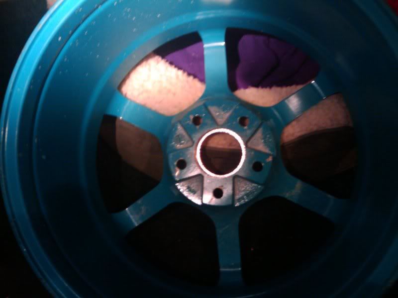

the stock size hole 56.1 mm
http://i122.photobucket.com/albums/o...2071248914.jpg
cutting to the new size total 67.1 mm
http://i122.photobucket.com/albums/o...2072310130.jpg
one fully cut it is just the back side of the rim does not go all the way through the rim
http://i122.photobucket.com/albums/o...2071204014.jpg
the tool
http://i122.photobucket.com/albums/o...2071278831.jpg
after the 4th rim the pvc broke
http://i122.photobucket.com/albums/o...2073738663.jpg

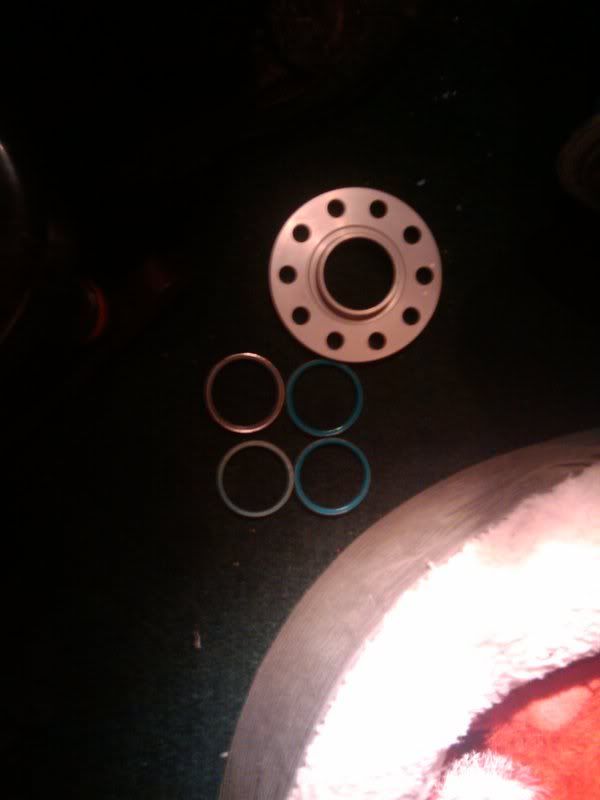

what was cut out of them and my front h&r spacer we used to check the rims to make sure they were cut deep enuf
http://i122.photobucket.com/albums/o...2073757715.jpg

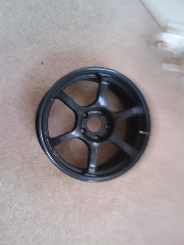

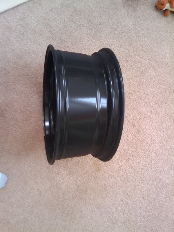

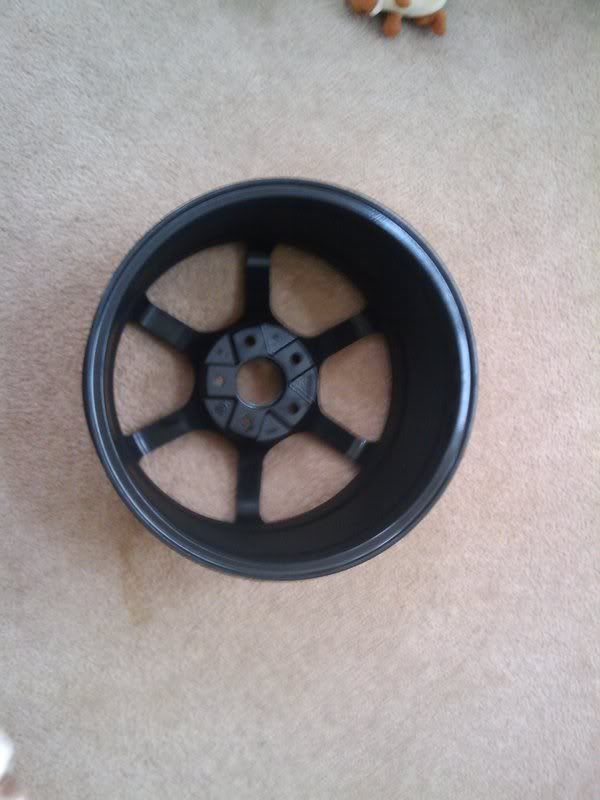

back from Kerry
got them back from my buddy last night. they were 240.00 for the sandblasting,polish,powder coating
sorry for the cell pics
http://i122.photobucket.com/albums/o...cture003-3.jpg
http://i122.photobucket.com/albums/o...cture002-3.jpg
http://i122.photobucket.com/albums/o...Picture001.jpg

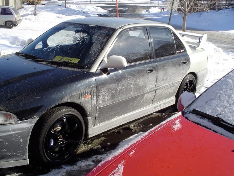

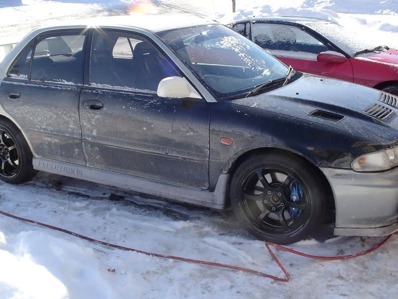

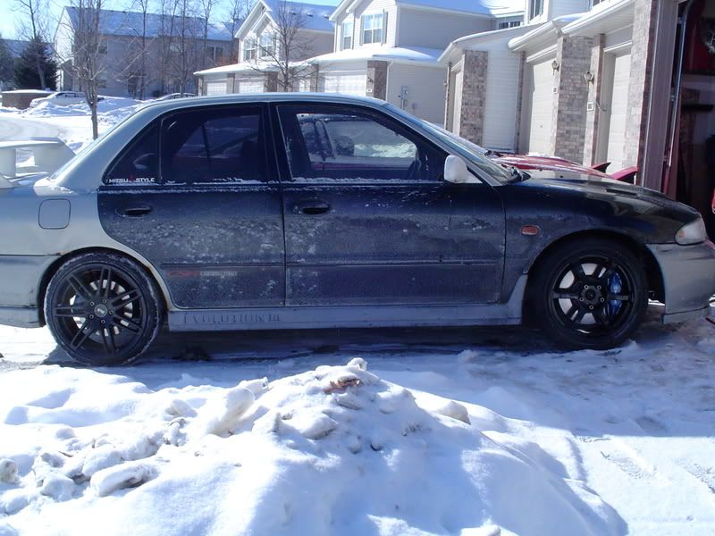

big thanks to ricer Pete :) for getting my tire put on last night after goodyear closed. got them all on just a few mins ago and they do look nice. makes me want to save up and get a set of advan RGII's for the car now ;). but probably not going to happen on the evo maybe get a set for the spyder.
first pic just the front 2 on the car with the dxr's on the back still. I like both sets of rims on the car. The only problem with the rota boosts I have not seen any in 18*8 or 18*7.5 in gloss black so I will just get a 2nd set of the dxr's and have 1 good spare rim for the car
http://i122.photobucket.com/albums/o...o/DSC04933.jpg
with all of them on you can kind of see them with alys winter dsm in the way.
http://i122.photobucket.com/albums/o...o/DSC04935.jpg
http://i122.photobucket.com/albums/o...o/DSC04934.jpg
