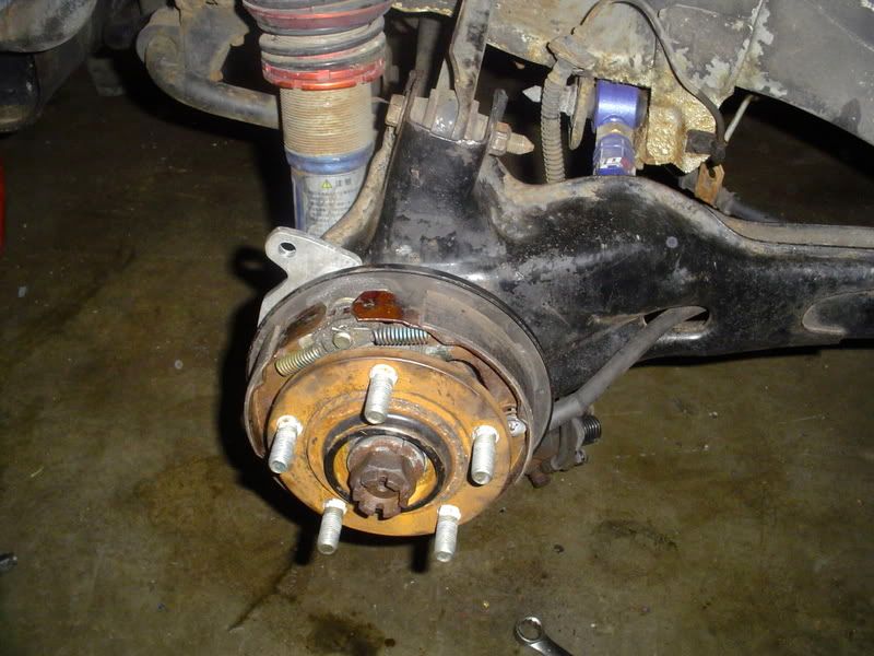

dad and I got the rears all done today. the car is on the ground. just have to blead the brakes some more they are still soft and get the ebrake to work better.

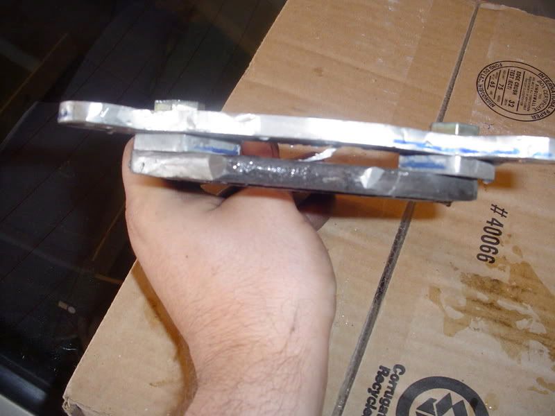

here is the first set of brackets. redid them a 2nd time with a smaller spacers. used just a washer on the 2nd run of them.
http://i122.photobucket.com/albums/o...o/DSC04700.jpg
http://i122.photobucket.com/albums/o...o/DSC04701.jpg

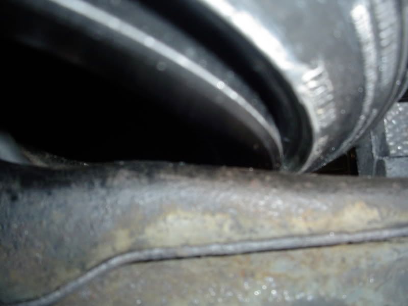

also a 18*8 will fit on the rear of a evo I-III arm with 1/8 or so of space
http://i122.photobucket.com/albums/o...o/DSC04702.jpg

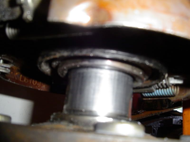

we had to cut the a set of bearing centers for a spacer for the hubs. with out them the hub hit the ebrake.
http://i122.photobucket.com/albums/o...o/DSC04706.jpg

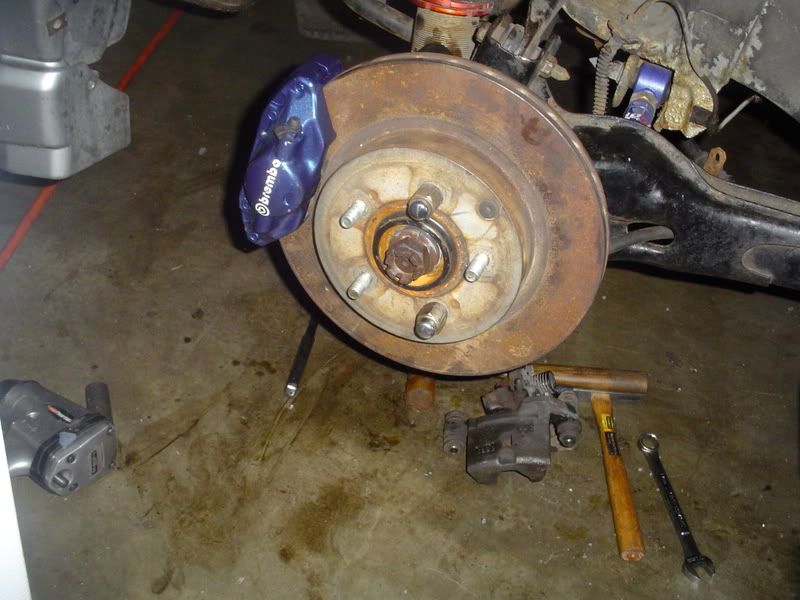

the evo I-III arm with the 2nd bracket set up and the evo 9 ebrake set up
http://i122.photobucket.com/albums/o...o/DSC04704.jpg
put all together with the evo 9 rear disk and brembo
http://i122.photobucket.com/albums/o...o/DSC04705.jpg

dad,kevin,and I got them all blead out and got the ebrake fixed so it works really well. The evo 9 cables were longer than the evo 3 ones. I still dont like the brake peddle so I am going to pick up a evo 8 master and swap that in. also will pick up a set of rear s.s. lines for it.
http://i122.photobucket.com/albums/o...o/DSC04707.jpg
http://i122.photobucket.com/albums/o...o/DSC04708.jpg

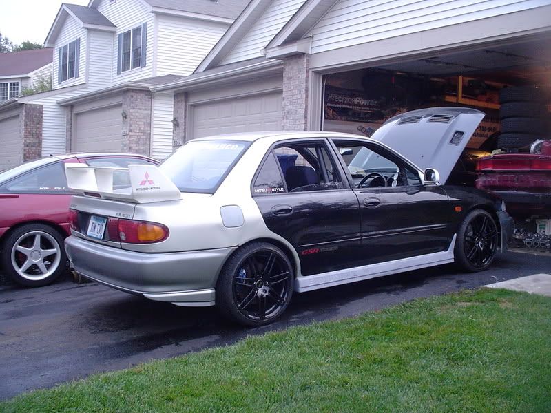

That looks awesome mark! Cant wait to see it in person Looks great with black wheels!
mdost03 09-14-2008 01:54 PM
Re: the evo 3 swap parts are coming
Looks great! Size of the wheels on that car doesn't look too bad either.
A//// Guy 09-15-2008 09:19 AM
Looks good! Its torture waiting for this thing to be one solid color. lol
scheides 09-15-2008 09:26 AM
Holy shit those 18's look like freakin 20's on that car! Bawlah!!! What tires did you end up going with?

Looks good but I think the wheels are too big. It makes the calipers and rotors look small. Those tires look thin also. I'd go with 16's if I were you.
95talonracer 09-19-2008 12:08 AM
I am guessing the wheel size was choosen to be able to fit the new brakes in so he can't go much smaller.
eclipse_spyder 09-19-2008 12:34 AM
I'm pretty sure 16's can fit. My Brembo's, although they are not the Evo's calipers, can fit 16's. 16's makes your brakes(caliper/rotors) huge!
311evo 09-19-2008 02:55 AM
16's would not fit over evo brembos, hense them comming stock with 17's with very little clearance.
