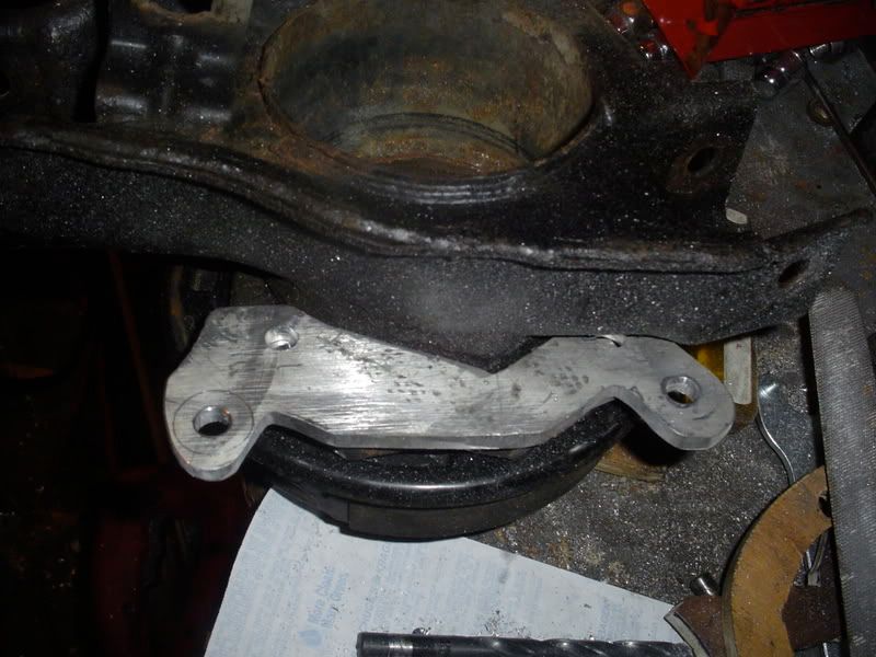

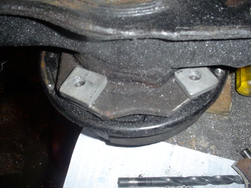

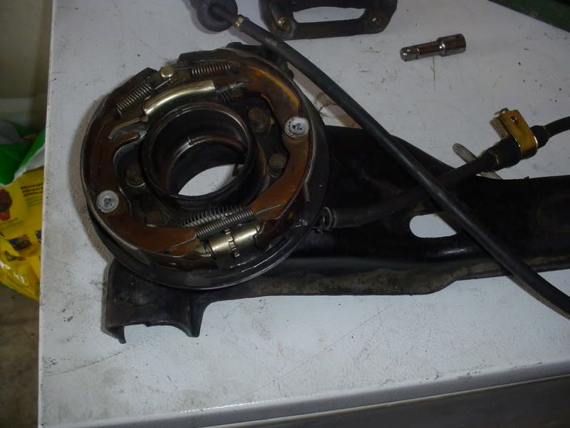

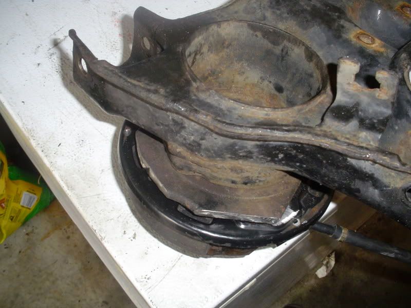

got the rear arms off and apart and started to go back together. hit a road block with one of them the bearing broke pressing out the 4 lug hub, But it was craig for the save he was able to order one for me will be in tomorrow morring.
evo III rear arms. We cut up the oem brake brackets. We cut the ears off them. Also had to make the center hole bigger on the evo 9 ebrake and drill out the bolt holes in it a bit to line up with the evo III bolt's
http://i122.photobucket.com/albums/o...o/DSC04673.jpg
http://i122.photobucket.com/albums/o...o/DSC04674.jpg
here is the brackets that we made out of some 1/4in alum plate I had laying around also 1/4in spacers. still have to drill and tap the oem evo III brake bracket for then alum ones for the brembos.
http://i122.photobucket.com/albums/o...o/DSC04675.jpg
http://i122.photobucket.com/albums/o...o/DSC04676.jpg
Also got the front hubs put on the car and have some modding to do the front brackets and back of the brembo so they sit better.

That turned out to be alot more work than I thought it was gonna be. I'm glad the left rear side came apart way easier than the right rear side. That one bottom bolt was a BITCH!
