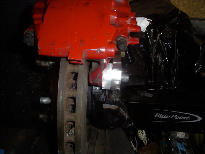

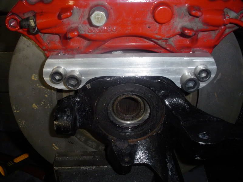

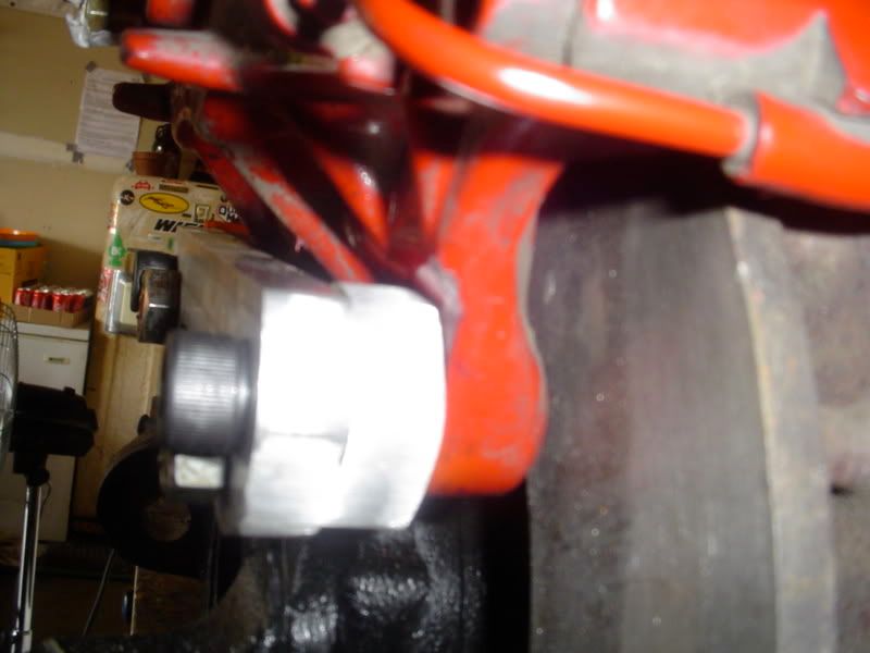

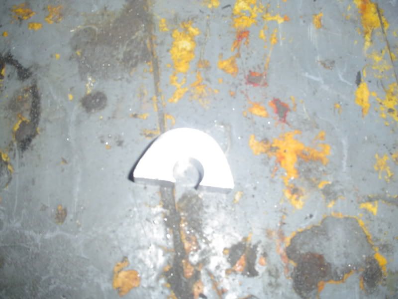

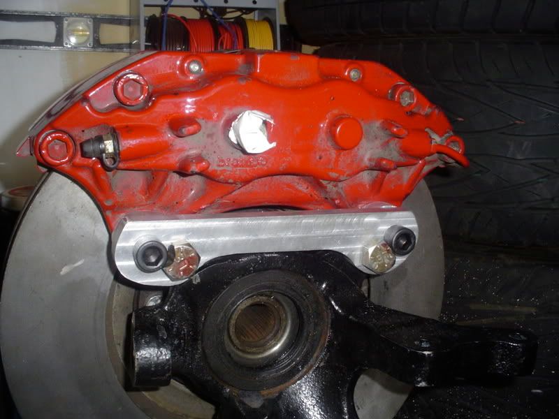

thanks to mike he finnished a set of spacers for me they are also 1/2 thick. so no the brembo can be bolted on with a full bracket now

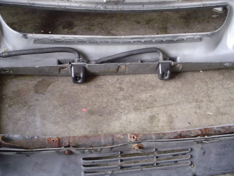

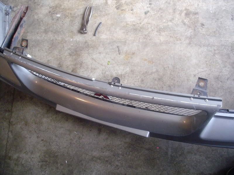

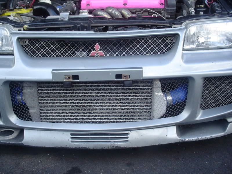

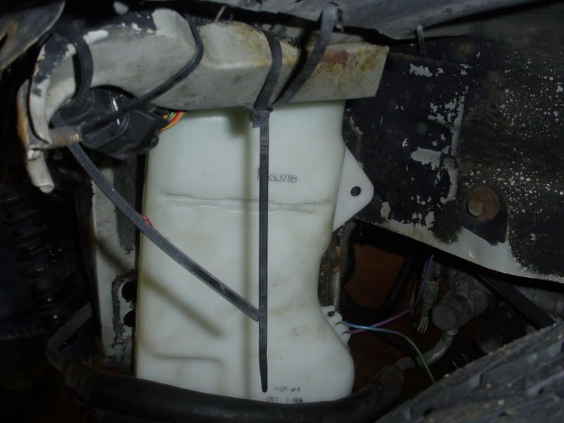

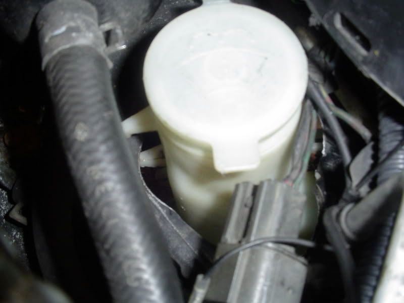

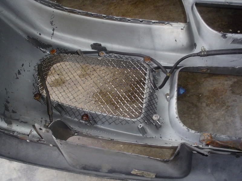

got more done today on the car with the help of my dad Ken. We got the water bottle mounted after cutting a big hole in the sheet metal to the top of it so it can be filled easy. Got the boost pressure switch installed and set to 20psi to come on and stay on till 27psi. Had to take off the front bumper to get the 2 oem evo III water sprayers in. Als fixed the front bumper with some alum rivits to hold it were it has to be. The bumper did not have the tabs on it when I got it and has been lose sense it went on the car. last thing we did was take out the amp rack and put in the rear cusco tower bar.
water jets
http://i122.photobucket.com/albums/o...o/DSC04372.jpg

were the hole was cut right by the P.S. resvore
http://i122.photobucket.com/albums/o...o/DSC04375.jpg

with the bumper back on
http://i122.photobucket.com/albums/o...o/DSC04378.jpg

were the bumper was reatached
http://i122.photobucket.com/albums/o...o/DSC04374.jpg

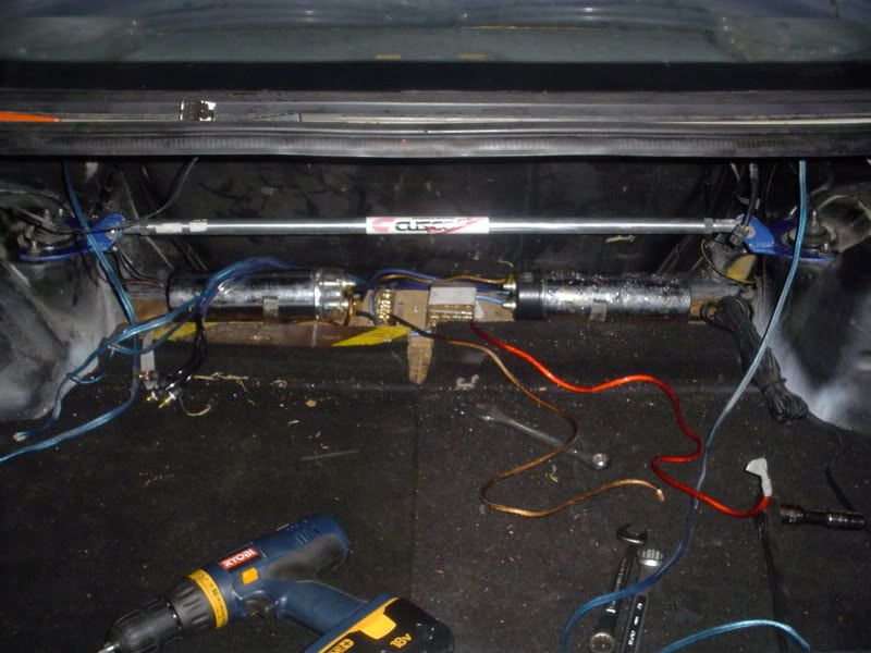

cusco rear tower bar that sits behind the amp rack
http://i122.photobucket.com/albums/o...o/DSC04379.jpg

got the big alen head bolt today and got them in and they work alot better than the bolts that were cut.

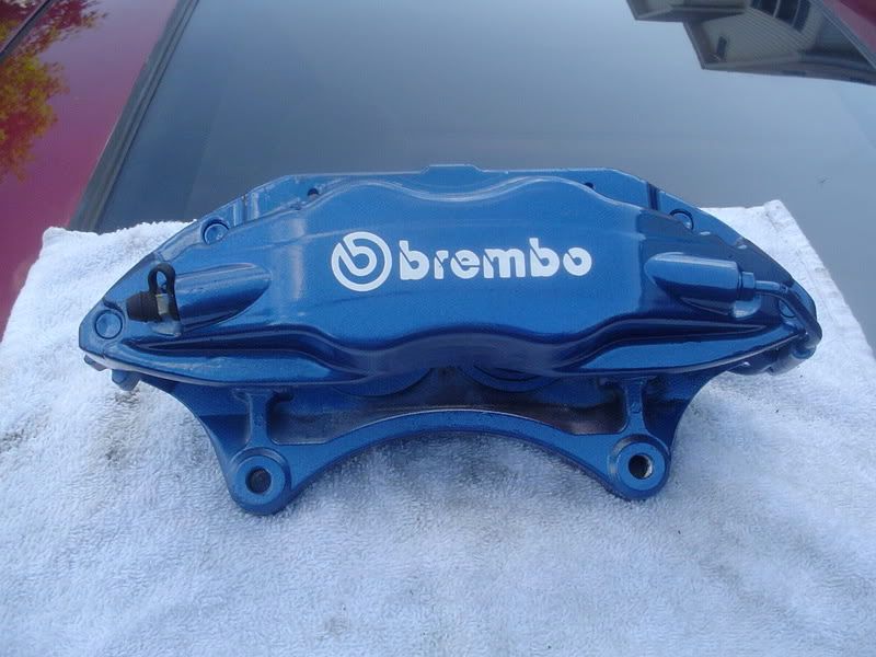

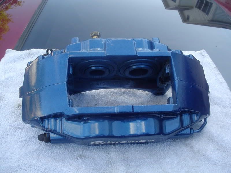

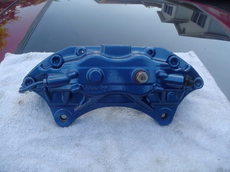

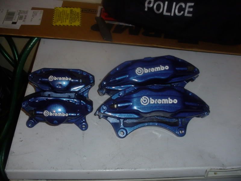

also got one of the front brembos painted. it is a heavy metal flake blue that is close to the cusco blue. The pics dont do it any favors. it was sanded down with some 400. 1 layer of primer,3 coats of blue,hi temp brembo sticker,3 coats of clear
http://i122.photobucket.com/albums/o...o/DSC04381.jpg
http://i122.photobucket.com/albums/o...o/DSC04382.jpg
http://i122.photobucket.com/albums/o...o/DSC04383.jpg

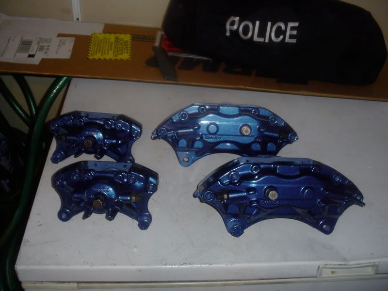

got all of the brembos painted now
http://i122.photobucket.com/albums/o...o/DSC04384.jpg
http://i122.photobucket.com/albums/o...o/DSC04385.jpg

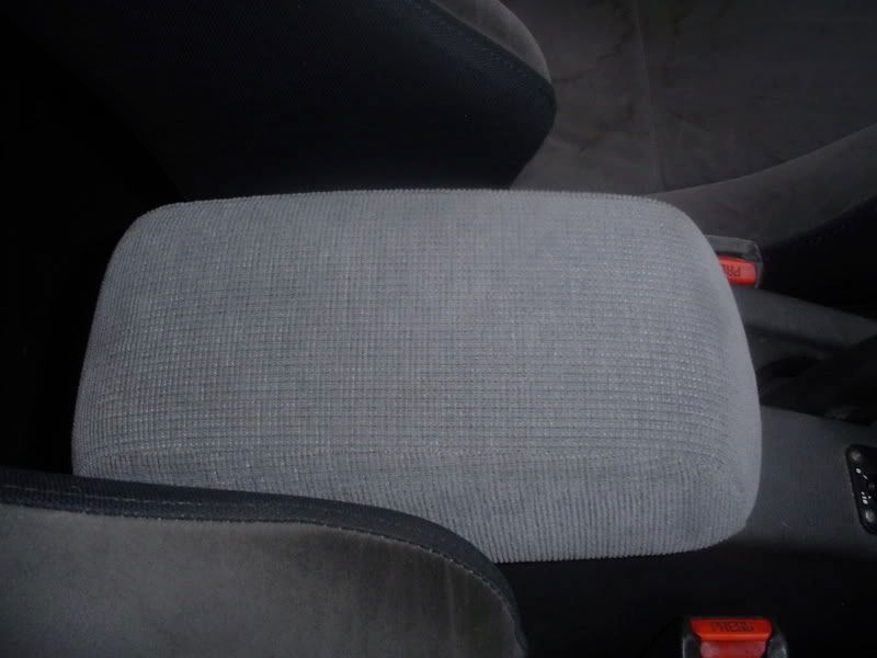

also went to the junk yard today and they had a 5g mirage so I snaged the arm rest out of it. No more crappy plastic one for the car anymore. To top it all off it was dirty as hell and was 2.00 because of that, nothing a carpet cleaner could not fix
