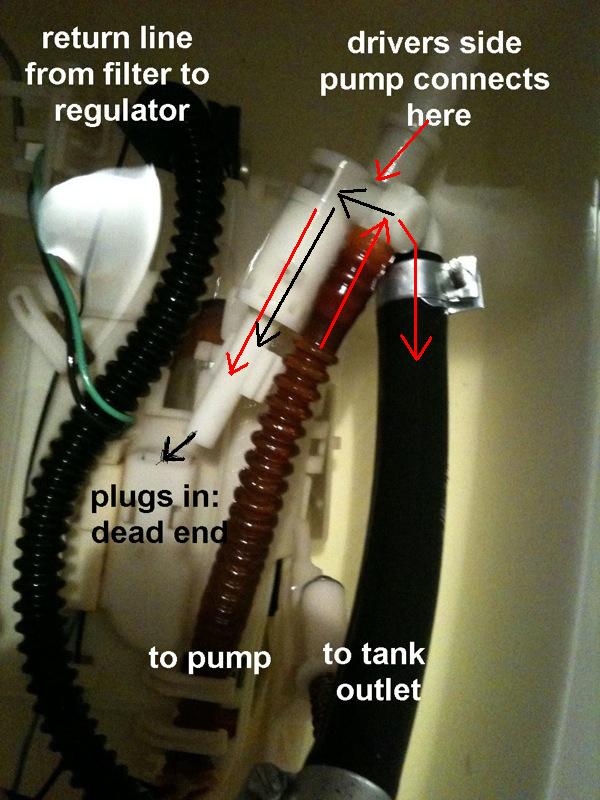

asshanson 09-24-2010 01:28 AM
Re: My 2005 CTS-V
1 Attachment(s)
I finally figured out the fuel issue. I disconnected the fuel feed line and turned the pump on for 60 seconds, and I got 1/3 gallon of gas. I tried directly out of the tank and I got the same result, so nothing in the lines/filter is restricting flow. Then I took out the pump and tested the stocker, 255, and 310 pumps I had sitting around, direct hookup to the battery. The stock pump and 310 were each able to do about a gallon in 60 seconds, and the 255 was able to do more than a gallon in 50 seconds, so clearly the 255 pump is more than capable of providing the fuel required.
I put the pump back in the assembly and dropped it into my bucket of fuel to test that out, and I found where all the fuel is going: out some stupid valve I don't think should even exist.
You can see the red line connects to the pump and the mystery white plastic item. That valve thing also connects to the hose that goes outside the tank, the connection from the other pump on the opposite side of the tank (yes, there is an active pump that feeds fuel from the drivers side to the passenger side of the hump), and a plastic tube that plugs into a dead end. I really dont know what it's for. Anyway, about 2/3 of the fuel is spraying out that stupid plastic piece and not going out of the tank.
Anybody familiar enough with returnless or GM fuel systems to know what that thing is? I'm considering bypassing it and hooking the pump directly out of the tank, and having the other pump just feed the bucket the primary pump sits in. I think it's supposed to be some merger valve that combines fuel from the other pump along with the main pump, but I think it may have broken and it's just bleeding off most of the fuel.
EDIT: I added arrows to the flow. I think red arrows should be the expected flow of fuel, but the black arrows are the actual flow. I'm thinking a seal or something inside the siphon has broken.
http://mitsustyle.com/forums/attachm...chmentid=10699
A//// Guy 09-24-2010 09:25 AM
Re: My 2005 CTS-V
I guess I dont understand what that white tube is for, was it not plugged into that connection?
Also you probably should have worn gloves...
asshanson 09-24-2010 10:33 AM
Re: My 2005 CTS-V
My point exactly, what is that stupid tube for? It was plugged into that dead end hole, but I took it out for picture purposes, and to verify that's where all the fuel from the pump was shooting out of. I'm going to take it off completely and take it into GM and see if they can tell me what it's for or how it's supposed to operate. I'm pretty sure it's broken.
asshanson 09-24-2010 05:25 PM
Re: My 2005 CTS-V
Ok so I have confirmed the white plastic thingy is the siphon from the other side of the tank, but I don't think fuel from the feed line is supposed to go out where the black lines are pointing. So I removed that piece (temporarily for testing purposes) and hooked the pump straight to the tank output. I verified I'm getting full flow now at the rail, over a gallon a minute with just 12v when the car was off. But now the car can't even hold 60psi at idle like it was before, I have no idea what is going on. Maybe there is a leak in the lines inside the tank at higher PSI, that's the only explanation I can think of, but I'm still stumped why it's even lower pressure with the pump going straight out the tank.
asshanson 09-28-2010 09:43 PM
Re: My 2005 CTS-V
The tank outlet o-ring was sideways, fixed that and pressure is crazy good. It overruns the regulator at idle to 75psi, but under load it hops back down to 60 where it should be. Man this car rips, first time I did a full WOT pull to redline after my mods.
