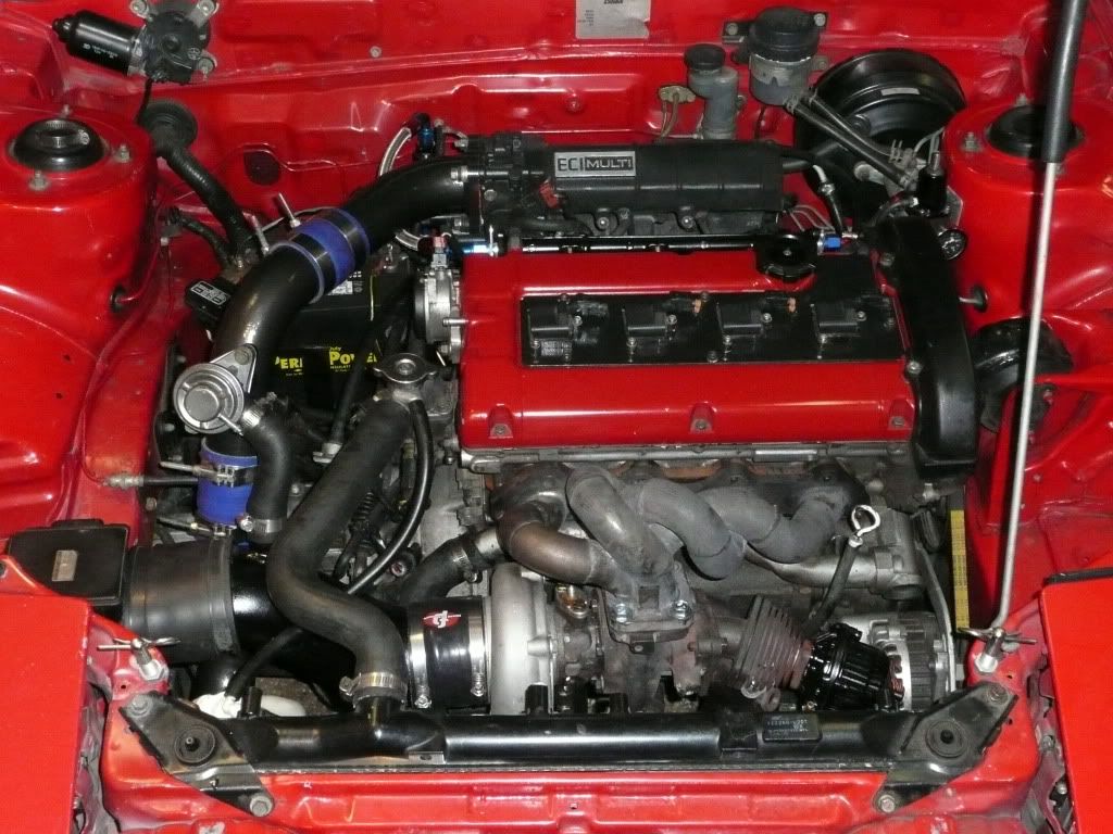

Eventually I got sick of looking at 2 random blue couplers and went to napa and got some black ones for now. Eventually I'll probably get some real red ones.
http://i224.photobucket.com/albums/d...0/P1020931.jpg

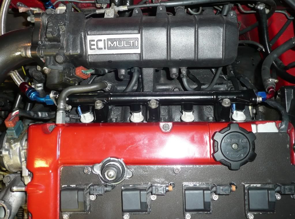

I woke up this morning to 2 packages at my door. First being my FIC 1600's.
http://i224.photobucket.com/albums/d...0/P1020942.jpg
Installed
http://i224.photobucket.com/albums/d...0/P1020948.jpg

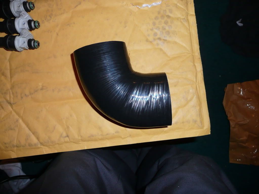

Second was my 2.5" 90 degree coupler to replace the nasty elbow that was welded on my turbo.
http://i224.photobucket.com/albums/d...0/P1020811.jpg
http://i224.photobucket.com/albums/d...0/P1020944.jpg
Then decided to mock up the LICP. It came up about an inch short, so I cut it and used a coupler to give me some more length. (Not ideal, but it works.)
http://i224.photobucket.com/albums/d...0/P1020952.jpg
