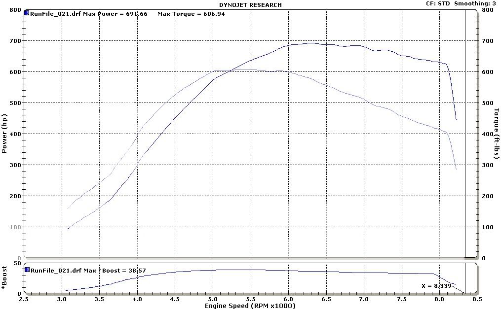

Originally Posted by Mike@AwdMotorsports (Post 7966637)
It was a long day of dialing in the car today to get the car where its at right now.. Playing with Fueling issues, Ignition Problems etc.. All problems we knew we may run into by trying to get away with inferior parts on the Bastard Evo.. At the end of the day we are needing to add more and more proven parts to reach our goals.. Today we added the Buschur COP Ignition to help us get from 630hp to 691whp.. The car would not handle the E85 & Boost we needed to make the power.. Next up is Track Times.. We have our sights set on 9.5 or Better and 144+ MPH!!!!
I have to thank everyone who helped out today.. Anthony for putting together the car on his free time and then keeping it running while testing.. Diiirk for the tuning all day and night.. Crispeed for all the sh1t we cant figure out and the wastegate actuator mods!!! LOL
Mike
4g64 Engine w/ Evo IX head.. Buschur Spec Internals
Cosworth m2 Cams
FP Black AWD Ported w/ Crispeed Modified Wastegate :D
Buschur Double Pumper w/ 1200cc Injectors
E85 pump Fuel
Buschur Ported Intake Manifold & TB
Buschur Ported Exhaust Manifold
Buschur COp Ignition
Invidia 02 Dump
DC Sports Downpipe / Test Pipe
AWD Mini Battery Kit
AWD UICP & LICP
Stock fuel Rail
Stock Ecu w/ MAF Tuned By: Diiirk

Sick yo. That looks like a 35r dyno graph.

Wow. For a bolt on turbo it holds boost really well.
