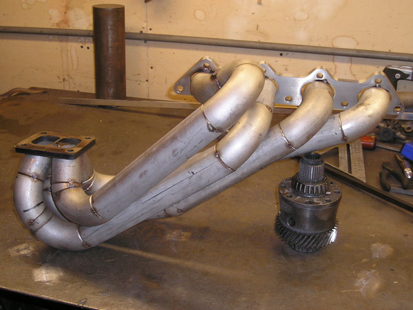

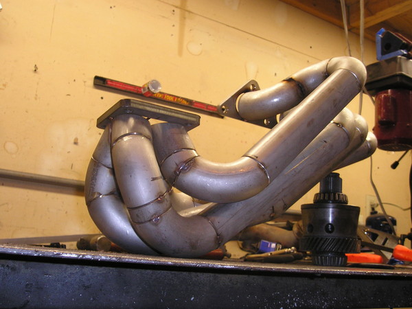

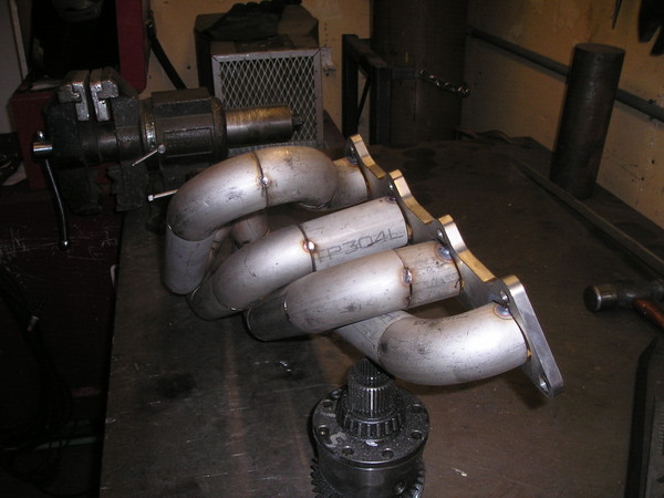

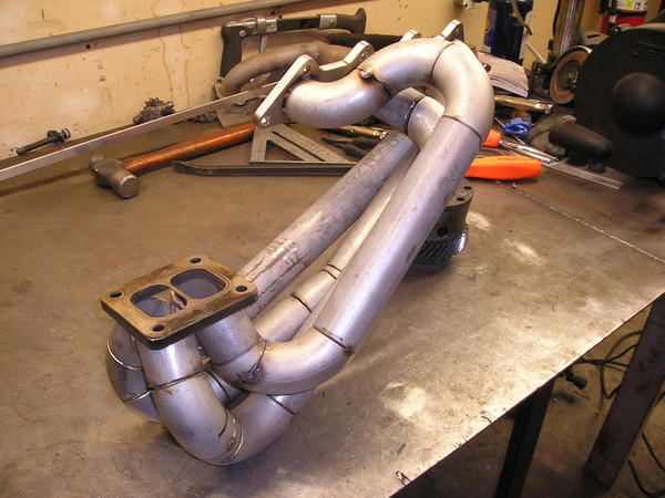

Pushit2.0 10-02-2009 02:59 AM
Re: 91 Galant VR4
http://www.mitsustyle.com/photopost/...m/P1010085.JPG
The exhaust manifold broken down to the runners for finish welding.

blackrosenova400 10-15-2009 01:36 AM
Re: 91 Galant VR4
Lol nice exhaust manifold stand! I can tell you have the spiders out from it!
Originally Posted by Pushit2.0 (Post 303314)
http://www.mitsustyle.com/photopost/...icture_096.jpg
http://www.mitsustyle.com/photopost/...icture_097.jpg
http://www.mitsustyle.com/photopost/...icture_098.jpg
http://www.mitsustyle.com/photopost/...icture_103.jpg
Now I just need a waste gate and mount it to the manifold, a little final fit and finish, then finish weld. The runners are equal length for the #'s 1/4 and #'s 2/3 and will be divided all the way up to the waste gate valve seat. The turbo should be in the same spot as before, now I will just need to fab up the sheet metal end tank for the water to air and make a new down pipe.
~John
