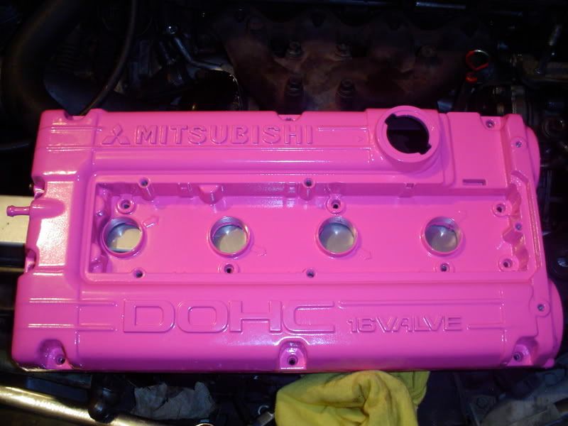

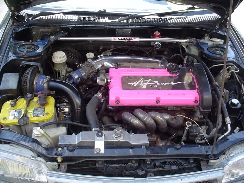

thanks to brandon for redoing the hot pink valve cover is looks great
http://i122.photobucket.com/albums/o...o/DSC04172.jpg

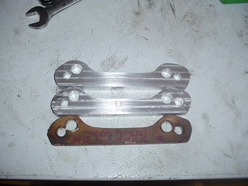

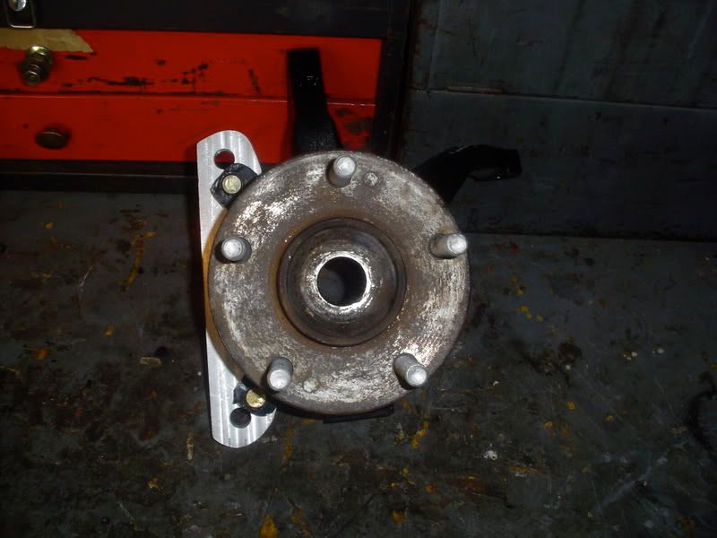

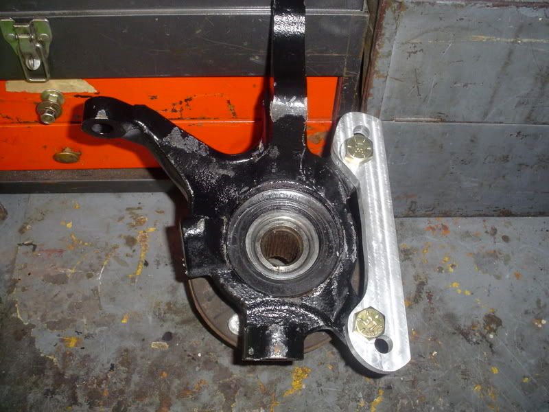

also a big thanks to rosie for doing the brembo brackets
http://i122.photobucket.com/albums/o...o/DSC04171.jpg
TkrPerformance 07-15-2008 05:32 PM
Re: the evo 3 swap parts are coming
got the v.c. back on the car and looks great
http://i122.photobucket.com/albums/o...o/DSC04184.jpg

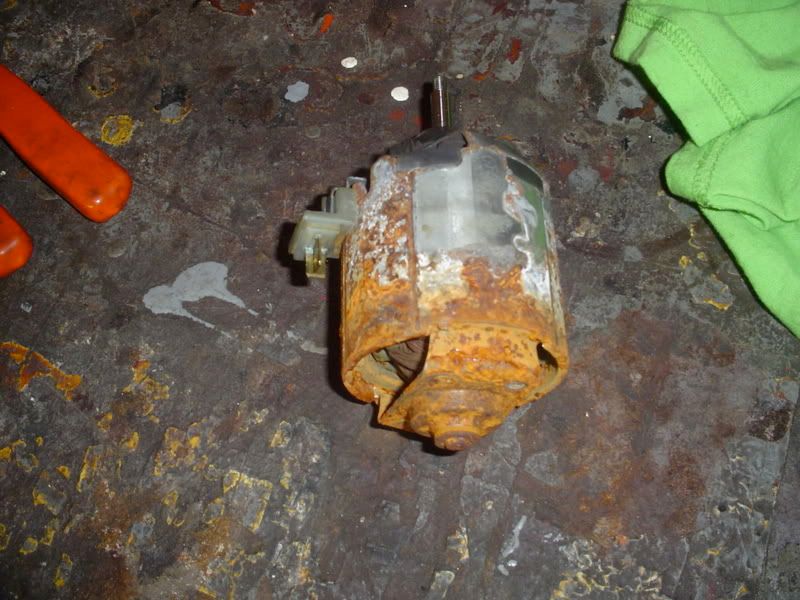

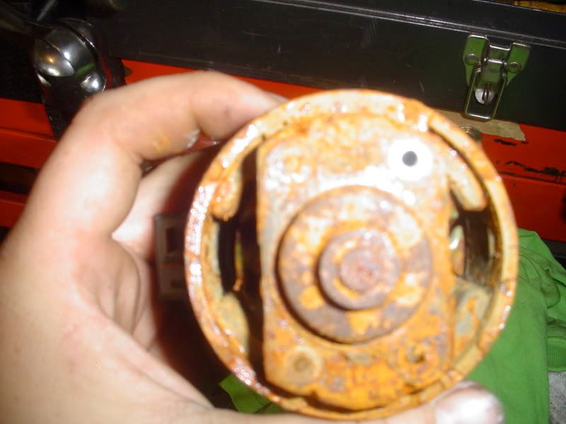

also got the replacement climate controler yesterday from the UK and put it in and it works great
and here is why the first one went out. the fan motor was rusted probley from sitting as a front clip for a while got wet and rusted. It froze up and back feed the power back to the controler and burnt it out.
http://i122.photobucket.com/albums/o...o/DSC04365.jpg
http://i122.photobucket.com/albums/o...o/DSC04366.jpg

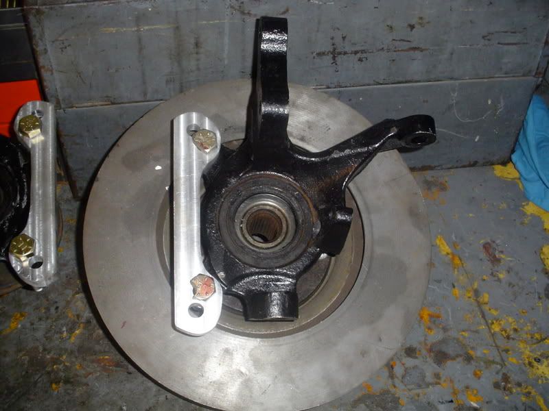

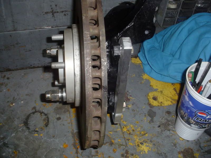

also got the new bearings and seals for the evo knuckels they came from craigs 1g. also got the brackets on. I am just waiting for the alen heads to show up to replace the bolts. also cleaned up the knuckles and painted them gloss black
http://i122.photobucket.com/albums/o...o/DSC04360.jpg
http://i122.photobucket.com/albums/o...o/DSC04361.jpg
http://i122.photobucket.com/albums/o...o/DSC04362.jpg
http://i122.photobucket.com/albums/o...o/DSC04363.jpg
http://i122.photobucket.com/albums/o...o/DSC04364.jpg
