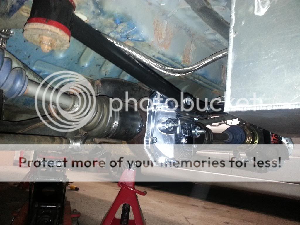

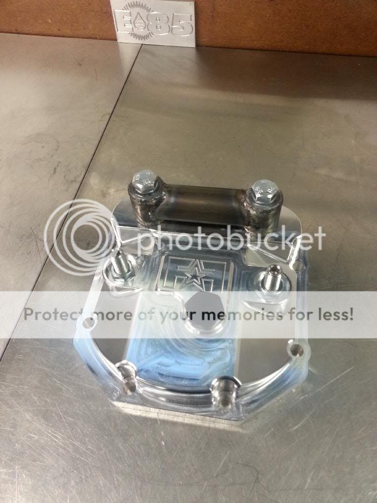

I purchased one of those frontline fab rear end covers at the end of September and just received it earlier this month. I got a little advice from Mondale on how to install it, thanks.
I also took the opportunity to take a touch of weigh out of it. The cover was a little heaver than the stock so I tubed up the rear brace to turn it into a net loss of weight. I used 1.25" 4130 .096 wall.
I have a couple of little projects and I will be ready for the season. I need to wire up the launch solenoid, send my injectors out to FIC for clean/balancing, drop the oil pan to take a peak at bearings, and get my turbo back from PTE(It was starting to leak oil into the exhaust housing).
